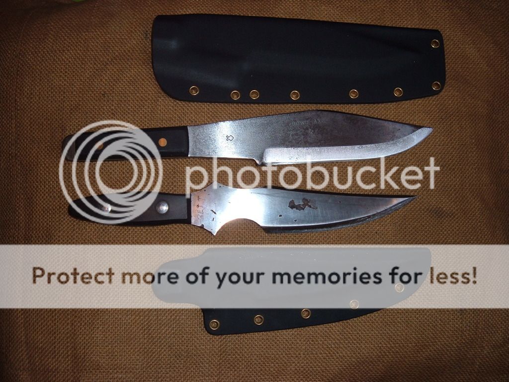

Here are a couple of my favorite "dual purpose" throwers!
