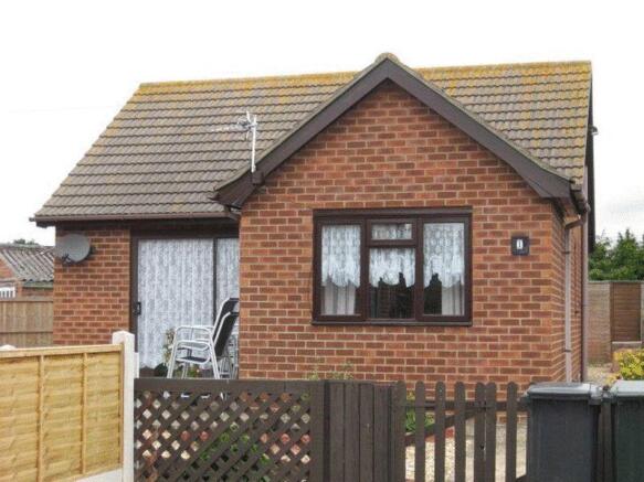

  9. gadunz
    gadunz
    Dec 4, 2012
    British.
    [​IMG]
    Good luck bladesmithing without a forge
