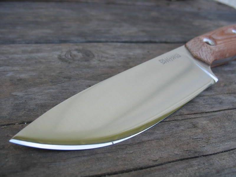

check out the wicked sharp convex edge on this beauty, i just picked... it was made by Ban Tang..:D

Mike, this convex edge is SHARP!!!! It would be so easy to maintain too!

That is nice Mike. Yea Ban has the convex thing figured out. He and only a few others put the "appleseed" on them the rest put a secondary grind on them for some reason. I prefer the appleseed myself.
