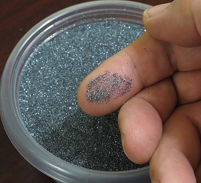

Got a small pack of the grit here in Tampa, gave up on the other site
they finally responded but just cancelled and got a 1 pound bag here.
Used it today and it worked great, cleaned the stone nice and now cuts
very well again, no more glaze surface.
Used a small flat plate of glass, sprinkled a very small amount and then
sprinkled a little bit of water and rubbed in a circular motion, wax on wax off kind of deal ;)
I haven't found any of the Nagura, but that seems to be another way too...
G2

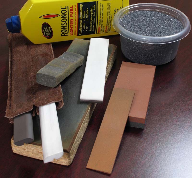

Here's my travel kit for sharpening, works pretty well;
Set of Spyderco Profiles, Spyderco DoubleStuff, Rust Eraser for cleaning the ceramics
Leather strop, a small fine india and a combo stone with a fine india and a coarse section
and a pound of Silicon Carbide grit for resurfacing the stones and lighter fluid for cleaning
the stones. I've stopped the oil mess and no looking back!
got this plastic tub from Wallmart, it JUST holds the 1 pound of the Silicon Carbide grit
it's varying sized but works well, just use a piece of glass and a little water and you're in business ;)
Good to have when you can't bring your regular stones with ya :)
