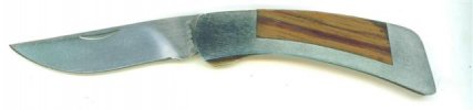

Every now and and then I get a knife sent to me that takes me back. A blast from the past like this neat little PK (Pete's Knife) Gerber original work hardened brass liner locking slip joint is always a joy to see for me. I love these knives, and every now and then I pull out the mint condition ones I own from the same 70s era. I really love to admire these since they are historical pieces to me from when Gerber was still solely a USA owned company before the days of Fiskars involvement with them.
Anyway, the complaint was, as written by the owner of the knife, "I just got this knife on ebay. The lock is not working right and lets the blade close rather than stop it, I was going to return it but it was as is." I got another Kabar and had some issues with it too. Someone over at Kabar told me about you. Can you fix this one also?" There was a bit more but that is the relevant part.
He sent me $20 and the note. Now take a look at the lock in the first picture. It doesn't engage, and no amount of snapping the blade open helps to correct that as reported.
Note the second picture of the lock after fixing the problem. It now snaps out as it did new.
Problem?? Pocket lint built up where the back spring and blade meet. Cure?? A simple dental explorer and small screw driver like used in your glasses to tighten the screws. Use one or both to remove the pocket lint and the lock is fixed. Total time about 5 seconds.
You can do this at home folks! But you can send it to me with some cash too if you just want to! By the way, pocket lint can and does block lockback designed folders from working properly too. I actually see and get calls for that more than this type. This one is such a classic it was worth posting about just for the rare view of the knife though.
