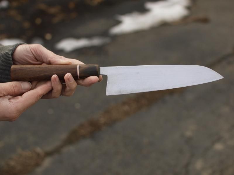

Thinner than I think most people would care for, had to make a hollow in the handle to keep it balanced.
Forged Cruforge, cocobolo, madagascar ebony, and copper.
I'm a laser lover . ~1.5mm above the heel and tapered down. I don't think I'd try this with many other steels...

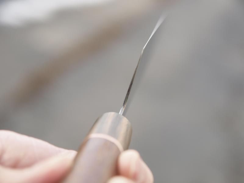

Here's a shot from before the bevels were set,( It looks a little bent, just had the wrong lens on)
