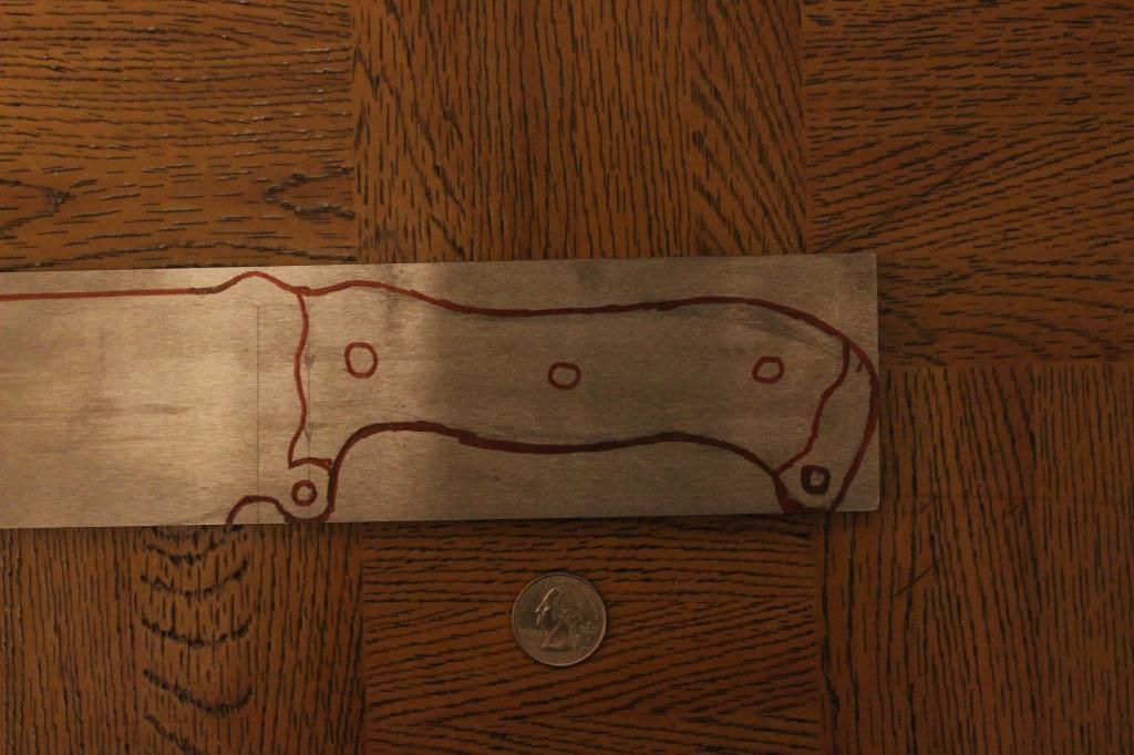

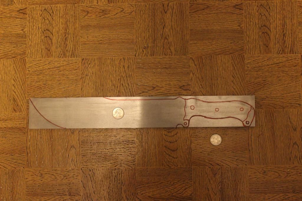

After much deliberation and drawing on paper, this is the result I have on steel. I know I need to touch up corners and round edges with my red sharpie. I may add another lanyard hole near the top of the ricasso which looks like a rhino lump at the moment. It isn't perfect yet but I like the look. Let me know what you think. Also can anyone guess where I got the handle design? Hint: it is one of my favorite knives. Too easy isn't it?
This will be my first knife ever designed and cut. Keep in mind it will be a fire wood chopping work horse. The steel is O1. I am up in the air about end hardness (suggestions? I may shoot for 58). The blade length is 11 and 3/4" to the choil, the total length is 18". The thickness is 3/8" which may come down a bit, not sure, I like the weight even uncut. The initial tip to belly curve is 3 inches in length and the swoop down on the spine begins at 6" from the tip of the blade. The scales will be made out of micarta, I am going to use blue, yellow, and red paper. I will be making the scales removable which means I am looking for hardware suggestions (Hex or Allen wrench removable)?
The large belly and flat top to tip kind of give it a "pirate" look in my eyes. I look forward to your comments and all of your help. I am still looking for a grinder and drill press, also a metal band saw. I have angle grinders and dremels.

Maybe put that design on the back burner for now. Since you don't have any of the bigger power tools that is a lot of knife to attempt. Try working on small knives until you build up your shop a bit. If you are set on making that knife I would suggest using a simple rounded line at the front and rear of the handle and get rid of the sway back on the top of the handle. Just use a gentle up swept arc on the top of the handle tying the blade into the handle in a smooth flowing line. Also, maybe add a bit more sweep to the belly. You have a lot of edge to work with. Design the edge to have a graceful sweep. Don't let the bar of steel dictate what it will be or it will look like a bar with rounded edges. You tell it what it will be. See below. The rest looks good. Ambitious project, good luck.
Thank you for the suggestion. I actually like the design you have. I like the longer sweep on the belly. I was also thinking about a very slight re-curve starting about 2-3 inches away from the choil.
I tried to put a flat top on the tine and for some reason it just didn't look right. Your design does. Maybe because I was still leaving in the rhino bump. I will be shopping around for shop equipment before doing any serious work on this. As of right now I plan on using an angle grinder and a dremel to cut out the blank. It will be a while as I am still going to perfect the look of it.
