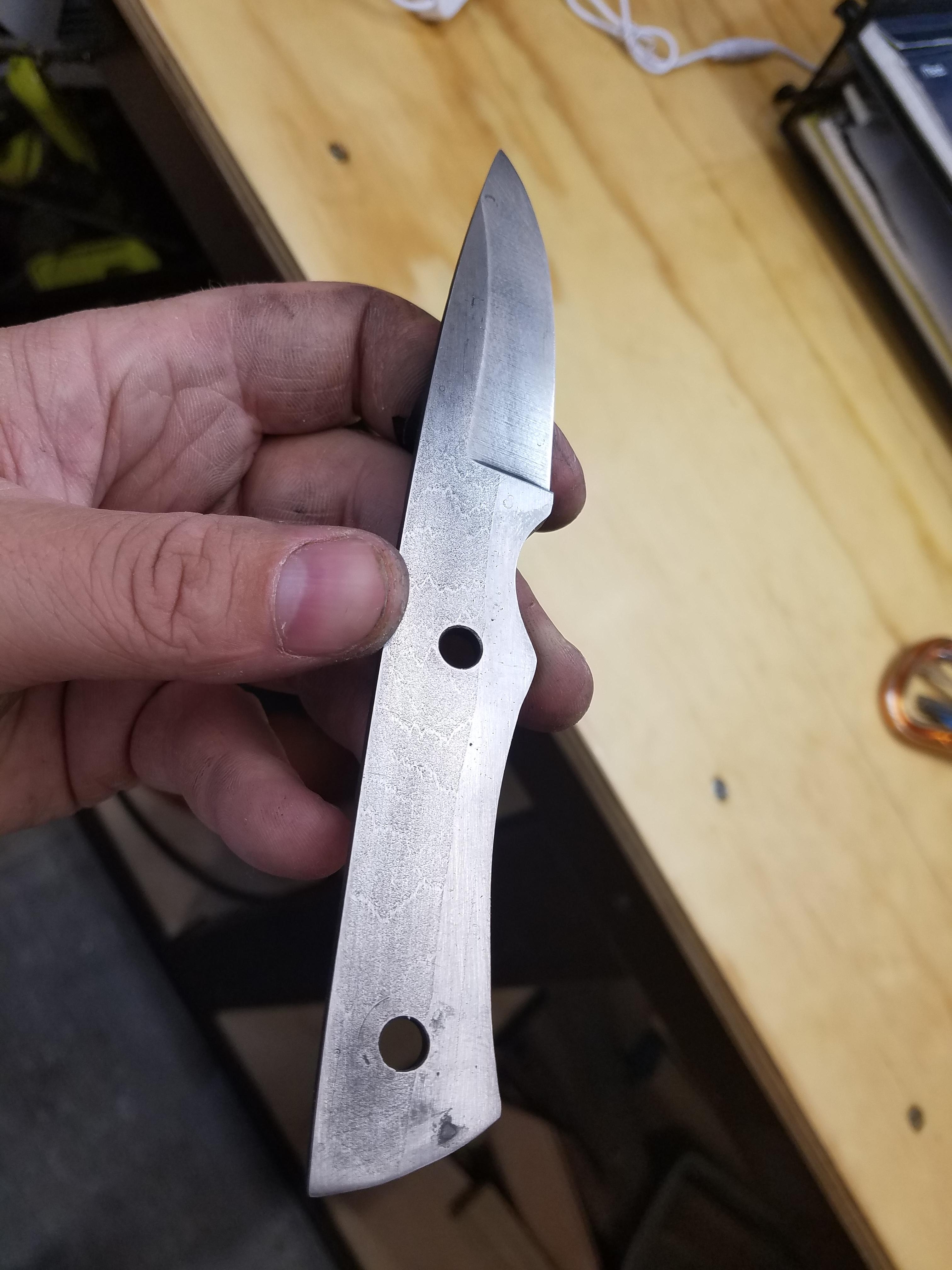

I ran a heat treat and temper on my first knife yesterday. It's 1084 from Aldo. Called there and talked to someone about the heat treat process. Also talked to Ed Braun and Kevin Chasen. I skipped the normalization cycles... oops. Any way, this is how it came out. I banged it around and dropped it on concrete a few times. It didn't shatter and also didn't show signs of wear. I sanded off the scale and this is what it looks like. You can see a couple lines in there that I originally thought were cracks... but they don't continue past the tang and into the bevel.
Should I bother using belts on this knife to finish it up and put a handle on it? Or should I take this new info from Ed and Kevin and consider this knife a lesson to apply to the next one? Thanks.
Looks good finish it. 1084 usually doesn't need to be normalized. It will probably surprise you how well it holds an edge.
I normalize all carbon steel that come from Aldo. My customers that have sent me blades out of 1084 from Aldo seam to like my heat treat. A good thing to remember is just becaus steel gets hard does not mean it heat treated properly or will hold a good edge on a knife.
Yeah, I'm certain that I messed up the process. Now that I have that squared away, my real question was whether or not to finish this knife knowing that the steel itself isn't exactly what it's supposed to be. Like I said... I've banged it around and slammed it on the floor without it breaking. I could have sworn it would due to the lines I saw. I would hate for the first knife that I complete to be a potentially unsafe one.

I'm not saying your knife needs to be re heat treated but is there any reasion you can't redo the heat treat. When I posted above about heat treating I was talking about getting the maximum performance out of your steel. Heat treat is only half the battle the other half is the blade profile and edge geometry. Definitely finish the knife whether you redo the heat treat or not. You are bound to discover other things as you finish this knife that your going to do differently on your next knife. It's a learning process and what's important is that you constantly push yourself to become better.

Looking good so far. I think you need to sand it and get off all the decarb layer. A lot of what you are seeing could be just in the decarb layer. 1084 should finish bright and shiny without those squiggly lines and discoloration. There aren't many shorts cuts in knife making especially in getting a good even finish.

I was trying to figure out if the "cracking" was going to be an issue. Turns out, it was only in the scale. I didn't want to finish a knife that would fall apart during use... which is why I was trying to figure out if I should or not. I've already worked on it quite a bit more. Just waiting on some cactus juice to soak in so I can get a handle going. Apparently walnut takes a lot longer to do than the wood in the videos. That or the Hold Fast system sucks.

The thought of not finishing it was driving me insane. I didn't want to finish a knife that was unsafe regardless. Looks as though all is well. Thanks.
