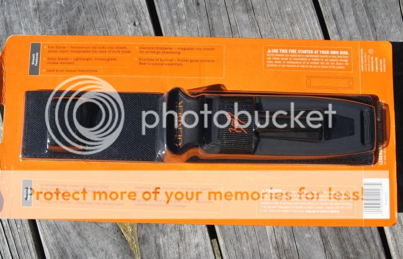

At last it arrived. My new Gerber Bear Grylls knife. Mine cost $59.95 on pre-order, but you can buy them much cheaper now. This is supposed to be a pure survival knife, designed and tested by Bear himself. It came in this clam pack. I can just see dozens of these hanging at Walmart checkout at Christmas time.
The knife came with a sheath that carries a firestarter and has a diamond shapener on the back.

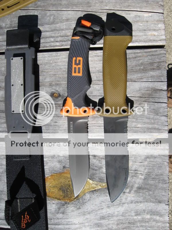

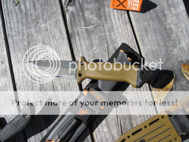

The knife is larger than the original Bear knife by Bayley, but smaller than the Gerber LMF II Survival knife.

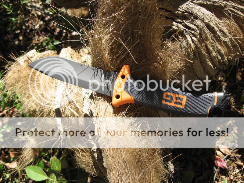

I am not sure why Gerber did this, but the Bear knife is mostly serrated like the LMF II. It can be used to carve and make shavings, but I personally prefer a plain edge.

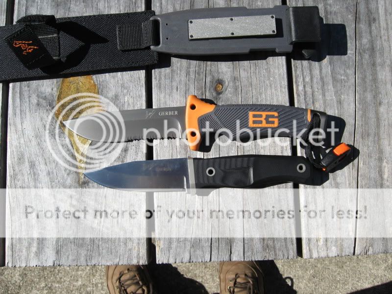

Here is the new knife alongside some other well-known knives of the type and size. I was initially impressed with the checkered hammer pommel. More on this later.
Oh, I forgot to mention it has a little whistle attached to the pommel. It gets even cheezier. The knife fits my hand, and has nice balance. It is lighter than my LMF II, weighing about 8 oz. The blade is "High Carbon Stainless Steel". Best in all China, no doubt. The blade is 4 5/8" long and 3/16" thick. It has a hollow grind. The handle is made from material similar to those plastic Halloween pumpkins they sell at dollar stores with a thin rubber coating for grip. To the bush!

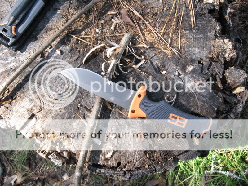

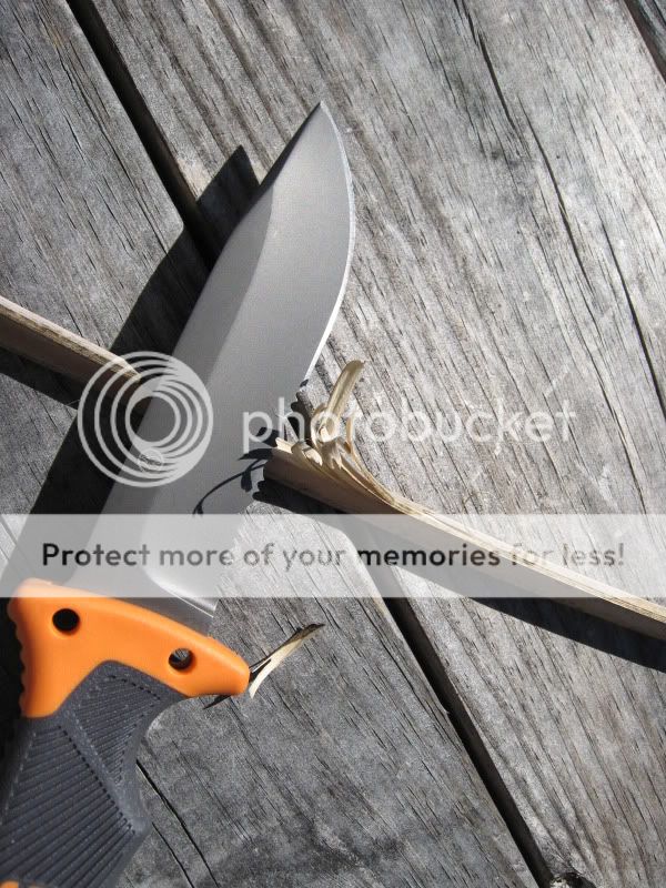

Even with the serrated edge, it is possible to make fuzz sticks, if you have the right wood. This hard dead Bay is not ideal.

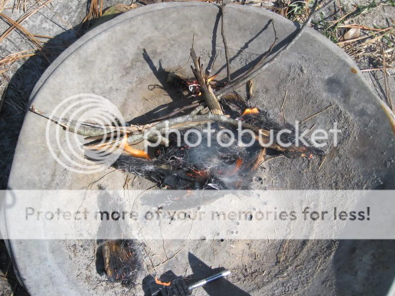

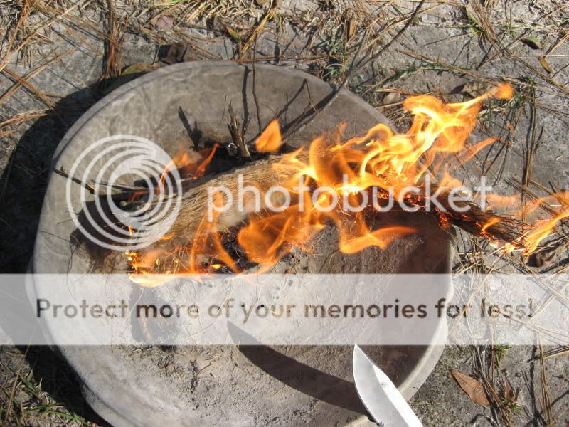

To test the firestarter, I cut some dry palm fibers. I was able to get good enough hot sparks to ignite a fire, but since both of my hands were full, I could not photograph it in action.

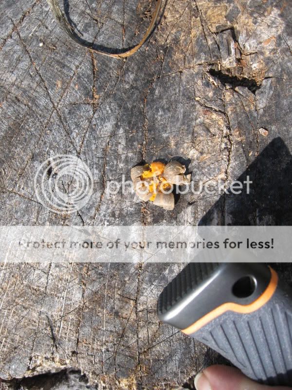

I used the hammer pommel to smash an acorn. No Hickory nuts were around, but that would be a better test. I removed the whistle for this.
Then I batoned the blade through a hard dead branch. The blade did fine, but the shock of all that pounding on the blade cracked the handle and the pommel went flying off into the bush. I still have not found it.
My advice would be to leave the Chinese Bear knife and get the LMF II if you must have a Gerber Survival knife.

Bear supposedly tested this design himself. I have seen him abuse the heck out of various knives on his Man vs Wild show. He had better bring along a sack of these for his next adventure. I have hammered the heck out of my LMF II, and it keeps coming back for more. While it is not my favorite survival knife, I can't fault it. So I know that Gerber can make a good knife. Unfortunately, this ain't it. I only used the pommel once to smash an acorn. I like the feel and balance of the knife, but the sheath looks cheap, and we can see that the plastic handle is not that tough. Just the shock from beating the blade with a baton caused the pommel to fly off.
