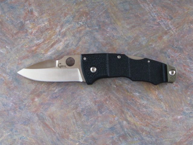

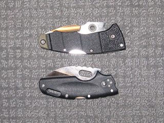

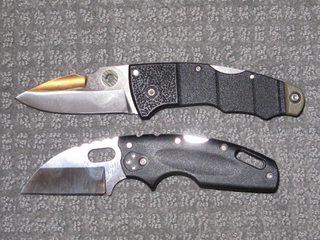

Got my Grik today, and think it will be my new EDC. I went from the Mini Lawman, to the Mini Recon 1, to the Tuff Lite, and now the Grik. Of the 3 previous, the Mini Lawman is probably the perfect size for me, but a bit too "tactical" looking. The Tuff Lite looks much more tool-like, which I liked, but I missed having some curve to the blade. I was thinking of going back to the Mini Lawman and maybe stripping the blade coating, but then saw the Grik in the new products for 2017, and wanted to give it a try.
So far, here's what I like:
1. Non-coated blade.
2. Closed, it is only 1/4" longer than the TuffLite, but open it is 3/4" longer. It also doesn't have as much of a blade "hump" when closed. It is also barely larger than the Mini Lawman...about a 1/4" open
3. The pocket clip is flat and as wide as the handle, so it feels like part of the handle, rather then being in the way.
4. The price...paid $37 including shipping.
What I don't like:

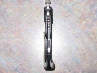

1. The handle wall thickness gets pretty thin near the pommel end. If you look at the side view, each "line" in the handle is a step down in thickness. I'm measuring about 3-4mm thick at the blade end, and only 1mm right in front of where the pocket clip attaches. This basically allows the pocket clip to be "flush". I doubt I would ever do anything with this knife where this "weakness" would come into play, but would have liked it to be a bit thicker.

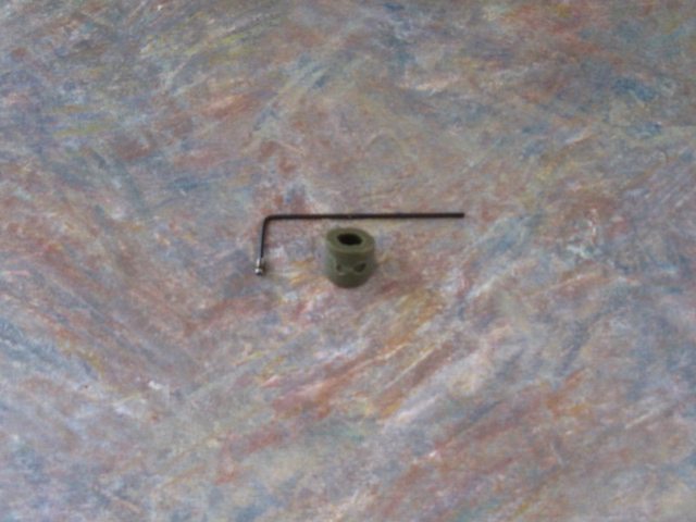

2. The thumb ramp thing is not metal like the other models, which I'm sure was a cost-saving measure. But over time I wonder about wear, and how easy it would be to replace if it were to wear out/break. There is a tiny tiny hex-head screw in the spine of the blade that I'm guessing holds it in place. Smallest hex bit I have is 1.5mm, which is about the size of the hole, so the screw probably needs something like 0.5mm.
3. There is no sharpening notch/choil.
4. The greenish-tan color of the pocket clip...not sure why they did this.
So, overall, I'm really liking it so far. Time will tell...
I didn't even know the Grik was out yet. Thanks for the review and the photos! The size comparisons are most useful. I understand what they were going for with the stepped handle design coinciding with the clip, but is it comfortable in-hand?
-Steve
I still haven't seen them anywhere else, so certainly not widespread yet. So far it seems pretty comfortable. It came with a clip for the other side, and I think you might be able to have them both on, so if the handle is too thin for some, adding the other clip could fill it out a bit more. I will have to try it....
EDIT: I did try adding the other pocket clip and it does fill out the handle nicely, so this could be an option for people with bigger hands

Ended up removing the thumb ramp...liking it much better this way. First I tried rotating the thumb ramp a bit by drilling a new detent for the set screw to fit into, thinking I could get better traction with my thumb to open it easier, but still didn't like it. But the bare hole is large enough (for me) to use, so worked out great.

I used a 0.035" hex...it felt a tad bit loose, but it worked.
Thanks!
The smallest hex I have is 3/64" and that's too big.
I'm guessing it's a 0.9mm hex. I ordered a hex set and I'll post here after it arrives.
But it could be torx. I would need magnification to even see it.
0.9mm is what worked for me on the Kahn. Now I have a 10mm "Spydiehole" that makes for an easier open.
EDIT: It's T2 torx
