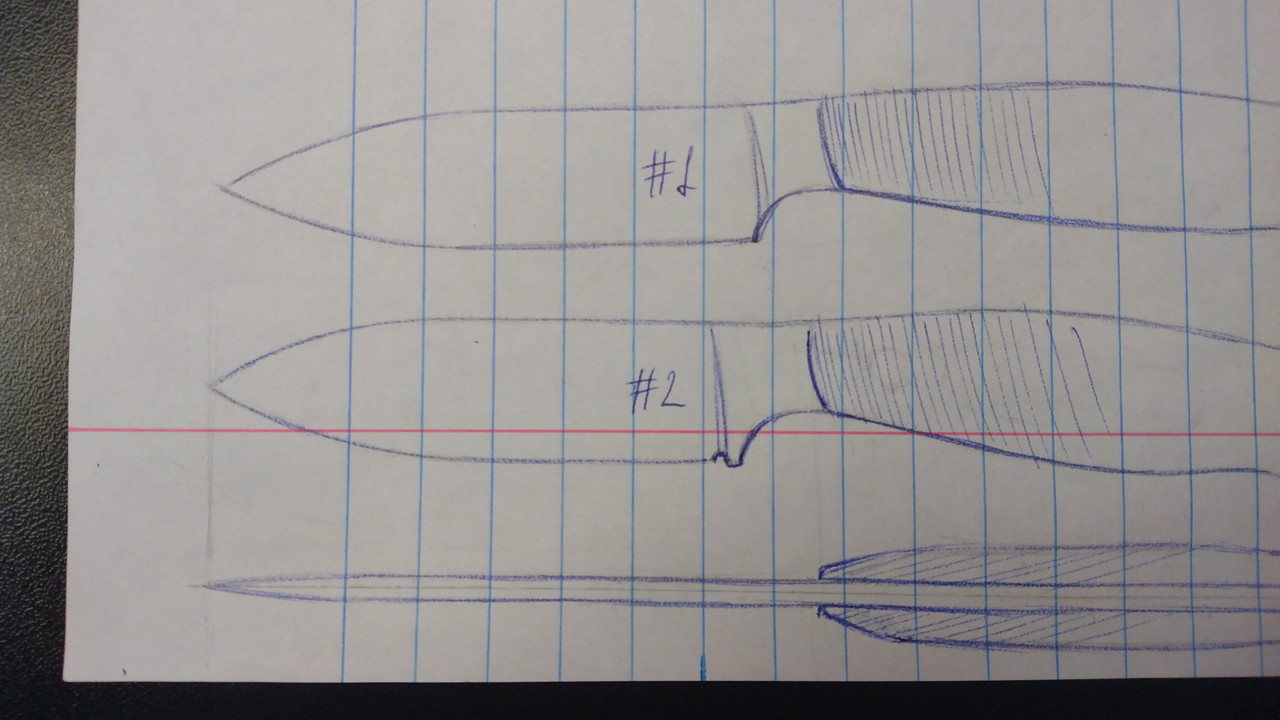

I drew a knife that I am willing will be made, but stuck on this question. Because I don't really understand what is and what is not enough of the shape of the handle or the guard to create tension in the kydex. I don't have an opportunity to make and test it by myself.

Can't tell you without a picture. Handle shape and contour plays a big part.

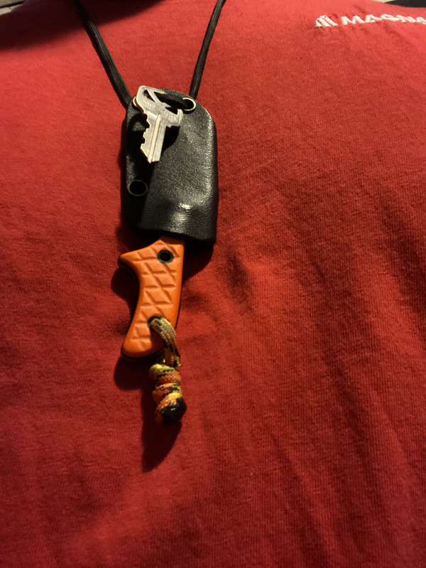

Now the question of blade shape. I know that khukuris, for example, or karambits, are sometimes thought of as difficult to make Kydex sheaths for. And I certainly felt that way for some time. They are still a bit of a pain, but now I have a strategy. Some makers use open backed sheaths, but I have never liked those and don't do them. With the exception of symmetrical, or near symmetrical blades like daggers and some swords, I taco everything, because my philosophy is one of minimalism, in the sense that (usually) the slimmer I can make a sheath profile, the better, whether it's for a neck knife like my Bitty Bitey Baby Birdie,
or a gnarly monstrosity like the Flicker.

The knife goes into the sheath with a satisfying click and good retention, but comes out with ease.
This is just my way, at this time. Others will have other ways. But either way, definitely don't let sheath design deter you from a gnarly knife design, as whatever you can think up, you can also put into some pants and take out for a walk.

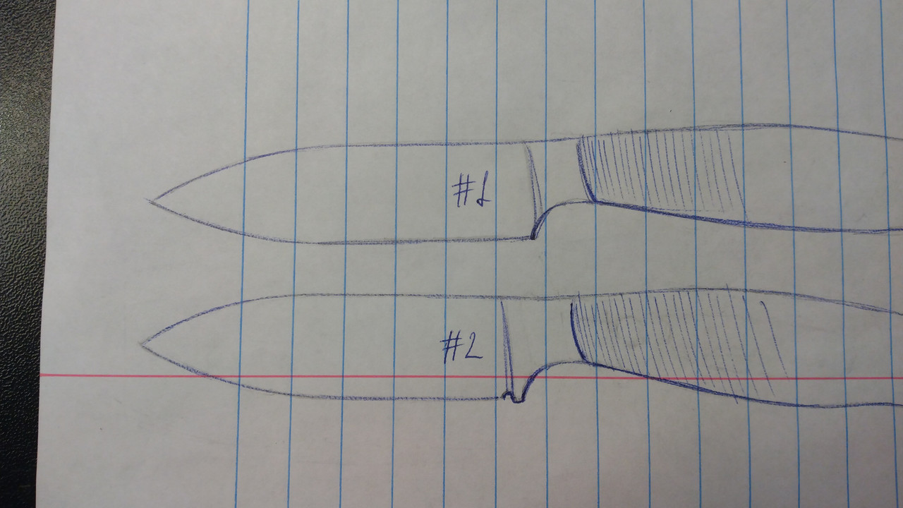

Guys, here are the two versions of the knife. What are your thoughts on these?
Just need to paste the link in now. Tap the image button, select url and then use the “direct link” from postimages
Sorry I see it now.
Top down view please.
And do you think that the finger choil, or ricasso, will make enough retention for a snap? Because I would like the sheath to be before the handle.
I didn't see blade thickness?
Like David said earlier, you can add handle features for more retention. Busse does a lot of flared tubing. with a deep ctsk That can work too.
May I ask if you really need a snap.
I'll occasionally make firm fitting sheaths that slide in nice, tightly. But no snap. Like a puukko shaped handle
It's almost the same profile as my edc ... ;)
I really don’t like sheaths that rely on an exposed guard/ricasso for retention.
