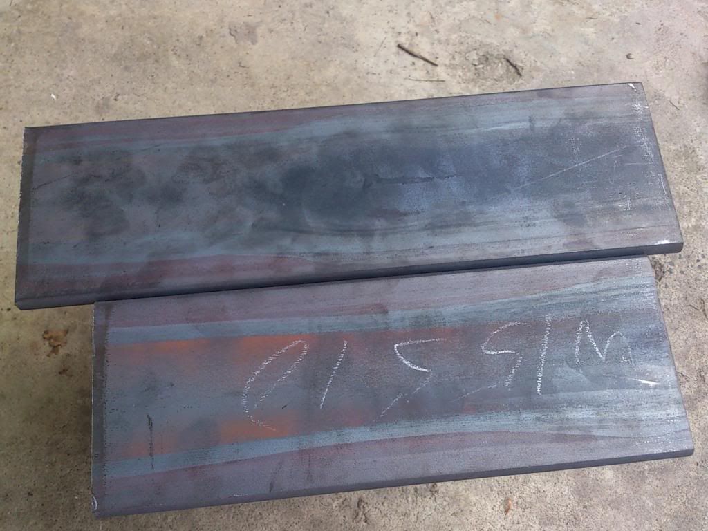

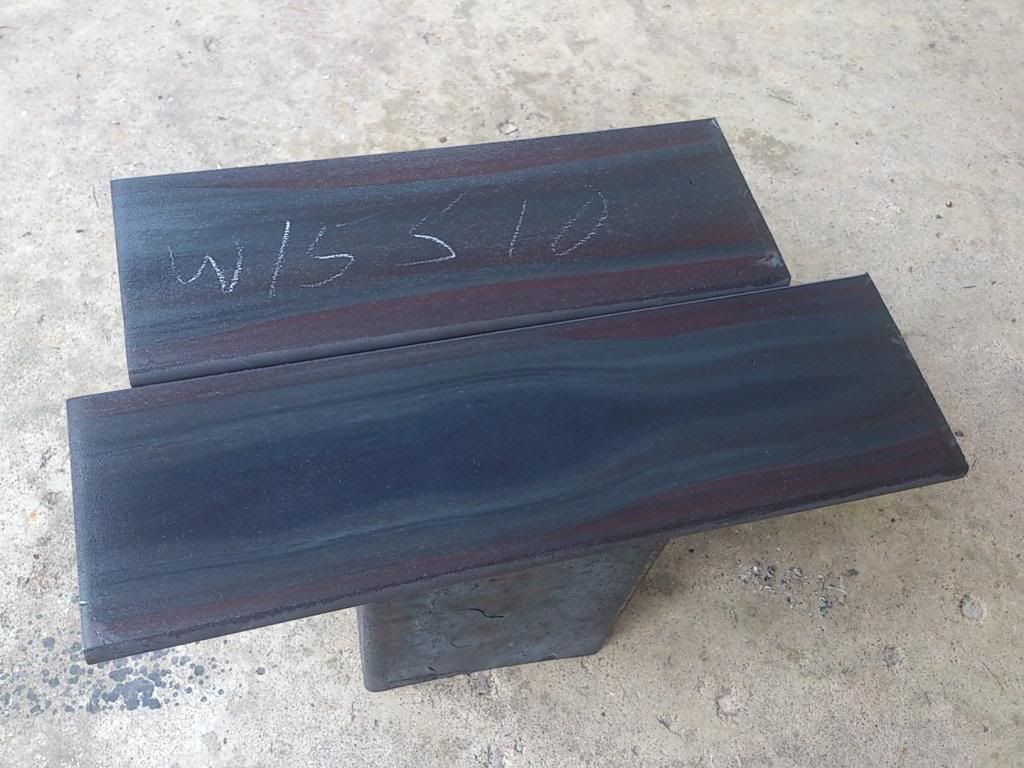

As I walk off the soccer field the other day and much as it has been for my almost 40 years of existence, I see my dad standing apart from the crowd waiting for me. He tells me that he has some steel for me. This is what he gives me.

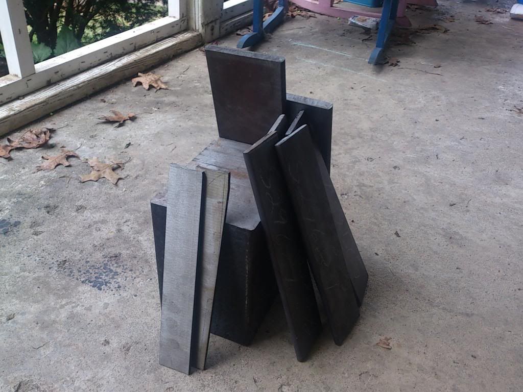

He gave me three thicknesses; a couple 3/16th thick, several .323" thick, and two that are .6 something thick and 4" wide!
http://i1286.photobucket.com/albums/a603/bradosburn/DSC_0233_zps17f78536.jpg
Check out the colors on the big pieces.
Then I wiped them down with a little light oil. If I had enough they would make good baseboards.

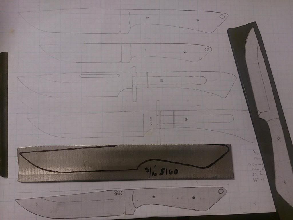

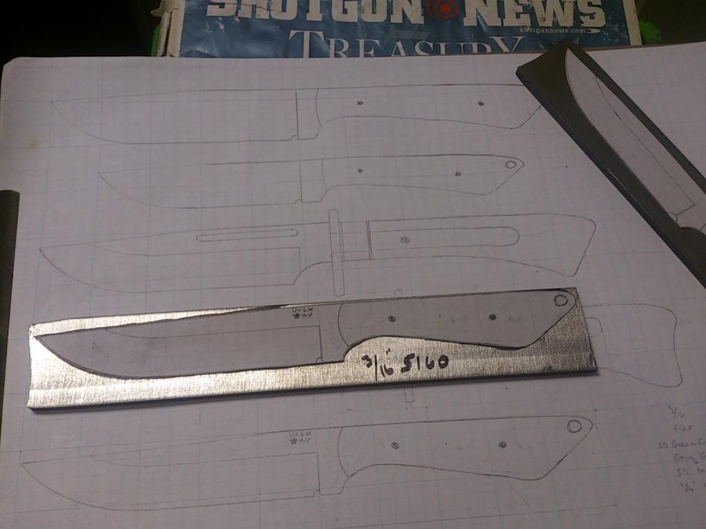

So what am I going to do with it? Well the pieces that have been prepared already are easy, have know what my next couple projects were going to be for a while now. One will be this full tang "emu and muskie" / camp knife. About 10" overall, 3/16th 5160. I don't have the ability to do a hollow grind like it probably deserves (looks wise especially with this kinda thick material for the application) but instead will look to achieve a convex bevel with plenty of distal taper. What do you think? Do any of the experienced makers see any areas that I am setting myself up for trouble? Anybody like or don't like? Mini-cobray bolts or pins are only eyeballed in the sketch as well as placement of the lanyard tube if it gets one.

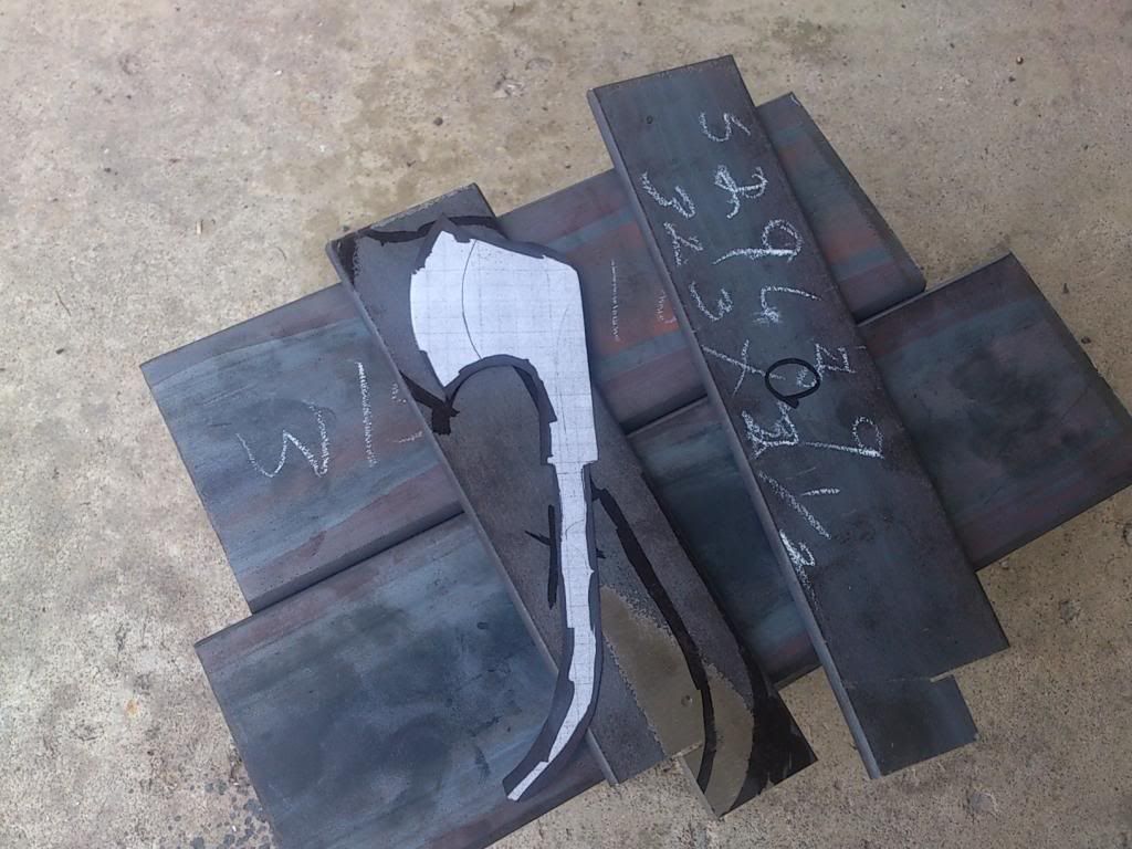

And what else would I be going to do with the thick stuff but making integral/full tang hatchets. I am not to a point of being able to forge yet and it's just waiting to be made into a chopping utensil. This is the smallest piece of .323" thick by 2.5" wide and it will make a little stacked leather handle belt hatchet or caping axe.

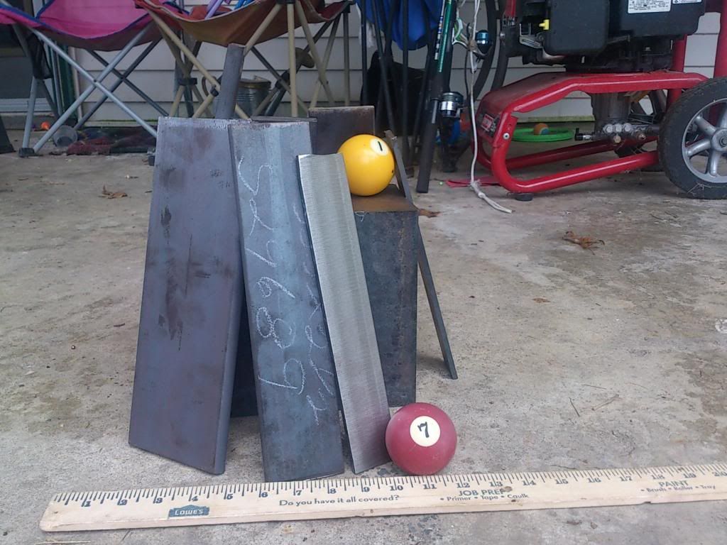

My dad helps manage a materials testing lab and they do metallurgical testing of steel from local mills. These were what were left from the samples. The big block is not 5160, it is 1018 and weighs about 80lbs. I have been researching how to make an anvil from it though. I have several pieces like that set back and was thinking about welding them together to make an anvil. My big question concerning this is should I use a big piece of 5160 for the surface or is there a better solution? I assume that the 1018 alone would not be hard enough to pound against. The thickest samples of 5160 I've seen so far have been 1 5/8" thick by 10" wide and about 10"-12" long. That is what the 3/16" blanks were cut from. The thickest that I have is 0.6xx" thick by 4" wide by 13" long. I was told that the mill that makes the 5160 will be producing round stock soon, as big as 3.5" diameter. I see some really cool hiro shuriken in my future. I am not interested in selling it, partly because I am just a registered user. I would be interested in trading some for 1084 1/8"-5/32" thick to start learning HT with. Or some 52100 that thick or slightly thinner. If the person is close enough to work out something in person or I will be attending the Knifemaker's Guild Show in Louisville on the 21st. This stuff is too heavy to ship efficiently.

In the original spirit of the thread, how would you guys go about cutting blanks out if you didn't have a band saw?

Cutting blanks - What tools do you have at your disposal?
I have to say that getting a Harbor Freight portaband and modifying it with a cutting table and a way to clamp it in my vise has made trimming forged blades down to a particular pattern much easier. It was under $100 for it.
Braze weld a piece of 5160 to the top of the big chunk of mild steel. See if you can get that heat treated. There is no way you will heat treat a piece with that mass at home.

I have a couple of options to remove the steel at home; Bench grinder, angle grinder, dremel with cut off wheels, and hacksaw. I have looked at those portaband saws before, and in all honesty it would probably be the most cost effective.

Of the tools you have at hand already, the angle grinder with cutoff wheels is going to be best.

BTW- as per your knife sketch--- I like it a lot! My only criticism is that you have plenty of steel to put a nice, gentle arc/curve to the spine, but you have it drawn with a fairly straight spine/handle like you were trying to fit it onto a narrower bar of steel. Since you have the steel to spread it out more, I'd recommend you do. :)
As far as your anvil block... I would just peen the hell out of it because you will cause some work hardening effect (even on mild steel) and use it like that for now. Adding a hardened (or at least hardenable) face to that is a very big can of worms.
I agree with this, and would add that I think this applies to all of the sketches you've drawn. They look good (better than most posted around here, in fact), but would look better with curves. Good luck with all that steel. If it seems like you'll have regular access to such stock, I would think that would fairly seriously influence the order and priority of your equipment purchase/construction so that you can fully take advantage of it.
That is some awesome feed back Nick and Travis, thanks. Your powers of perceptions are right on. Those sketches are deliberately sized to fit a certain size stock and I think that they could use a little more curvature as well. I'm still working out proportions and honestly my sketches with more curve still look a little awkward. I get the most success putting the bulk of the curve in the hidden tang and handle of bowie types. I can't take credit for the basic shape of the full tang knife, it is heavily influenced by a custom knife that I saved a picture of because I really, really liked it. I've done a search for this maker and can't find anything out about him except that it might be a guy in GA. His makers mark just says McGinnis and the pic is titled Kens M3Camp. It is pictured with a couple 8rd .22LR speed loaders. It took me a long time to get the handle to look correct and now that I have it cut out I know a few tweaks I want to make. A wood mock up would have been good here beyond the paper and foam board ones that I did do. The purpose of this build is to tackle a defined plunge line and work out this handle some. As for the design in general; the blade length can vary from 3" out to 7.5" and still look right so it will be good to practice HT with in the 2 brick forge I am gathering materials to build. Also that is why it fits within 1"-1.25" wide, basic cheap 1084 stock steel size. I still have another piece of this 5160 steel, 3/16th" by 1 5/8" by 10" and am planning to blank out a hidden tang with it. We'll see if we can't take a little more advantage of that 1 5/8th" of steel this time.
Question, in my sketches above of the hidden tang knife, am I allowing enough meat in the top of the handle material above the hidden tang? Also I seem to like about a half inch wide hidden tang, is this enough steel for the tang of the knife? Thanks again for the feed back.
