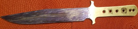

Mitchell Knives Knifemaker Moderator Knifemaker / Craftsman / Service Provider Joined May 21, 2000 Messages 6,172 Jul 23, 2018 #2 Fresh out of heat treat and perfectly straight!
Mitchell Knives Knifemaker Moderator Knifemaker / Craftsman / Service Provider Joined May 21, 2000 Messages 6,172 Jul 23, 2018 #3 Next, I paint the blade with Dykem and layout my grind lines.
Mitchell Knives Knifemaker Moderator Knifemaker / Craftsman / Service Provider Joined May 21, 2000 Messages 6,172 Jul 23, 2018 #4 On to rough grinding. At this point, I don't need perfection. The goal is to remove material and establish the basic geometry and look. I leave the edge thick, and leave a bit of flat between the opposing grinds. I also take some material out of the handle to achieve the balance I want.
