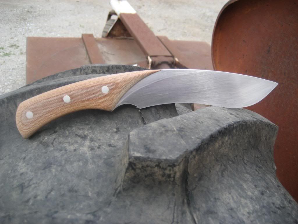

This is the knife we will be doing for them:

Your build, your call, but I would consider a straight edge. Recurved edges can be problematic to sharpen in the field with limited resources at hand, this was something we hashed out on the KD military build.

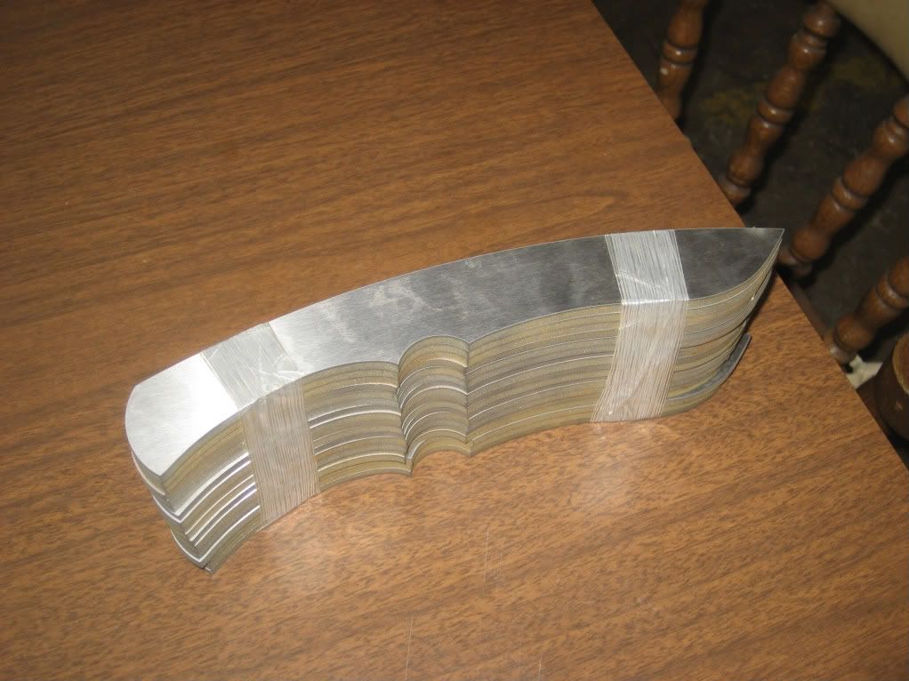

Well, just got the waterjet cutouts in from Mark at Leading Edge (H2Oknife here on bladeforums)
I figured I'd have to do a little pre grinding on the edges before sending them for the blade grind.
No such need. These things far exceeded my expectations. Time to retire my band saw. :D
Thanks again to Mark and to Aldo Buno for supplying the A2.

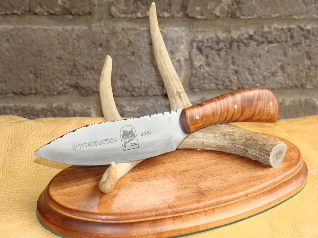

I have access to a laser at work. What kind of etching/lasering do you have in mind? I will see if I can get it done for you.
Here is an example of what I did for an auction knife a few years ago

justin, the recurve should not be a problem to sharpen. i am going to fix up some pads with abrasive belt attached that they can lay out on a flat surface and sharpen the knife easily.
