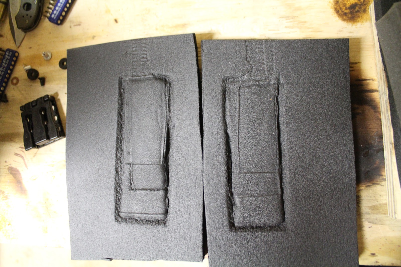

I made several sheaths with some old foam I had lying around, worked spectacularly. After a dozen or so sheaths it was pretty worn out, so I chunked it and ordered some from knifekits. It's a lot firmer, which is great, but when I pull the sheath out after pressing, there's a border eaten into the foam around where the kydex was. I reduced the heat I was warming the kydex in from 350 to 275*, and it does it a little less, but it still happens. Do I need to reduce the heat even more, or is there something else I should be doing?

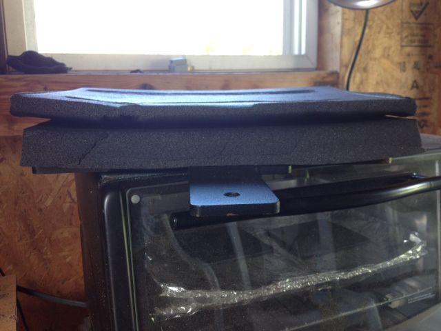

old well used but still functional knifekits foam with a new piece, stuff rocks
@dericdesmond: thanks for the photos. Is that the knifekits CCK press? and do you preheat your foam?

Mine actually break the surface of the foam by a good 3-5mm. Can't exactly tell by your pics, but it looks like the surface isn't broken? I'll try to grab a pic.
That don`t look good at all...never had this happen even on my 1/2" thick foam i was using..
I'm on the fence right now on buying or after watching those vids, making a press.
Yes it is. I am looking to buy a 2nd. Lots of people talk of making there own but for the $100 or a little less I prefer to have an ideal product and be done with it. And no, never heard of preheating foam until you just asked.
YOWZA! How much weight are you putting on top of your press? I go 300 dregrees and stack 3 35lbs hex dumb-bells, maybe a 4th 25lb on top of those if I want an extra tight mold.
Was the kydex rough on the edges before pressing? Was it really limp or distorted when you pressed it? Looks like a rough edges, a lot of pressure or maybe too hot.
I used to bandsaw my kydex before molding and would get something like that but switched to scoring it and bending to cut instead. It is easier and faster that way.

never heard of it either till i stumbled on a gun holster kydex forum alot of gun holster guys do preheat the foam...gives more time to adjust the kydex if necessary i guess also after the pressing they hit the foam with the heat gun and it comes back up a bit..

In any case, is that the shiny side of the foam?
Tried it again today at 250, didn't mess up the foam quite as bad, but it was hardening up as I was getting the blade in there. Maybe I'm using too much pressure (bench vice)?

i am using a bench vice since i started a year and a half ago...i tighten it so hard i can hear the screws geeing ready to pop out never had this...there is something wrong with the foam
in this pic the press is not as tight as i usually have it
