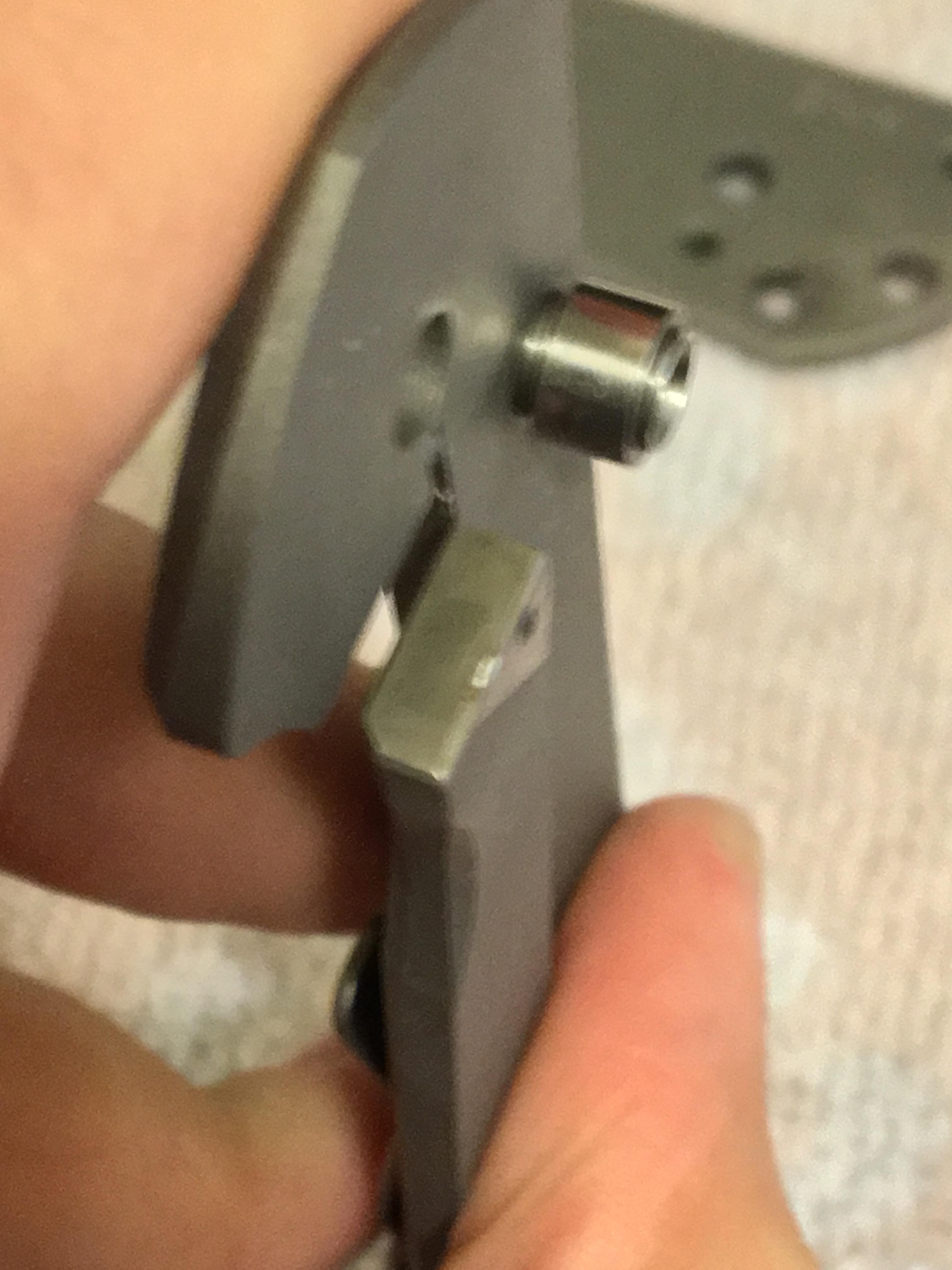

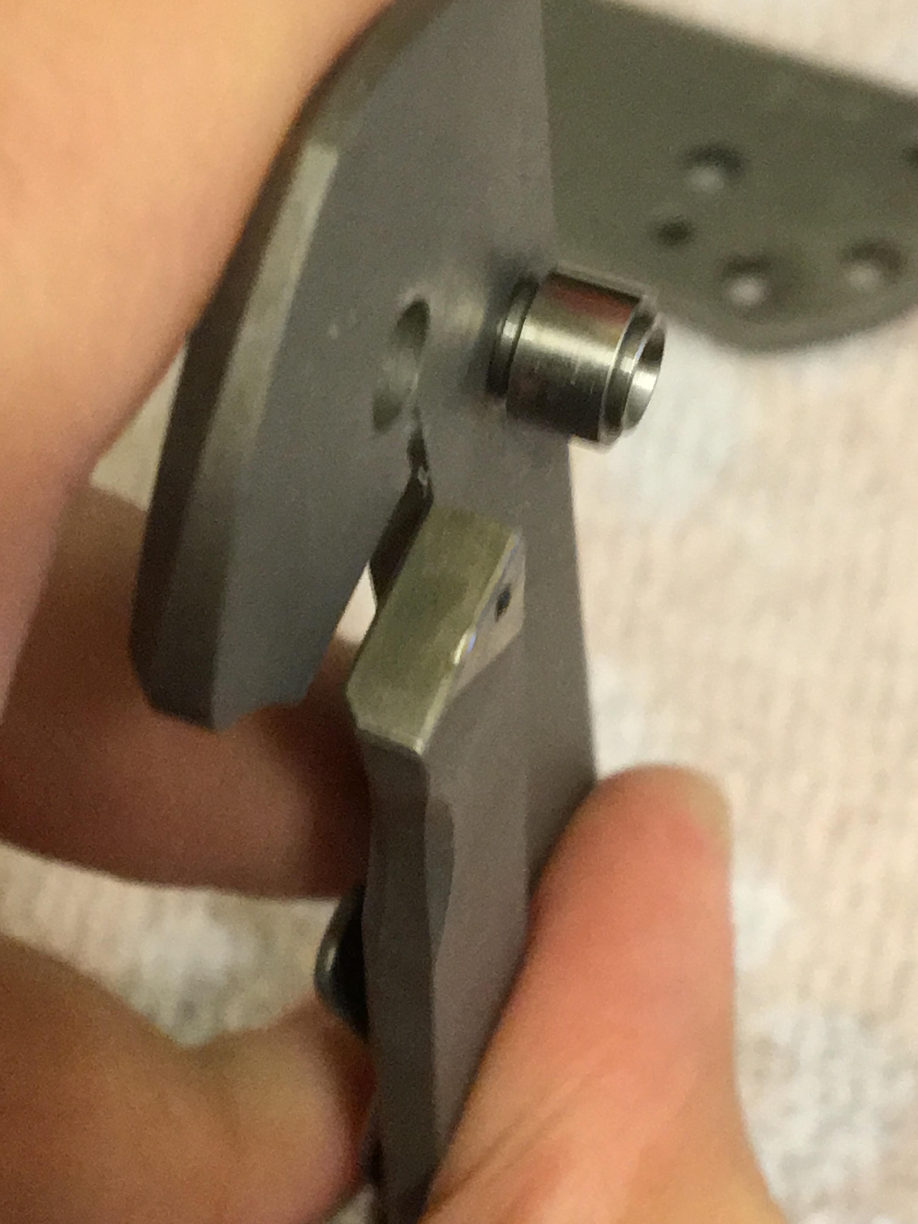

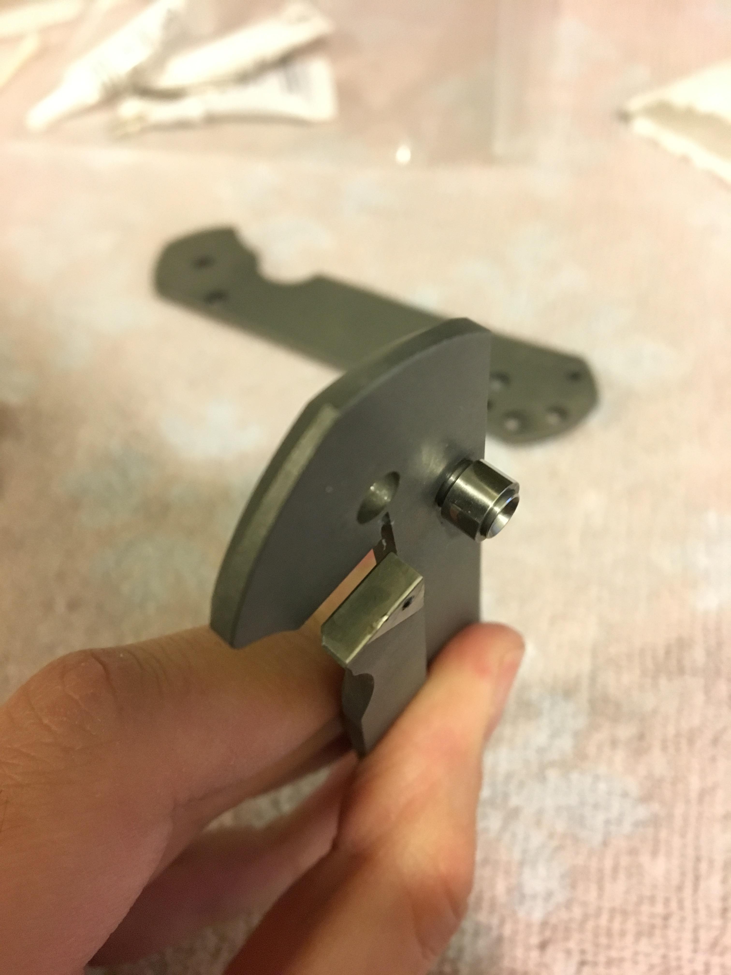

Hey,
I am wondering how many of you guys have experienced lock stick on your large sebenza?
I have tried cleaning the knife and running it dry (no grease), pencil graphite on the blade tang, sharpie on the blade tang, sending it in to CRK (and them telling me it is fine). None of these fully removed the lock stick. The lock stick isn't a lot, but it is there. I do not experience this on my Small Sebenza 21 or my Mnandi. I tried posting this on the maintenance thread but after some time on trying to break it in and all that, i decided to open up a new thread.
I really don't know what to do other than sell it. I really like the Large 21 but I was wondering how widespread of an issue this is or if it just doesn't bother most people. This is making me want to just sell it and buy another one, go for an umnumzaan or a large insingo inkosi instead.

I'm wondering if when you are unlocking the knife you are putting pressure on the back of the blade before the lockbar clears, which make it scrape across the lockbar causing it to bite in a little?
If not, can you take a picture of the lockbar and blade tang faces?
No, no pressure at all. Sometimes there is no stick, but most of the time is just a bit of stick. Though sometimes there is a lot of stick. I don't know what else to do other than just sell it.
I know lock stick is annoying but you can also live with it. You said it's just a little, right? Does it affect your ability to disengage the lock? If it doesn't that's why CRK probably said it's fine. If it takes effort to disengage the lock then take it up with CRK again because that isn't how the knife is supposed to function. The knife doesn't sound broken or unusable so I don't think you HAVE to sell it, but you shouldn't have these issues with the inkosi or Unnumzaan that you are considering. Just please disclose this to the next buyer so they know what they are getting.
