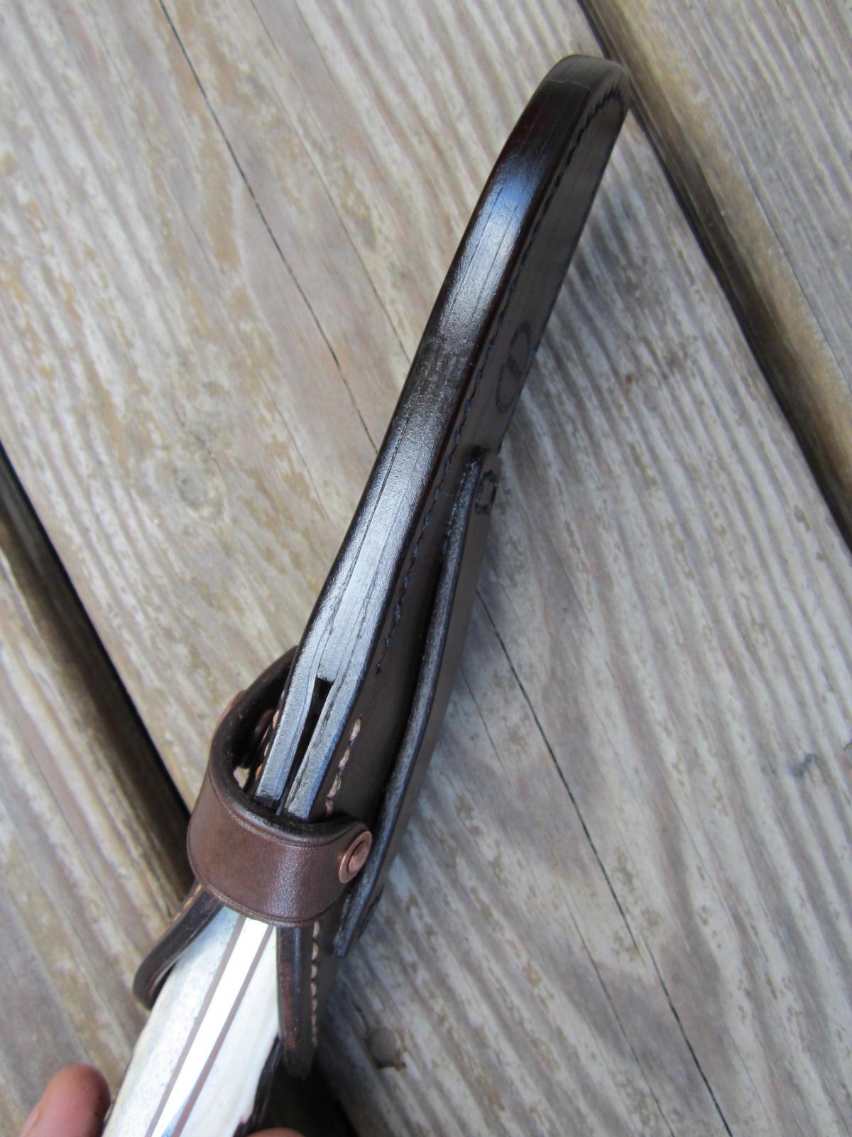

I don't think edge kote will stick to kydex. I would think you would want to see the color difference between the kydex and the leather edge. You may want to leave the leather natural, or use dye to color and dress up the leather edge. In the photos above, that's just sanded. Those edges are not burnished or dyed. There's many ways to achieve whatever edge you're looking to get. You can search for threads on this forum, Youtube, Google etc. for finishing edges. Hope this gives you a start. Here's a sanded, dyed, burnished edge example.

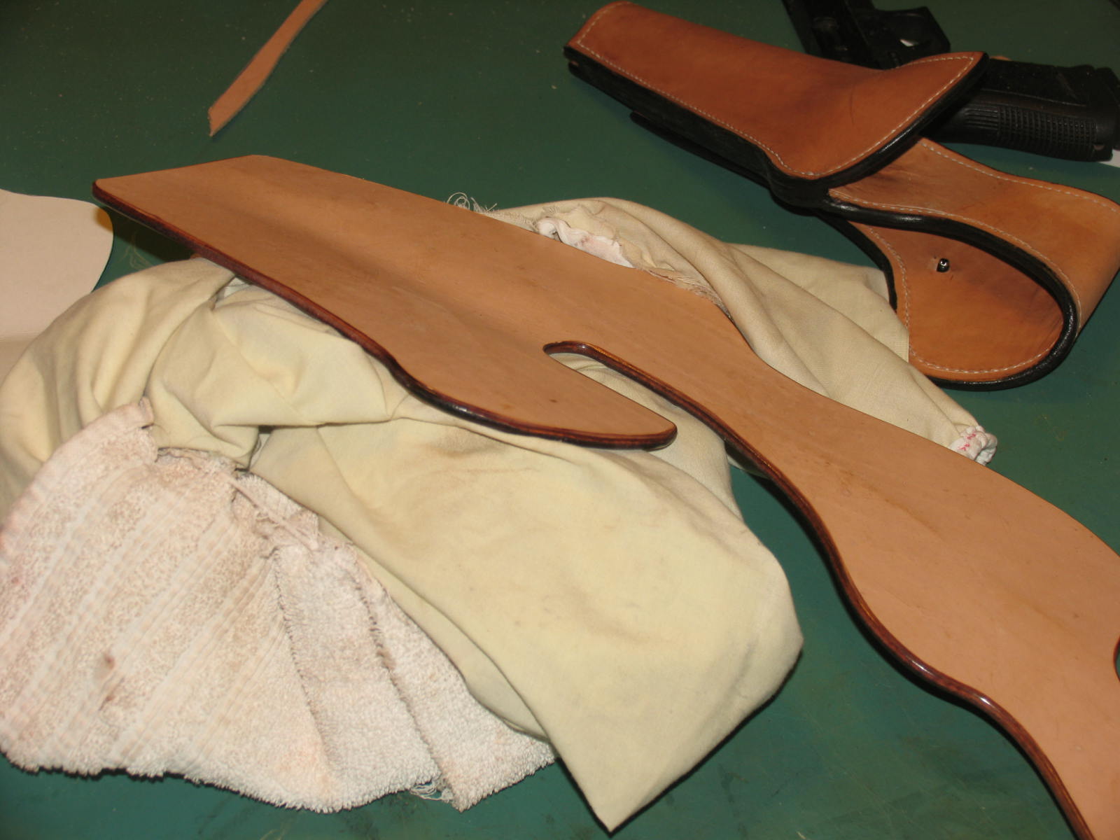

Started with 220 grit and worked my way through 320, 400, and 500. Dyed the edge and let it dry. Followed with saddle soap and water and burnished with a piece of denim from an old pair of jeans. Rub fast and pretty hard to get some heat into the leather.

That will give ya good edge. You can probably use the seal fat though I've never tried it. Lots of different things will work like plain water, or saliva. You can also use beeswax or paraffin or several commercial preparations like gum tragacanth or Wyo Quick Slick which is my favorite. You can also use plain canvas to rub. Sometimes this is better if ya don't dye the edges as the jeans can leave the occasional blue dye transfer. I also find it important to sand and rub in both directions. If ya don't sometimes ya can get a grain or nap to your edge that you can't really see but ya can feel.
