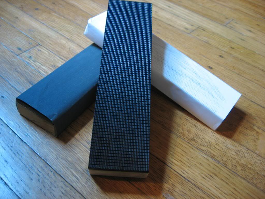

Call me a caveman if you will but my sharpening system consists of a drill press vise to hold the blade, a 3ft long 1x2 with a file or sandpaper or whatever taped to it and a cinder block. Place the cinder block behind the vise and lay your 1x2 across it and your blade. I like this method because I can set it up anywhere, you can file bevels as well as sharpen and the angles are infinitely variable, the closer the block is to the blade the shallower the angle and vice versa. The cinder block is heavy enough that its not going to move on you. I'll usually throw a few layers of duct tape on the edge so it doesn't eat into the wood. It's not as precise as some of these ingenious contraptions posted here, but I like it because it makes you take your time; much like a single shot rifle as opposed to one with a magazine. There's an intimacy to hand filing you just don't get with a belt system and is much more forgiving of mistakes.
