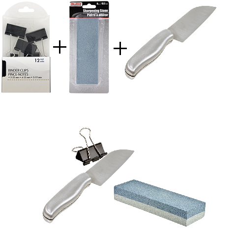

Hi,
This is what I'd do with five year olds,
It should take all of five minutes to ten to teach both instinctive and guided knife sharpening,
Put knife to coffee cup about about this angle,
rub for 30 count or however long it takes to sing happy birthday once or twice (like washing hands)
then switch sides and rub the same,
then try slicing some paper,
if you can slice paper stop,
otherwise repeat and sing again one side other side,
no more than 5 to 10 times
If you feel a burr , like you tried to get advanced sharpness and made a burr,
increase the angle waay up like DOUBLE, slice once flips other way and once and flip other way,
then back to rubbing at original angle for a 10count
DONE, LASER SHARP!

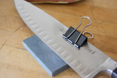

Thats two parts,
part one rub left side,
part two rub right side,
repeat until slice paper
part three is advanced , increase angle short rub , then back down original angle short rub
having trouble keeping angle? use little circles, or use a binder clip
Then repeat demonstration with a $1 sharpening stone and a binder clip, and raise burr, have them feel it, show the burr slicing pape roughly, then double the angle and cut burr off, show how it zips through paper now, maybe shave some arm hair if you/they can handle that
Thats the first 5-10 minutes depending on how well behaved they are.
Spend the next 5-20 minutes having them try sharpening by themselves,
then with a buddy,
walk around help,
get everybody from dull to paper slicing at least twice
Cost of equipment including tax $2.20 MAXIMUM, $1.20-$1.30 if you split a pack of binder clips
At end of class ask who wants to buy a stone for $1
