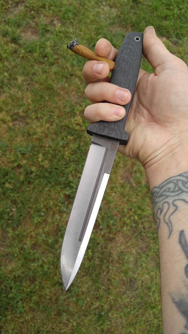

Cold Steel Master Hunter, full convex zero w/ a micro applied on the Wicked Edge
