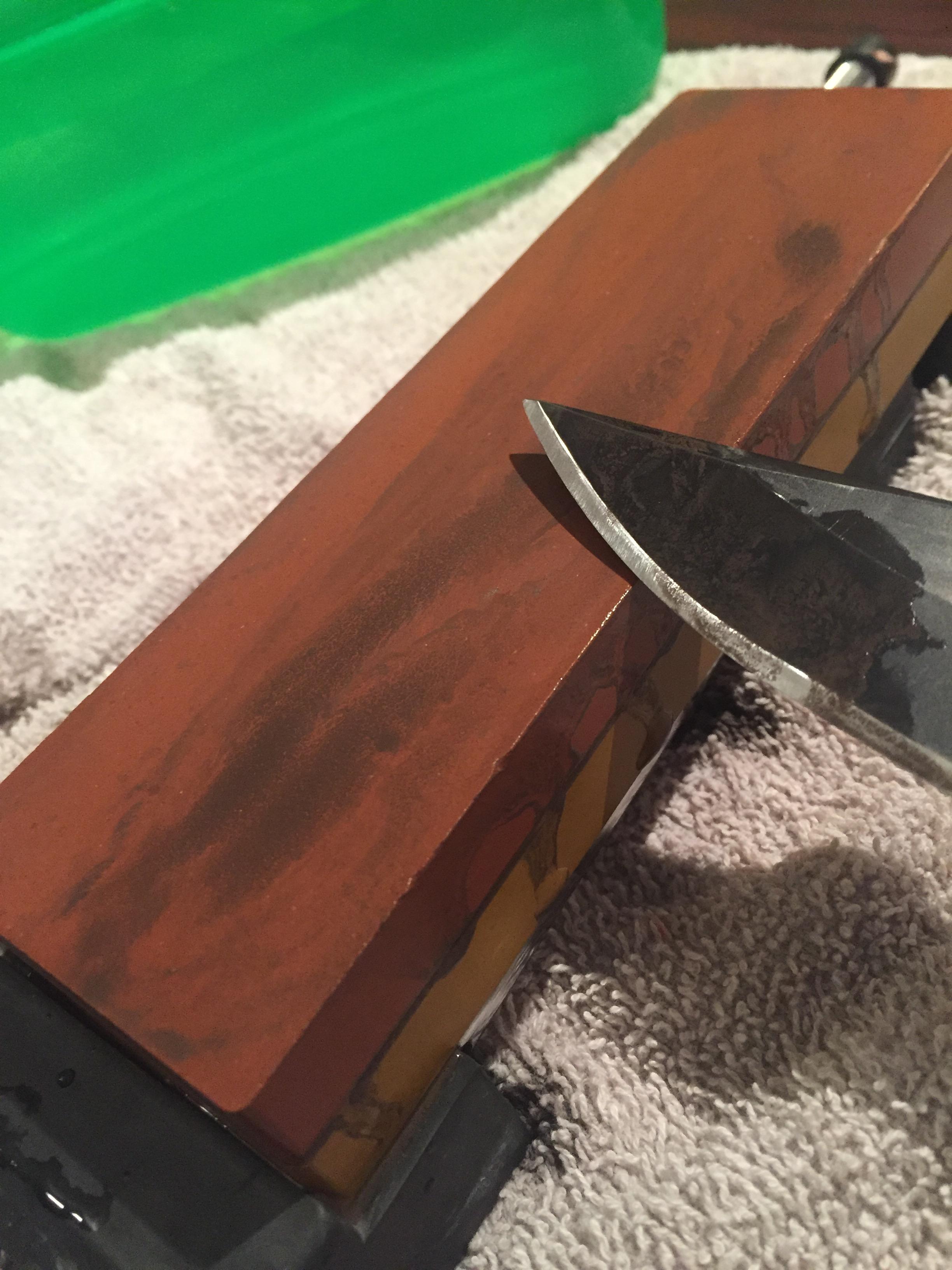

The 120 – This stone wears fast. You are able to build an awesome mud quickly, and it should definitely be utilized. This means you can use the stone effectively for single and wide bevel knives (largely relating to those who use Japanese chef knives, but then again, if you are using those types of knives, you probably have a larger budget than 50USD for stones). If you do not utilize the mud for standard narrow bevel knives like those on our beloved pocket knives, you will burn up the stone fast enough for me to not recommend the stone, especially if you hit it with a powdered steel. The mud will also scratch the shit out of your bevel, making it ugly. My Shun utility knife looks hideous. It’s sharp. But hideous. I will never use a muddy low grit stone again. Shapton Glass 220, or bust.
Conclusion: This stone fills a perfectly wrong niche. Although the general quality of the stone is great, it is a small-sized stone that would be most effective on larger knives, i.e. cooking knives, which is an antithetical proposition. It handled my 6” Shun fine enough, but I’d consider that a maximum for comfortable sharpening. Ultimately, however, the stone is cheap and it will get the job done.

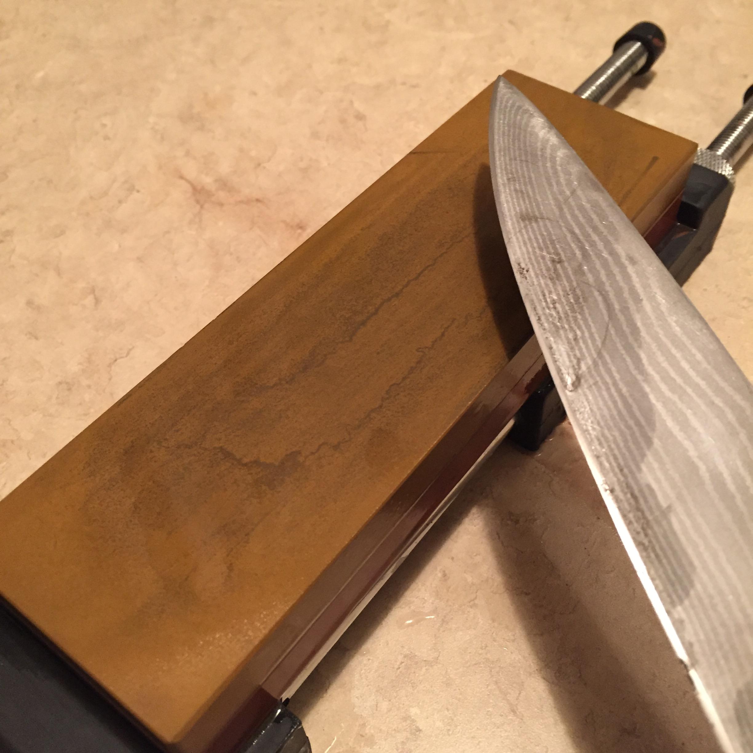

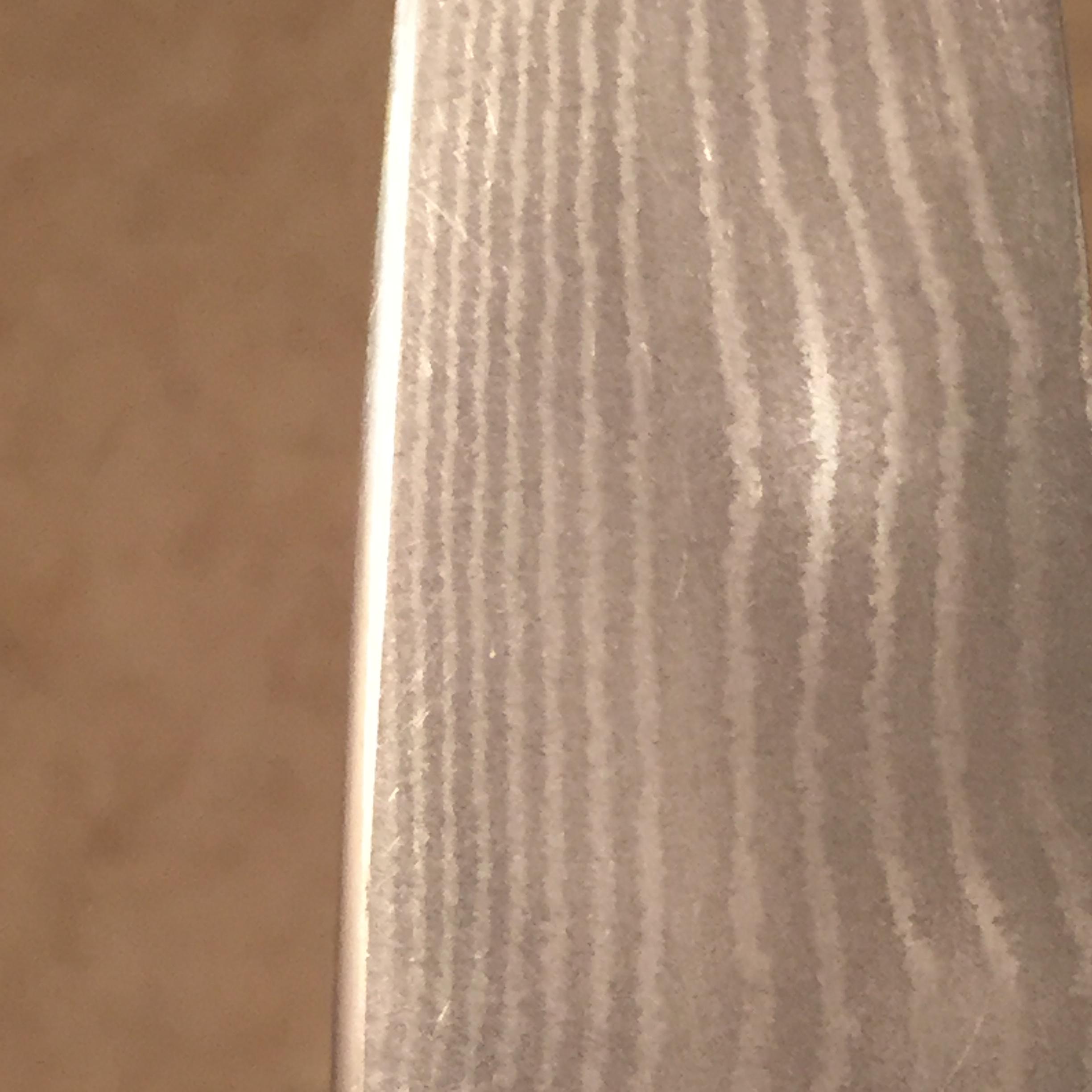

The 1K – This stone is pretty hard. It does build some mud, and does not load up. It is softer than a Shapton Glass stone, and the mud you build will help to polish your bevel. It is considerably harder than the King 1K. It cuts faster than the King, and has a visibly higher polish. I enjoy the Naniwa Economical 1000, and if you have used and like the King 1K, I think you will likely consider this stone simply a better version of it.

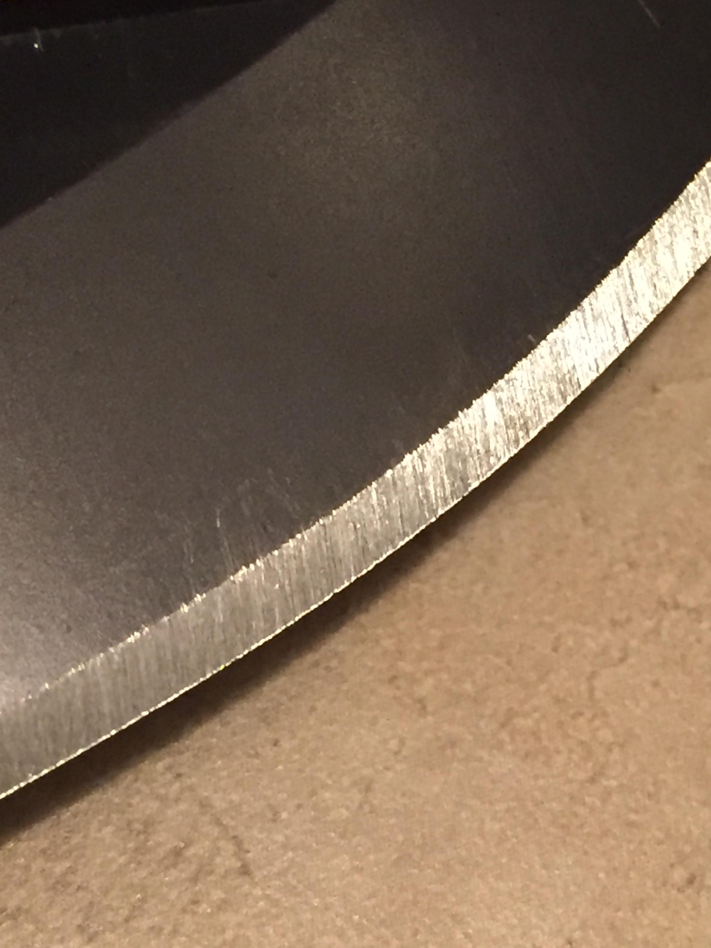

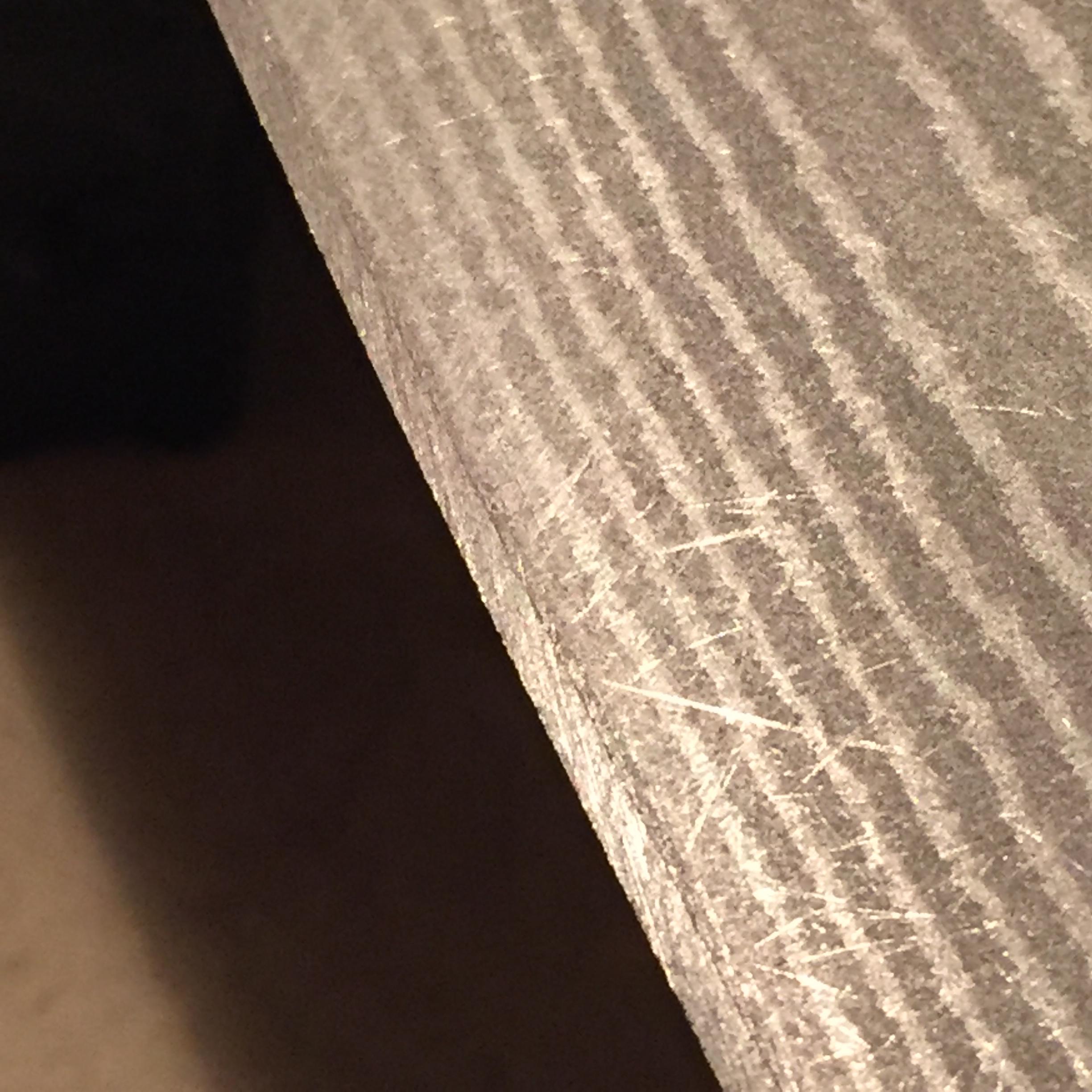

The 3K – This is the first step, in my opinion, into what people consider “the polished edge.” I consider the 1K to 2K edge to be in a kind of transition realm—not that I think a 2K edge is incomplete, or anything. I regularly run a 2K edge on my EDC’s. But the 3000 is with out a doubt, a polished edge. The Naniwa Econ. 3K will produce a shiny, clean edge, though not a complete mirror. It will be a shiny haze, if you will. This stone is also hard, and does not build up a mud so much as just black swarf. There is minor minor surface loading, but it does not impinge cutting speed.
The final result is an attractive edge that will easily shave hair, especially after a loaded strop. I use a simple strop (I am by no means a strop enthusiast) of leather loaded with some green CrOx. This edge should permit one fantastic cutting performance in everything but shaving their face.

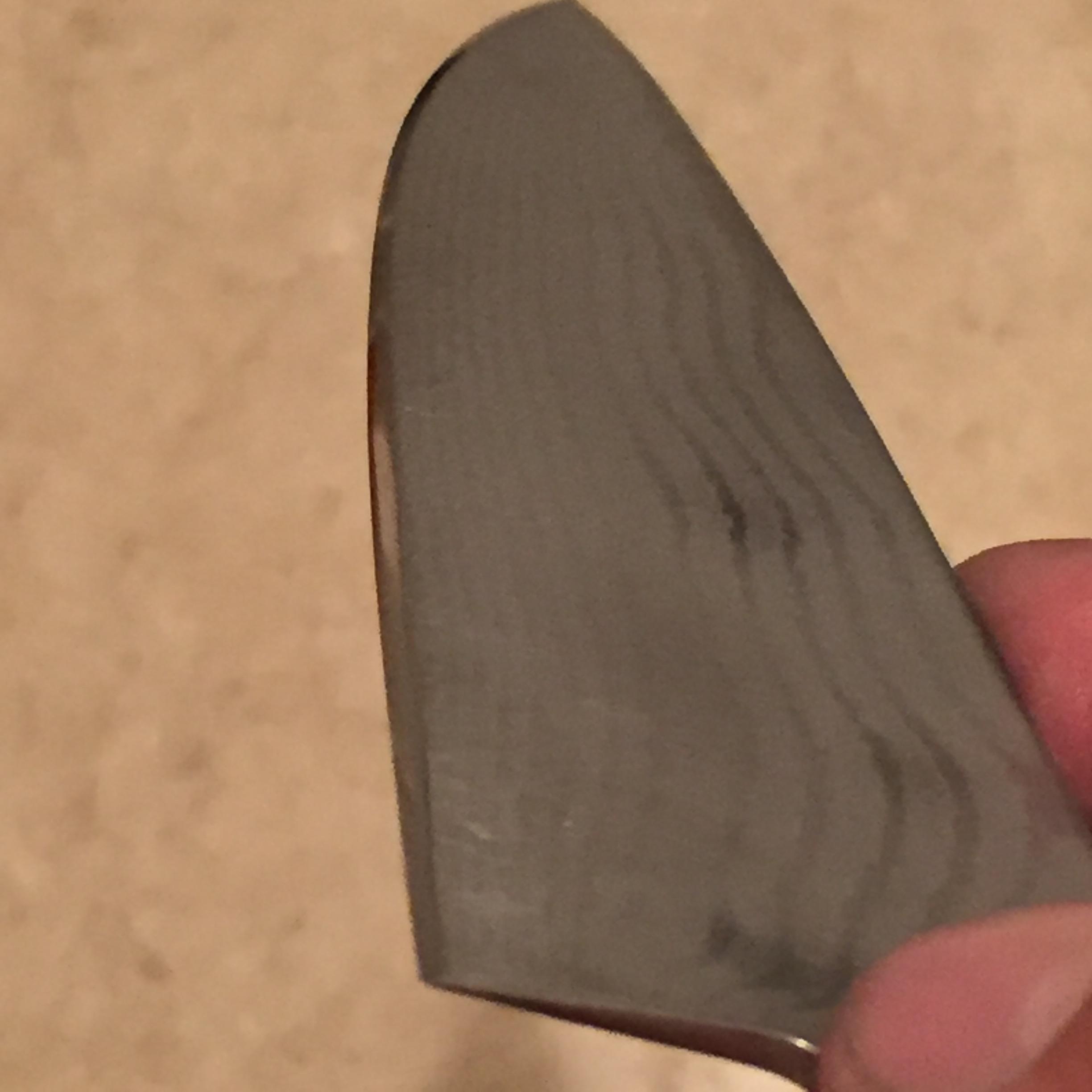

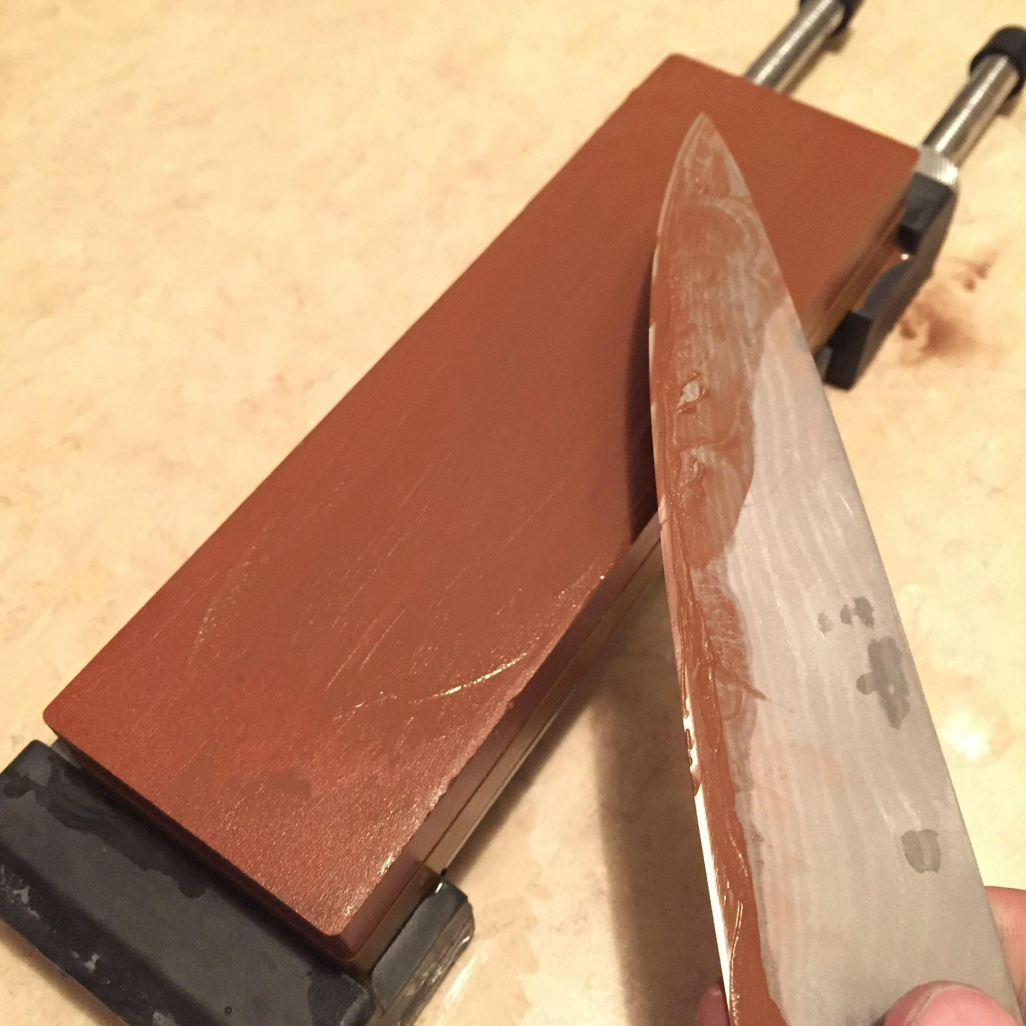

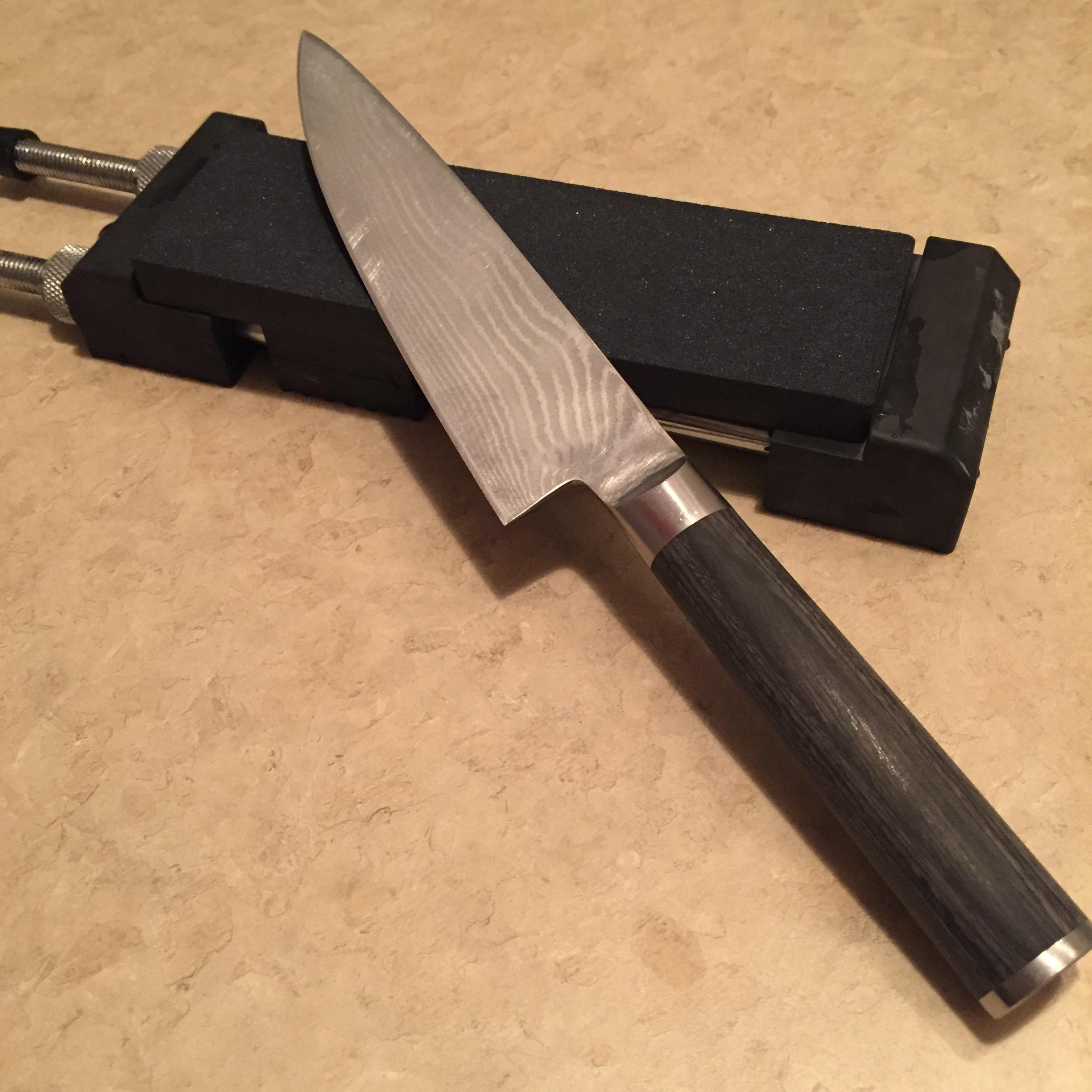

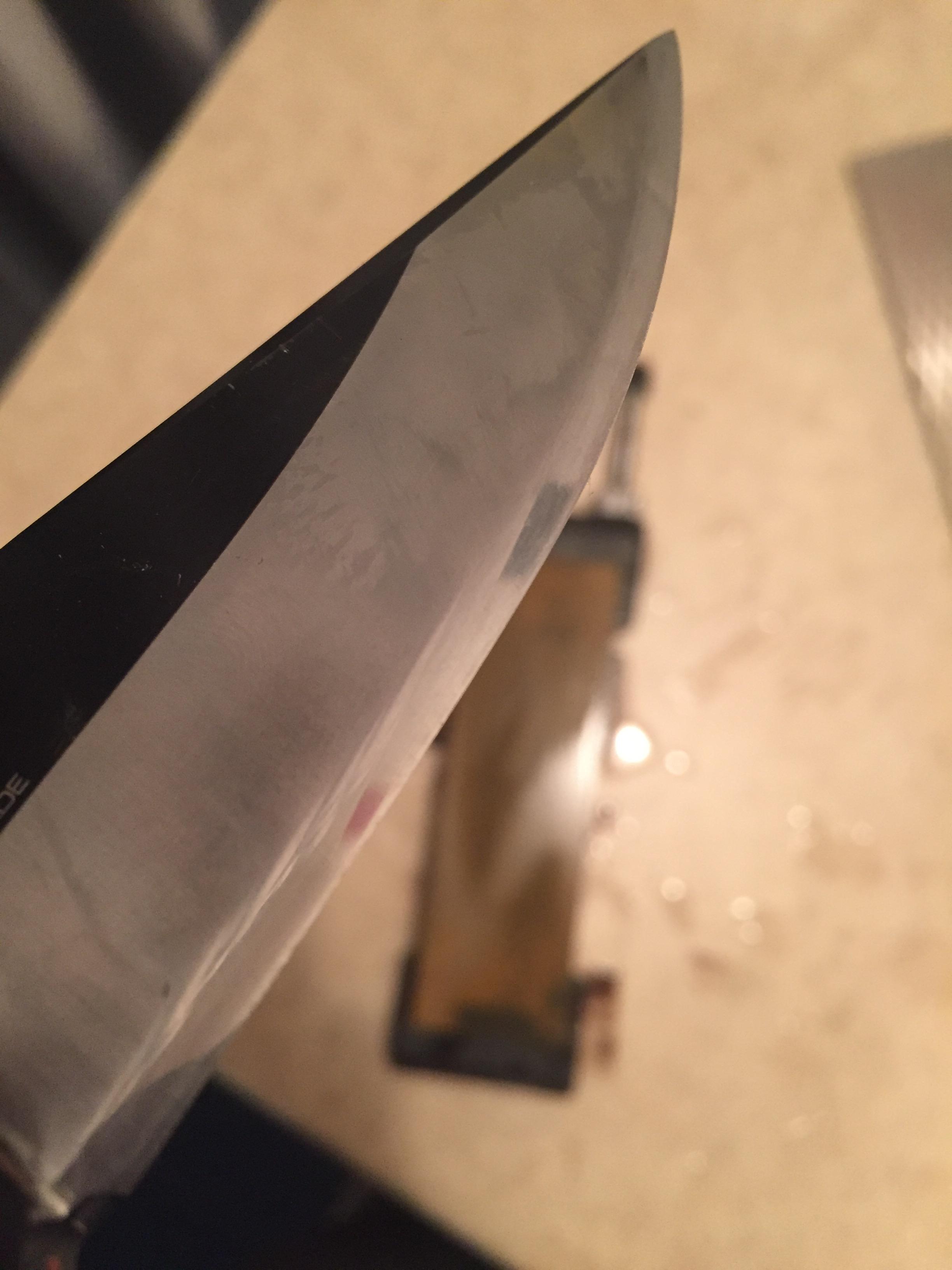

Okay, I've decided to upload my photos, for what they are worth. Also, testing. I cannot seem to upload a pic, so I am going third party. This may fail.
Again, these pictures are kind of garbage. Perhaps I will work through the stone on a knife with a fatter bevel just to give you guys a better look. That, I can do later today.

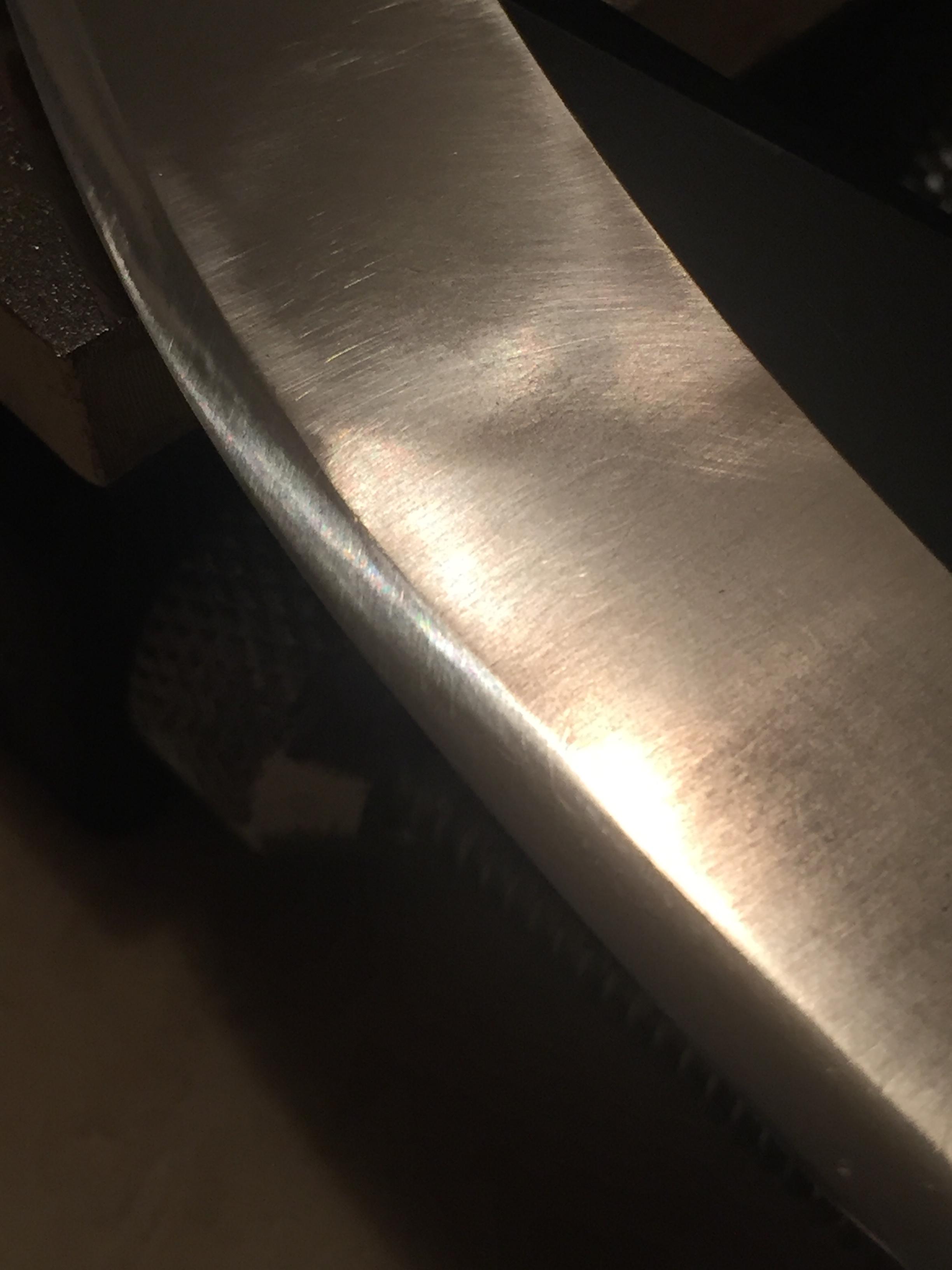

This is the edge off the 120:
This is the mud from the 1K:
This is the edge from the 1K:
This is the mud from the 3K. However, there is more swarf than this; I took this after only doing the one side.
And finally the edge from the 3K, but again, the pictures are of low quality... I'll work on capturing better photographs for the future.

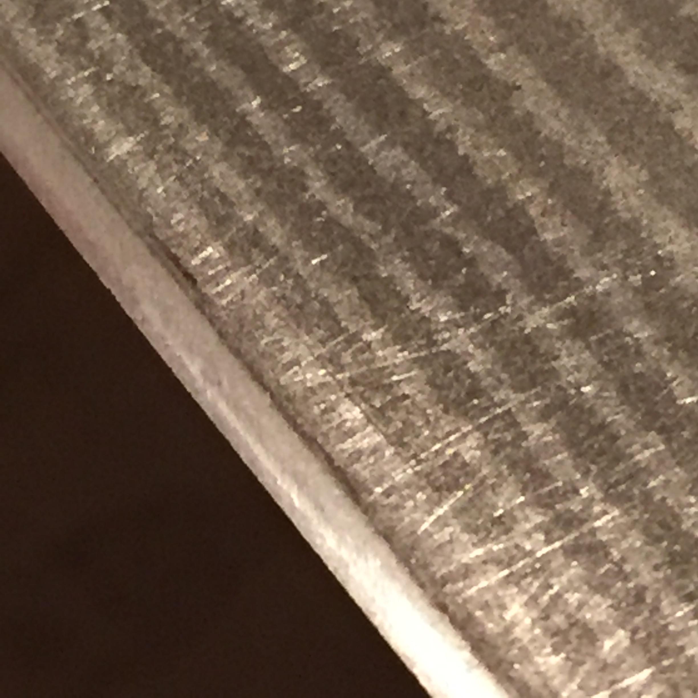

In tandem, you can see that the 3K finishes to a shiny haze.

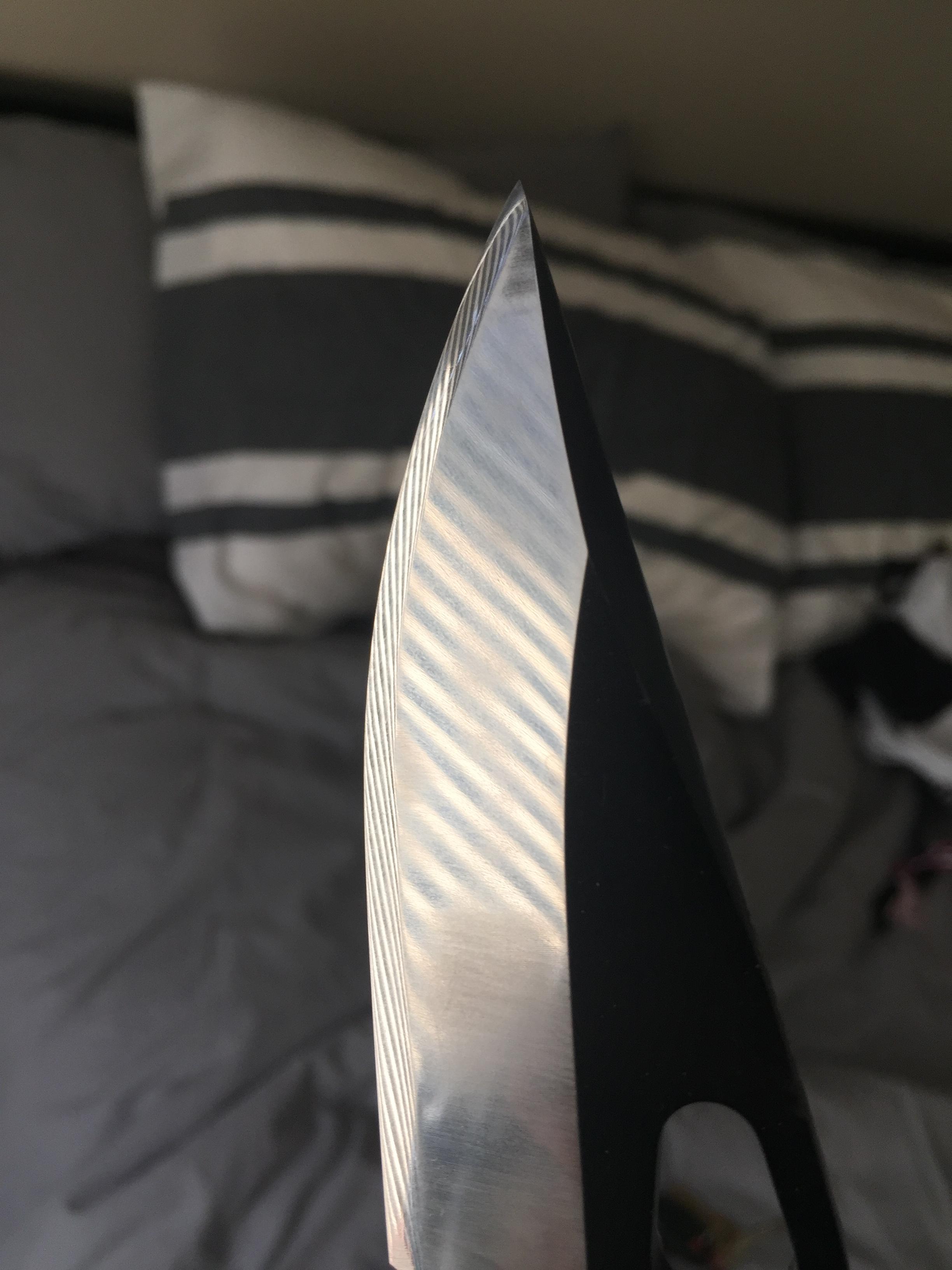

Let’s get to the photos!

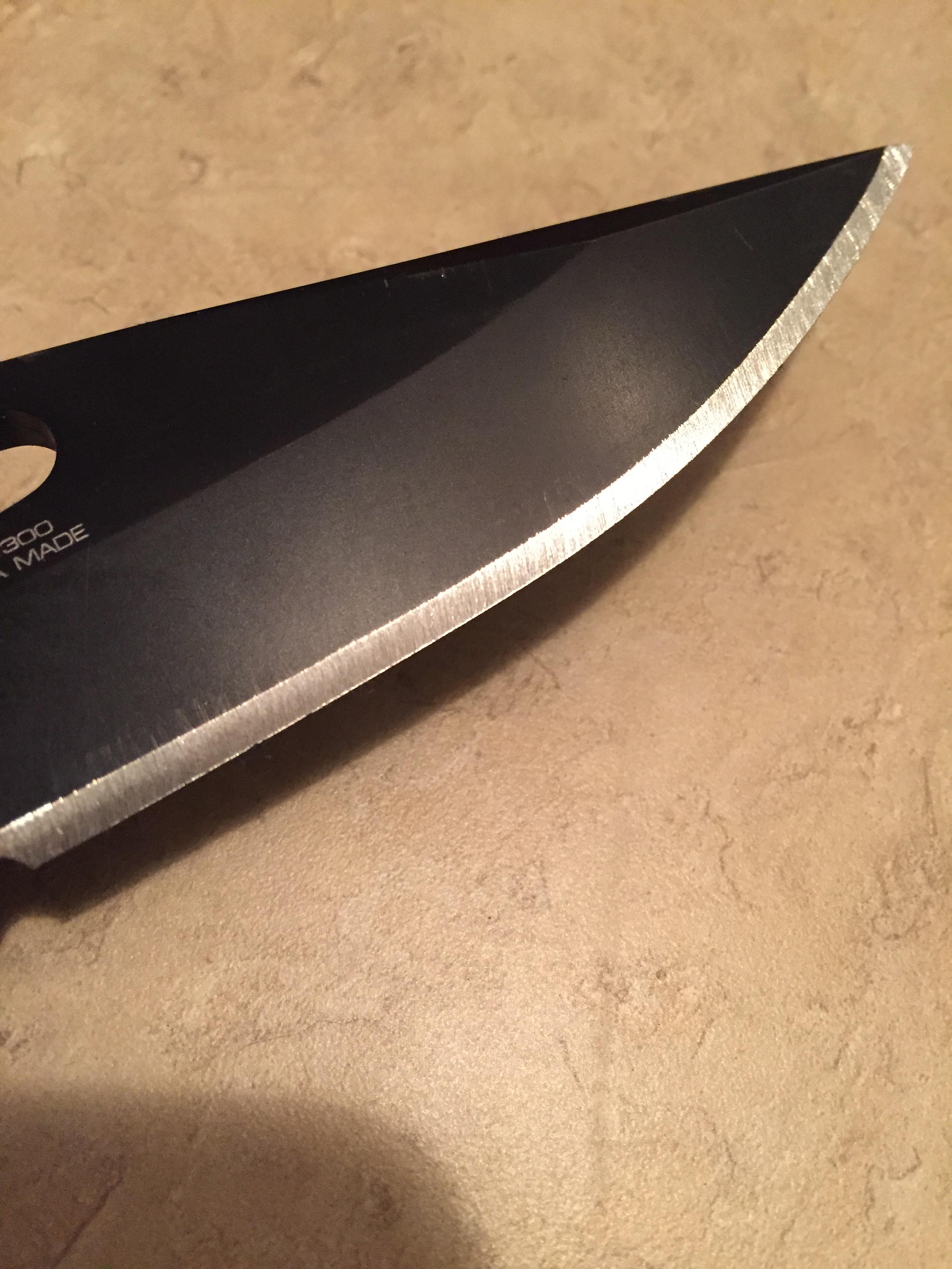

This is the edge after the fresh Atoma 140. Actually looks quite pleasing to me. I feel like I could saw down a tree with that edge.
Here is the edge after the 1K. This took about 30 minutes to achieve.
Here is the mud generated by the 1K. It is almost nothing but swarf. Pressing harder (not excessively hard though) would build a little mud, but I opted for less pressure and more patience. I also only soaked the stone for 5 minutes as opposed to 30 minutes for when I sharpened my Shun which seems to have influenced mud generation. The stone felt harder after a shorter soak.
Here is the hazy mirror after the 3K. The stone performed the same as the 1K, building that same black swarf. The 3K doesn’t generate mud at all.
And this is the edge after stropping on 1 micron CBN. The lighting implies a mirror finish which is not true. It looks like a way cleaner mirror in the photo than it truly is.
