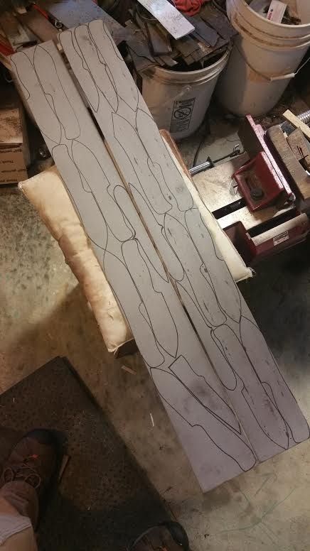

All the blades drawn out on the steel ready to get sawn out.
I cut 12 so that I would have 2 extras in case something happened to some of the others. If all goes well there will be 2 extras at the end of the 10 piece run for the group buy.
I do not like wasted space on steel so I added in a few extra blades just for good measure.

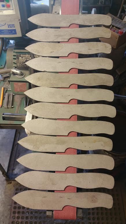

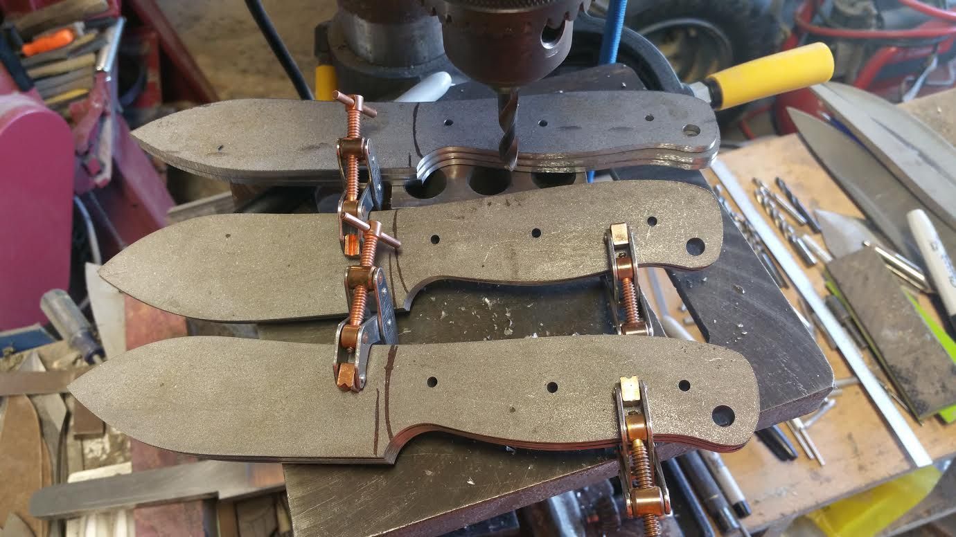

Here are the knives all profiled out.

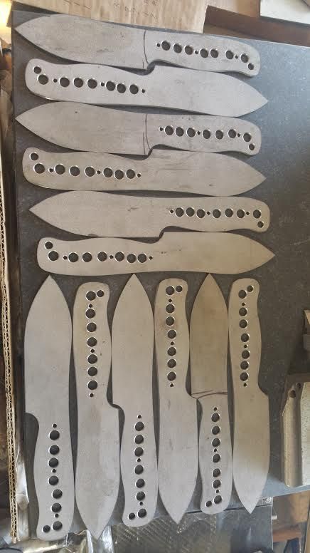

When drilling the holes on similar patterns I find it quickest and easiest to stack them and work in groups
Pin holes and lightening holes drilled.
If you notice I drilled them for either 2 pins and tube or 3 pins without a tube. This will be an option when finishing.

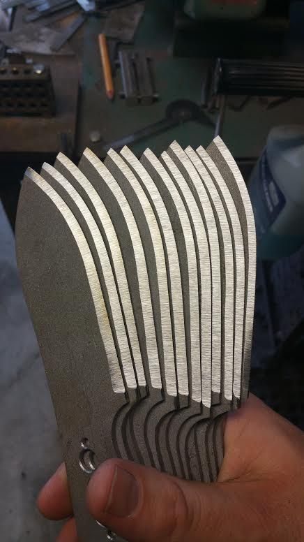

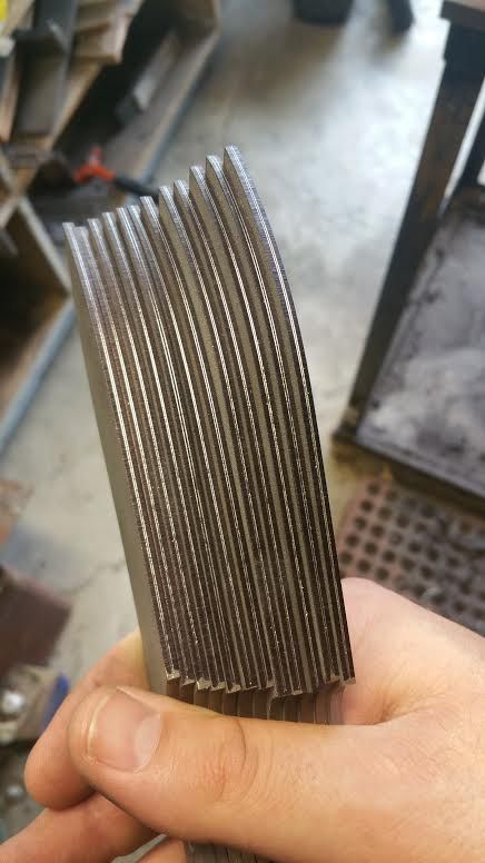

Now is time for some hot and dirty work, the rough grinding.
Here I have the center lines laid out to grind up to.
I have the edges broken with an old belt so not to strip the abrasive on the sharp edges.
Rough grinds laid in with 36 grit belts.
This is with the preheat treat grinds finished.

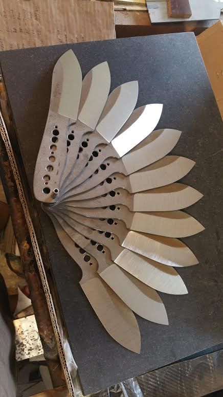

The blades are on their way to Peters right now for heat treat. I am requesting a hardness of 60-61, but asking that they try to stay closer to the 61 for better edge retention.
I am really pleased with how these are turning out. I hope to get them back in a few weeks and get to finishing them up.

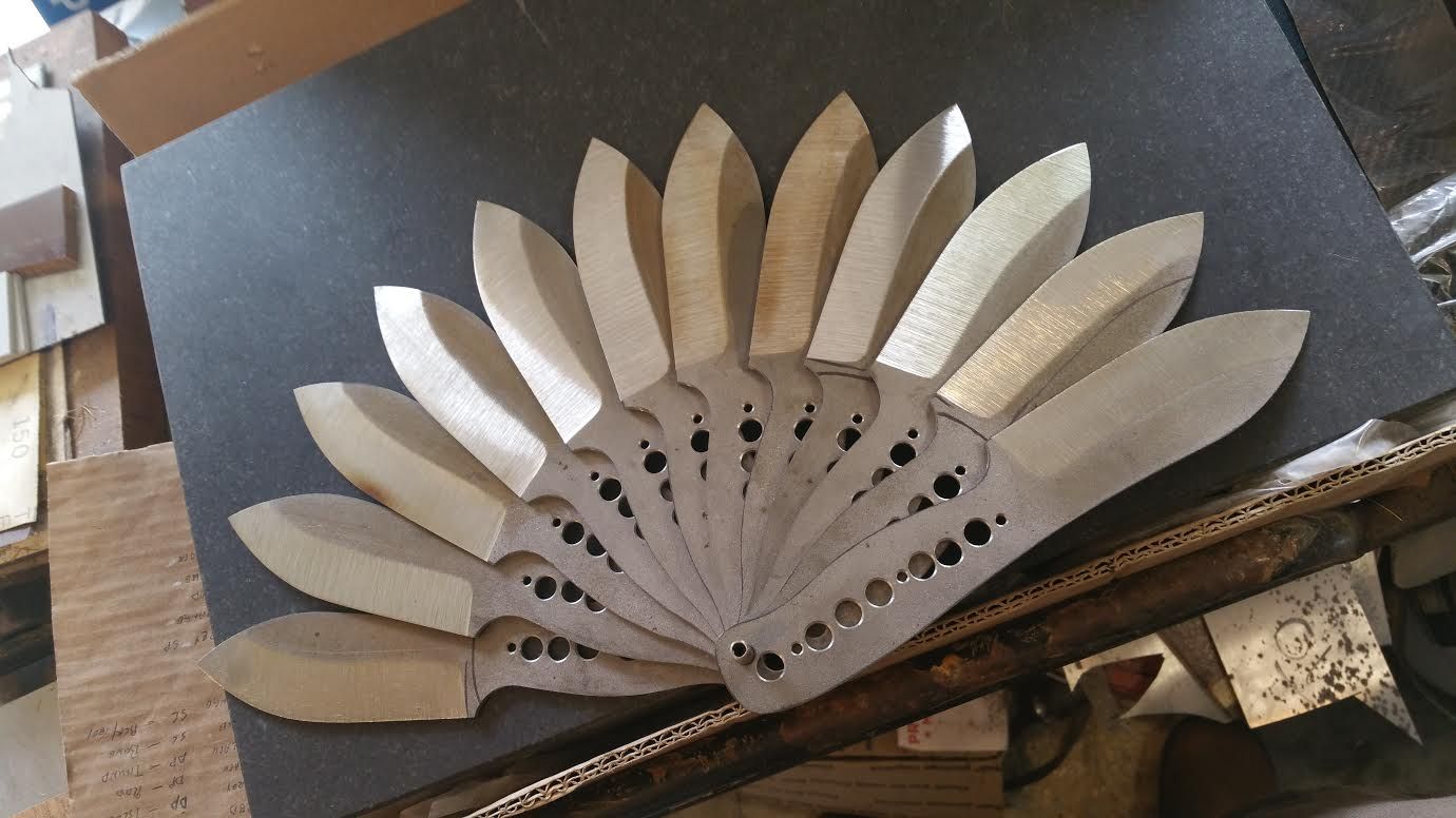

The Nessmuk blades are back from heat treat.
I will get a picture uploaded here in a little bit.
