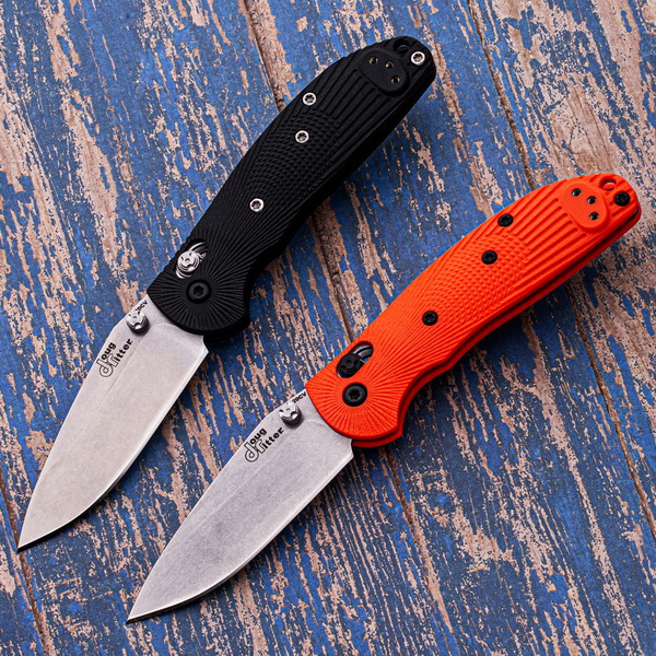

I just balanced it on a metal garden post and shot the pic from directly above so you can't see the post below.
As far as the dye wearing, I'm curious to see as well. I've carried a dyed Military for a while and it's held the color just fin but this knife has a bit more texture so maybe it will show wear a bit more. I think if the orange starts peeking out again it might look kinda cool. I'll update if it shows significant change since this knife is a user. It's a great knife and I'm really enjoying carrying it.
After owning this gen 2(one orange and one black) as well as the gen 1 ritter grip, I wonder what's the rationale of having a thicker blade behind the edge on gen 2. Really missing my gen 1, which unfortunately I sold.
If it is not too late, I hope mini gen 2 comes out with thinner BTE just like gen 1.

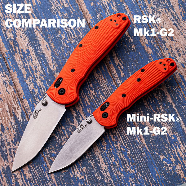

I'm going to stick with my mini Freek, I know the Ritter has better steel and handle material but I prefer a satin blade and the extra length that the blade and handle gives me on the mini Freek.
Plus I got my Mini Freek for 50.00 cheaper.
Just ordered a Mini-RSK in black. I've been waiting for this one! My 555-1 might be losing a little pocket time.

Anyone know what the handle thickness is on the new mini RSK? Just wondering how it compares to the G10 Mini Grips.
