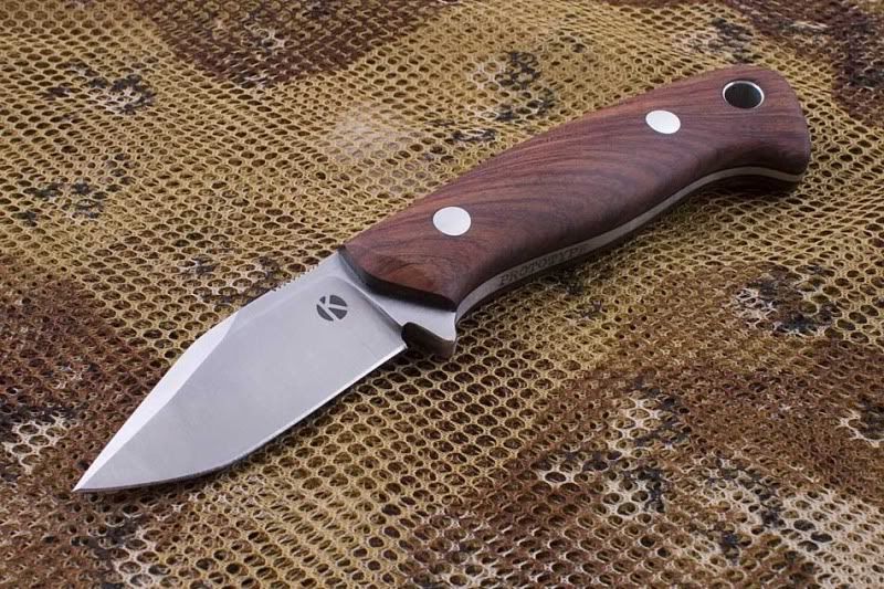

Here are TWO of the latest and greatest EDC design. The only difference between them is blade length (3 and 3.5 inches).
Here are some specs:
(top)
8.25" overall
3.5" blade, 3/16" thick O1, Drilled Tang, Hollow Grind, Swedge
4.75" handle, Natural Canvas Micarta, Heavily Bead Blasted, 1 pin, 1 lanyard, Contoured Handle
(bottom)
7.75" overall
3" blade, 3/16" thick O1, Drilled Tang, Hollow Grind, Swedge
4.75" handle, Black Canvas Micarta, Heavily Bead Blasted, 1 pin, 1 lanyard, Contoured Handle
PIC =
Biggest improvement is the Hollow Grind done on a 14" wheel for a nice shallow concave grind, but noticeably thinner than a full flat grind.
NEXT Biggest Improvement is a 1/4" added to the length of the handle and the the whole handle "angled" up more so it is "straighter" from butt to tip.
Feel free to ask questions or make comments!!

I like the look of the Blade to Handle ratio on the 3.5 much better than originals. Plus, the 3.5 is right in line with WV carry laws. I can't wait to see a run of these.
Perfect size as they are I think. My eyes are attracted to the 3 inch, but my brain says 3.5 is better...decisions, decisions
Dan, those look awesome. I would carry something like that everyday for sure. Great design. I really like the 3.5, but he 3 is nice as well.
Those are great little knives Dan. I would carry either one but due to the rule of law where I live, I would have to go with the 3" for EDC.
I like the handle ratio.
I'll go for the 3.5 as well.

I'm glad you got rid of the sharpening hole/choil or whatever you call it in your proto. I can't stand those things.
I'd go for something bigger, and in stainless of some sort, I figure that sort of knife will be living around the neck/in a pocket.
These are just prototypes - doing them in O1 makes them quick-n-easy to whip up.
The "official" version is going to be offered in 3V or D2.
The handle-to-blade ratio is not as visually appealing as some....but you have to remember that this knife was designed from the get-go as an answer to the "How much Blade & How much Handle can you stuff into an EDC knife?" question. ;)

Shotgun - glad you noticed that.
I did away with it because it was not practical....kept catching on things when I had to "zip" through a material...so out it goes.
I also did away with the tapered tang because it didn't make enough difference compared to a drilled tang left at the full thickness, yet added a TON of work and specialized tools in the process.
The steel on this one is around 0.190" thick....the skinniest one so far. Because, honestly....I have found I don't really need it more than that. I have gone as thick as 0.280" and the last one was 0.208" and they are still "overkill", so I took these down to 0.190" thick to try them out for a while. The hollow grinds will make them excellent push-cutters too (something the previous versions did not excel at).
I like the pointy tip on the 3.5" very much. And I hate sharpeningcoils too, so that's a serious improvement to me. That one really interests me.
D2 would be fine. CPM 154 even better :cool:
