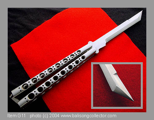

When doing an insert as Mr. dredd8 has done in the upper right-hand corner of his picture, I usually put a boarder around it so that it doesn't look like some strange piece of knife sitting in the picture.
