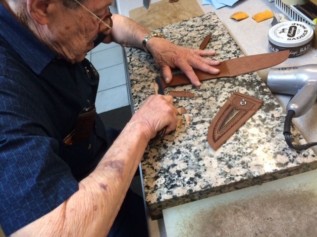

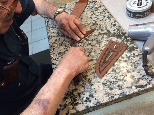

I slipped away and spent a few hours at Paul's today. Dave, I got to handle that skiving knife you sent and it's a beauty! Wonderful size and balance. I'm still in no shape for even light work, so I didn't use it, but it sure felt nice. I couldn't help but think it would make one heck of a tomato slicer:D Paul was putting together a stunning sheath with an ostrich inlay for an equally beautiful damascus blade. I managed to snap a few pics of your knife in use. Keep up the good work:thumbup:
