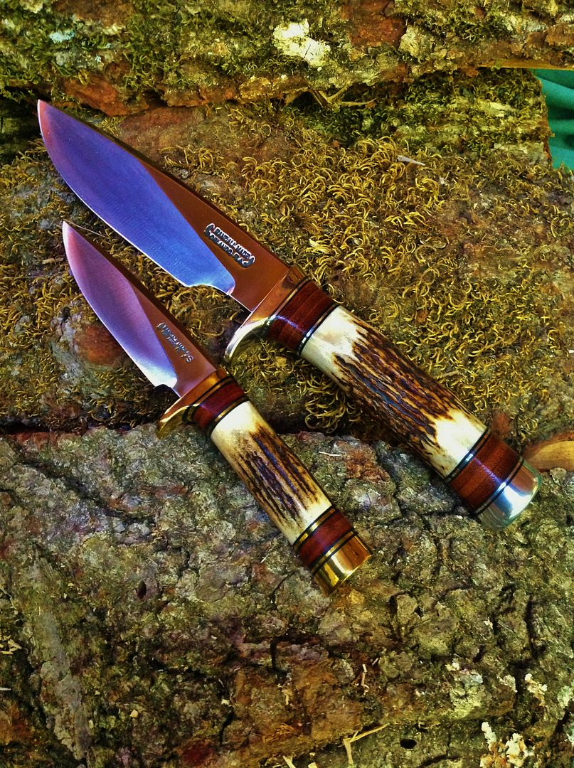

Here's my Mini 25, serial #1282
And with his big brother

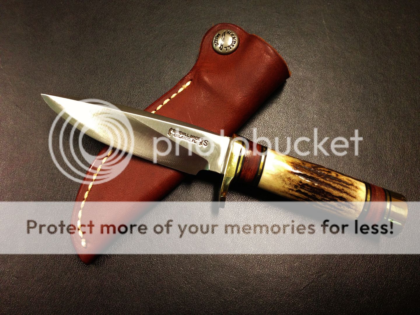

As to photos of Mini 18's - this one, from 1971, is not fake; it lives in my safe, for now...
I'd strongly suggest staying away from any 'one-off' miniature RMK's; few were made and most are accounted for...
Nice mini 18! Very nice indeed! It seems some of the mini's appreciate more in value then the full sized models they duplicate/replicate.
