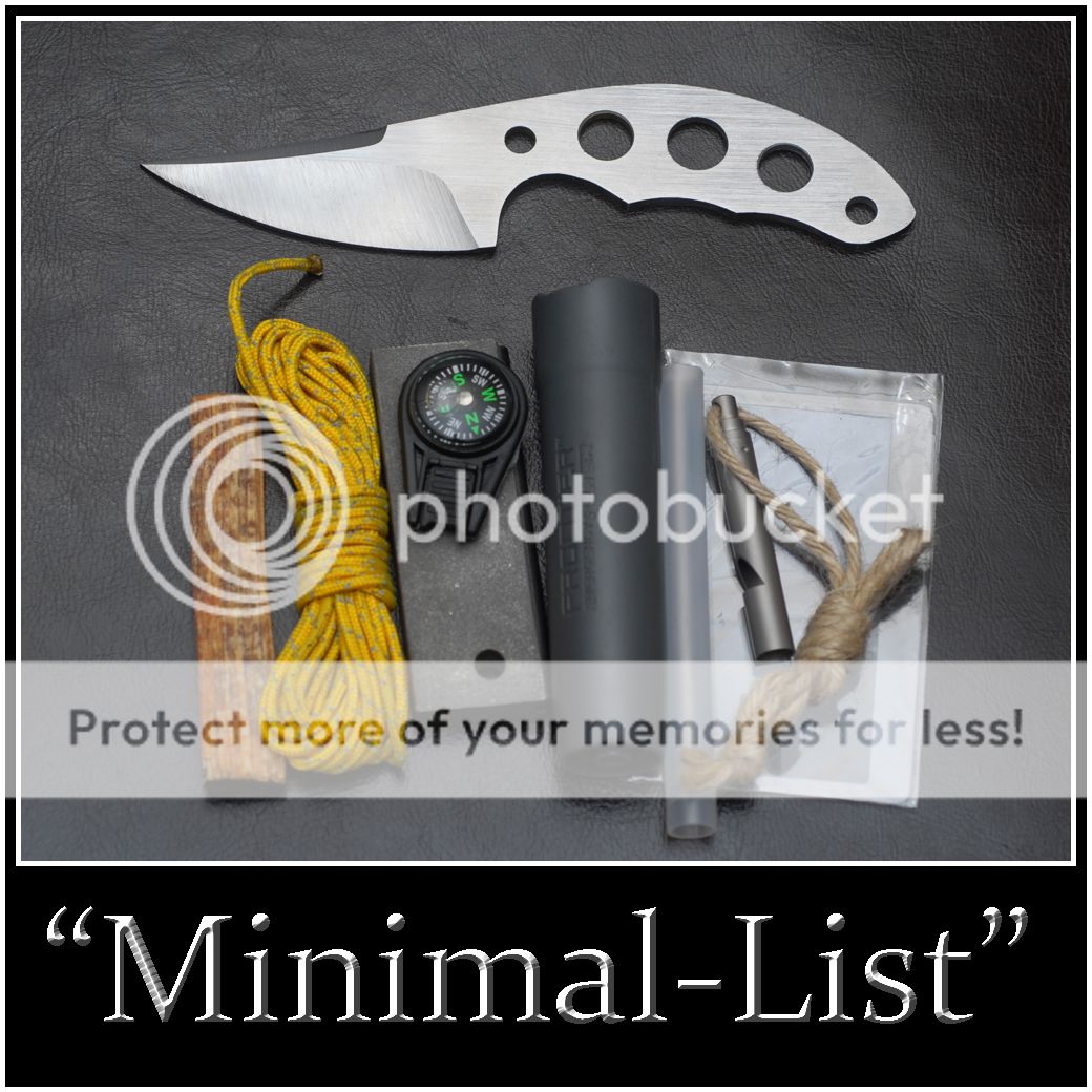

I have a project in the works that I am calling my "Minimal-list PSK". The idea being that it is a small self contained Tin or Package that can be thrown in a small bag to have with you at all times. I want my kids to have it so that if for some reason we get separated in the mountains (one of my worst fears) I know they have the tools (With Training) to survive 24-48 hrs. and increase the possibility of being found.
  1. Skeletonized Neck Knife
  2. 5/16" Firesteel Rod (Tempted to just put a Lighter in there)
  3. Aqua Mira Water Straw
  4. Cordage
  5. Button Compass
  6. Small Proton Light
  7. Fat Wood
  8. Whistle
I open this up for discussion regarding what is needed and not needed and why... Altoid tin is a good size "Minimal" PSK IMO (Miro Straw doesn't fit in one unfortunately)

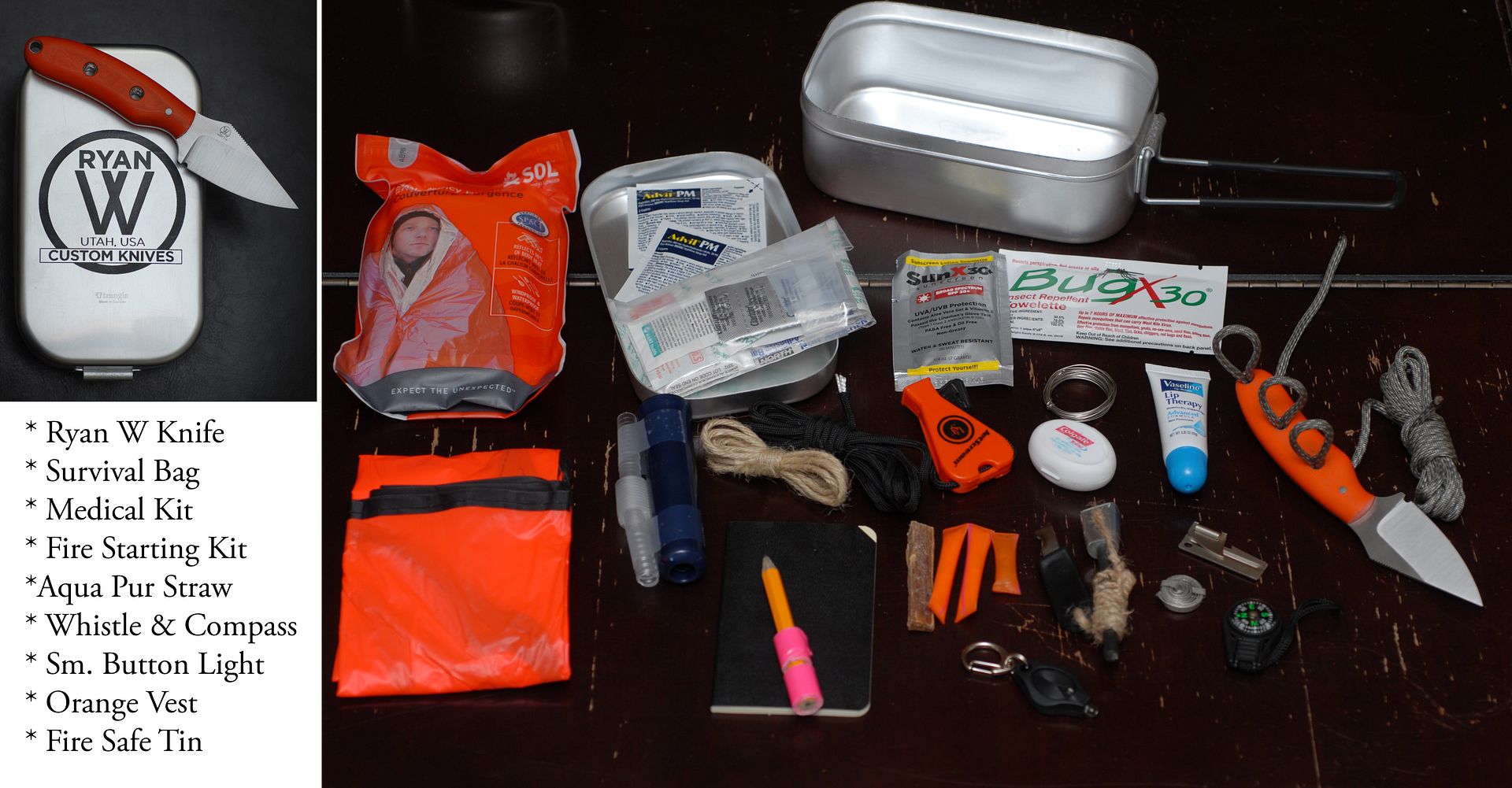

This is one I put together last year, much larger than what I am talking about...

Looks great. Just a few suggestions which might be helpful or maybe not as everyone's needs are different. First off your little kit looks great as is. :)
1. The orange vest. I don't think this is needed. You SOL/AMK Mylar blanket has among other things a highly visible orange side.
Replacement item. The suggestion to work a poncho into the mix was already made in IMHO a very good idea. Granted space is limited but an inexpensive plastic poncho probably won't take up more room than that vest. Granted it is disposable but they're multi purpose and do work in the short term.

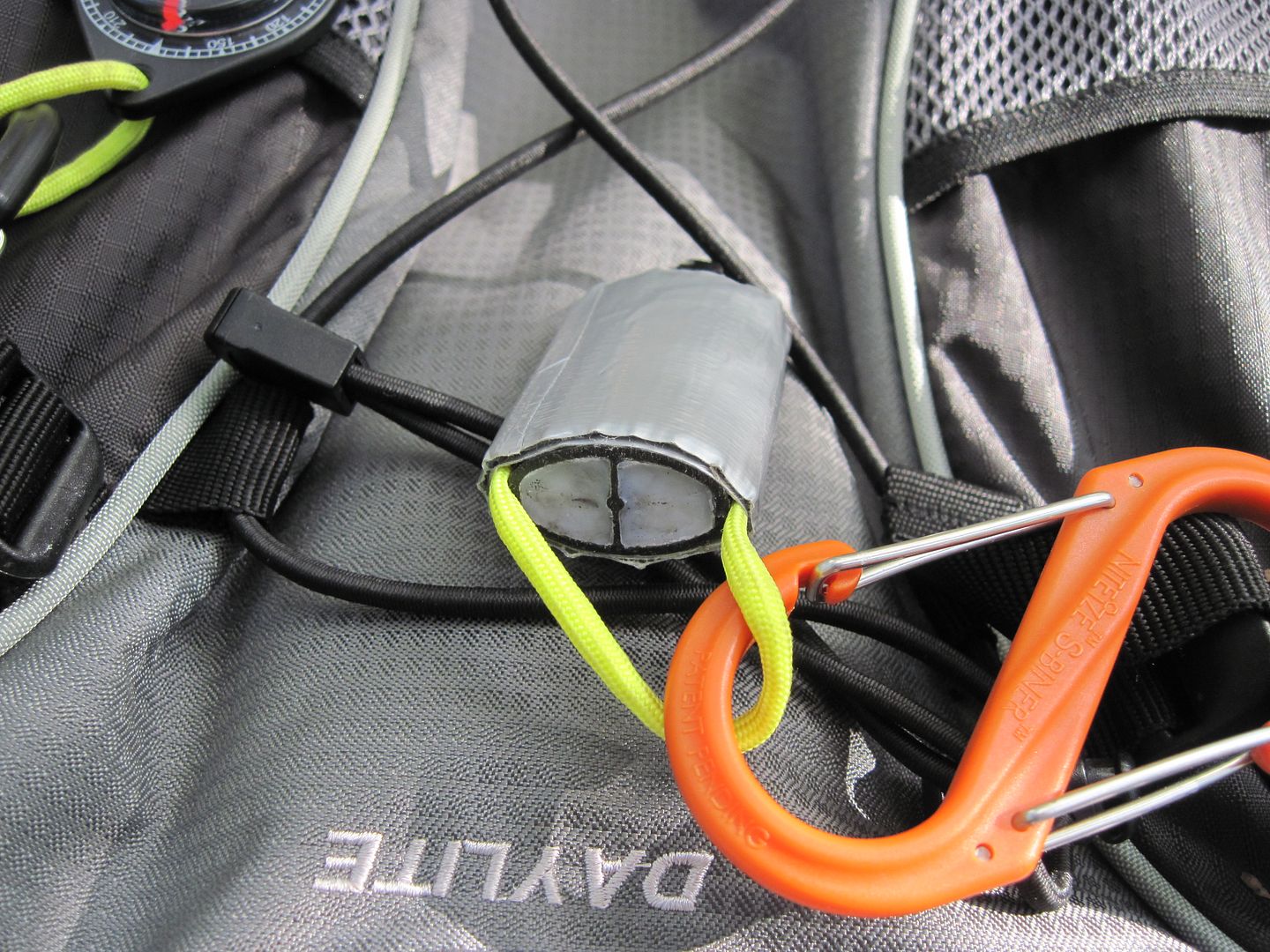

2. Firekit. Great play getting a firesteel and clearly you have an understanding of the multi uses of jute cordage. For a very small Altoids kit one way to start a fire is ok IMHO because of the small size but here we have a bit more room. Things have tend to walk in the woods and more so if under stress. More options the better. I do see yea have tinder which is good. Maybe a mini BIC might be useful. They're just so small. I know what people say about lighters however we are talking about a backup and often they're more reliable than people give BICs credit for. Also an empty lighter is far from worthless. I have started plenty of fires with empty BICS.
Here is another small backup. A SOL Fire lite.

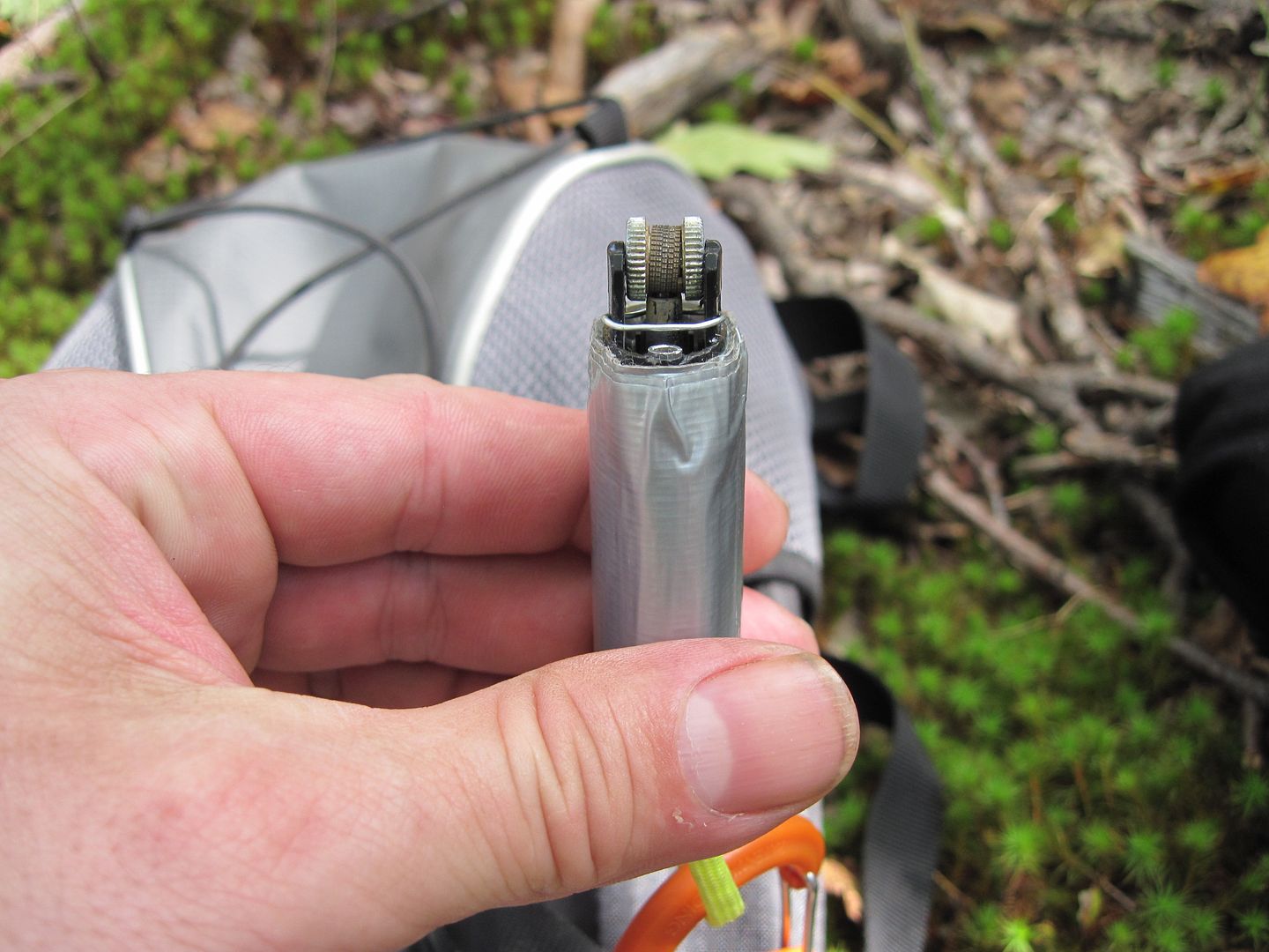

But with a little modification in the field an empty BIC becomes a Fire lite.
Or if you have the time that empty BIC can become a little SAK of it's own with Duct tape, sparker and tinder sealed within.
Also a small cutting of charred cloth would be nice. That tinder will coal with the weakest magnification or spark. Won't take up hardly any room. Goes without saying knowledge of how to blow a coal into flames is helpful. You have the jute so guessing that's covered. Granted you can always char a cutting of cloth or natural materials like punk wood or cedar bark using the tin but still it takes up nearly no room.

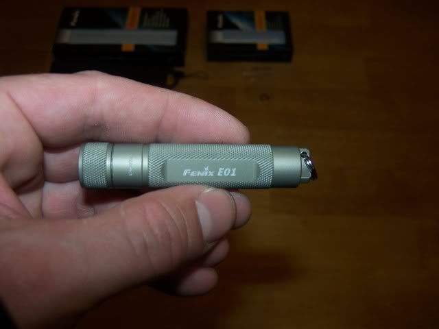

3. Small Proton Light. Great for an Altoids kit but I think yea got a little extra room here. A Fenix E01 with lithium primary AAA will operate in ANY temp, be crazy waterproof and function more like a real flashlight. Not all that bigger than the AAA battery it holds. People have done some insane abuse testing on these. They go for around 13 bucks and run regulated.
4. Skeletonized Neck Knife. Looks great. Is it carbon steel? Not really a big deal but carbon steel knife + chert, quartz or flint + charcloth + jute corage can = fire. Just another option. But if yea like that knife by all means keep it. Looks darn nice to me.
[video=youtube;VrDUAOTTxCw]https://www.youtube.com/watch?v=VrDUAOTTxCw[/video]
5. FAK. Toss an ear swab in there if yea don't have it. If yea fluff up one of the ends it will ignite with a marginal spark. That's two fires using either the firesteel,SOL or an empty BIC for that matter. Plus last year a bug flew into my ear on the trail. I really could have used one but as luck would have it there wasn't any. Darn! Sure I packed some but nope. Much of the cotton parts of a FAK will work for tinder. Guessing the same goes for that Vaseline lip balm which should work on cuts as well. Most of the anti bacterial properties of triple antibacterial cream probably comes from the white jelly anyways. However I am no MD so could be wrong.
6. Aqua Mira Water Straw. Once got turned around during a very hot day drinking up my water. That's what I get for going to a new area without a map and then go off trail "exploring". No big deal, ended up appearing in someone's back yard feeling stupid. That confession from years ago not withstanding that same straw was actually used in a trickle of a brook. It really worked. Granted I wasn't going to die but the produce preforms as stated. That said maybe toss a few water tabs in your FAK if yea have not already done so. Takes up nearly zero room offering a backup. You can boil water in the tin as well. There are some very small ER folding water bags that might fit inside your kit. Water is everything.
7. Button Compass and whistle. Great! Maybe a signal mirror and if possible a little red marking ribbon tape. If there is no room the Mylar blanket is reflective.
Is that duct tape wrapped around the pencil? If so that might fill the rolls of the tape and as a marker ribbon.
That's all I can think of right now. As stated your kit IMHO is fine just the way it is so these are just ideas to bounce around.

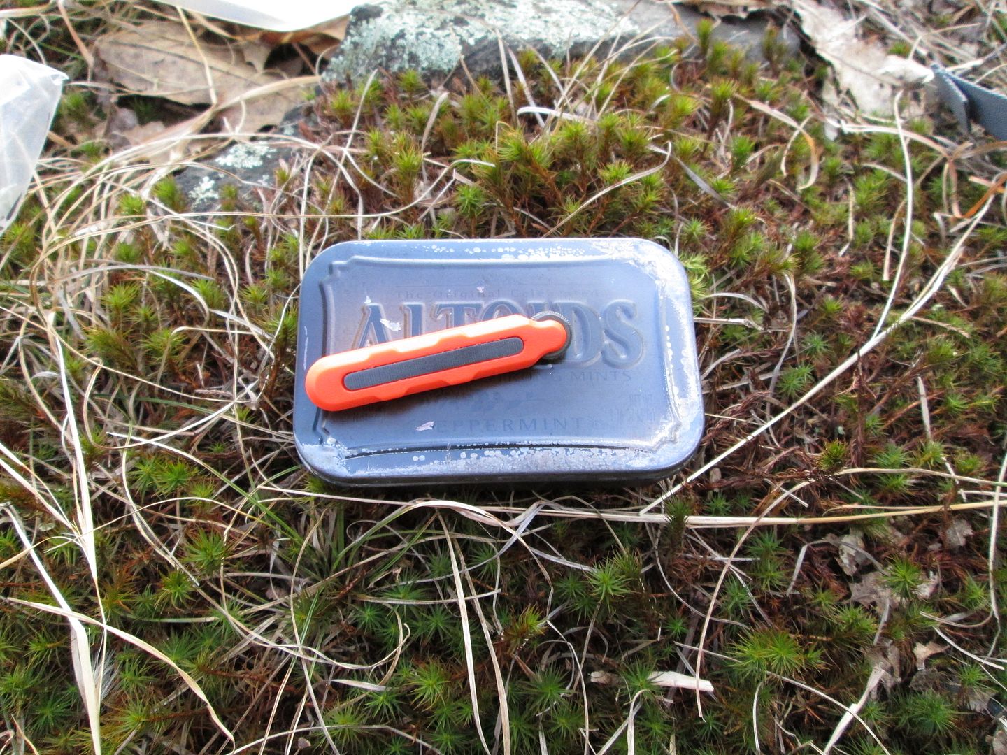

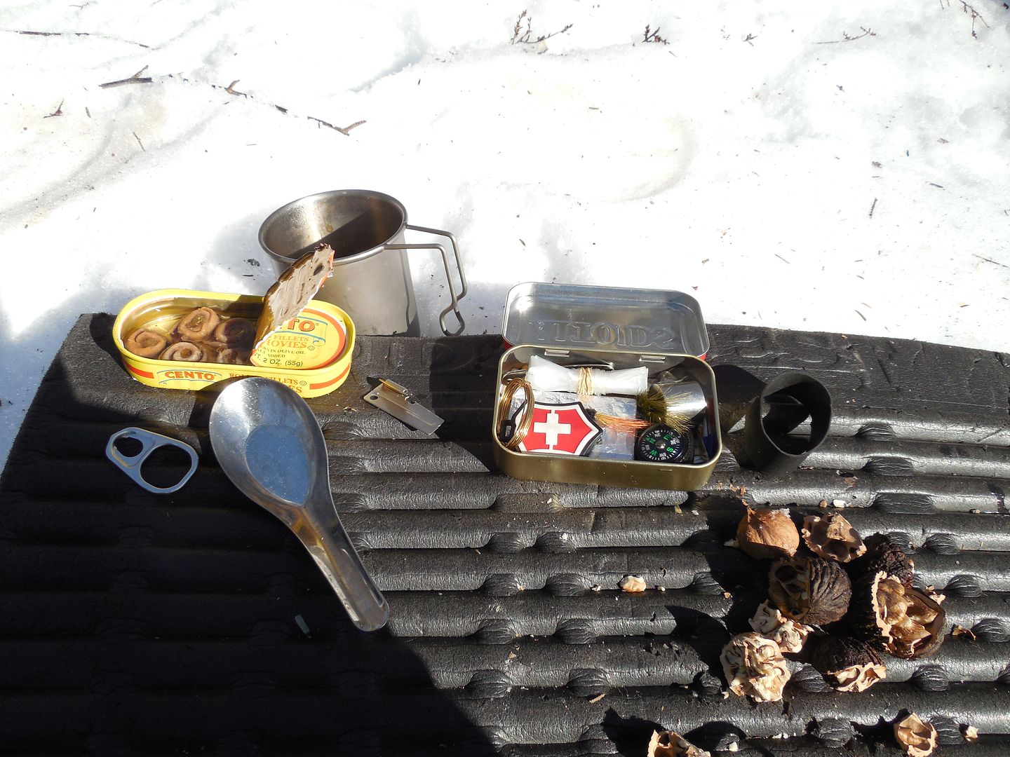

One thing IMHO people do wrong with an Altoids kit is NOT packing items inside which might actually be needed in mundane life. Here is an example from my last outing. The tab on my can-o-fish broke. Used the little can opened in the Altoids kit.
Speaking of things walking there was some compressed cotton tinder which vanished for that pic. Took me 5-minutes to see it somehow rolled out into the white snow. Another 10 minutes to then find it. Wire is also an item people sometimes over look but can come in useful. Got a little roll in the above Altoids. The green wooly bugger fly is deadly on a line if yea want to add fishing to the kit. But because it is such a good general purpose fly (unless the trout have keyed in on a hatch) often I am in short supply. Must have replaced that fly a 1/2 dozen times. Works on nearly anything with fins.Thread pre set on a sewing pin has been used and replaced a few times. Anti bacterial packets have been used and replaced. The Al foil has been taken out and used for a makeshift pot lid. I have used and replaced the two Micropur tabs during outings. I also dumped the little SAK. It was ok but for harder use it wouldn't cut it. Couldn't toss sparks from a rock. Would from a firesteel but needed to use the little blade. Then again I could use a sharp rock. Still more options is always better unless those options are all bad. LOL! Now use one from Wolf Creek Forge which could be hafted to a larger stick or grasped with the hands to do actual work. Also have a Tops/Turley model 23. Being a skilled knife maker you probably could or have already made such a smaller flat knife without scales. I use painter's tape for a sheath to save space in the little tin.
In anycase if someone looks at an Altoids PSK like a small possibles tin rather than a fantasy zombie apocalypse PSK or Man vs. Wild thing other options might be considered which may or may not be of greater use.

This is what I am referring to as the Minimal List PSK:
I do carry a water bottle anytime I am in the hills, so the suggestion to replace the water straw for Sealed purification tablets would free up a lot of space which will be used for a small bic lighter, heavy duty foil will be added. If I am spending the night I don't want to end up with Giardia, If I run out of tablets then I have crossed that line of care vs survival. When I have a small bag / Camelback I will throw a poncho in the bottom for sure!

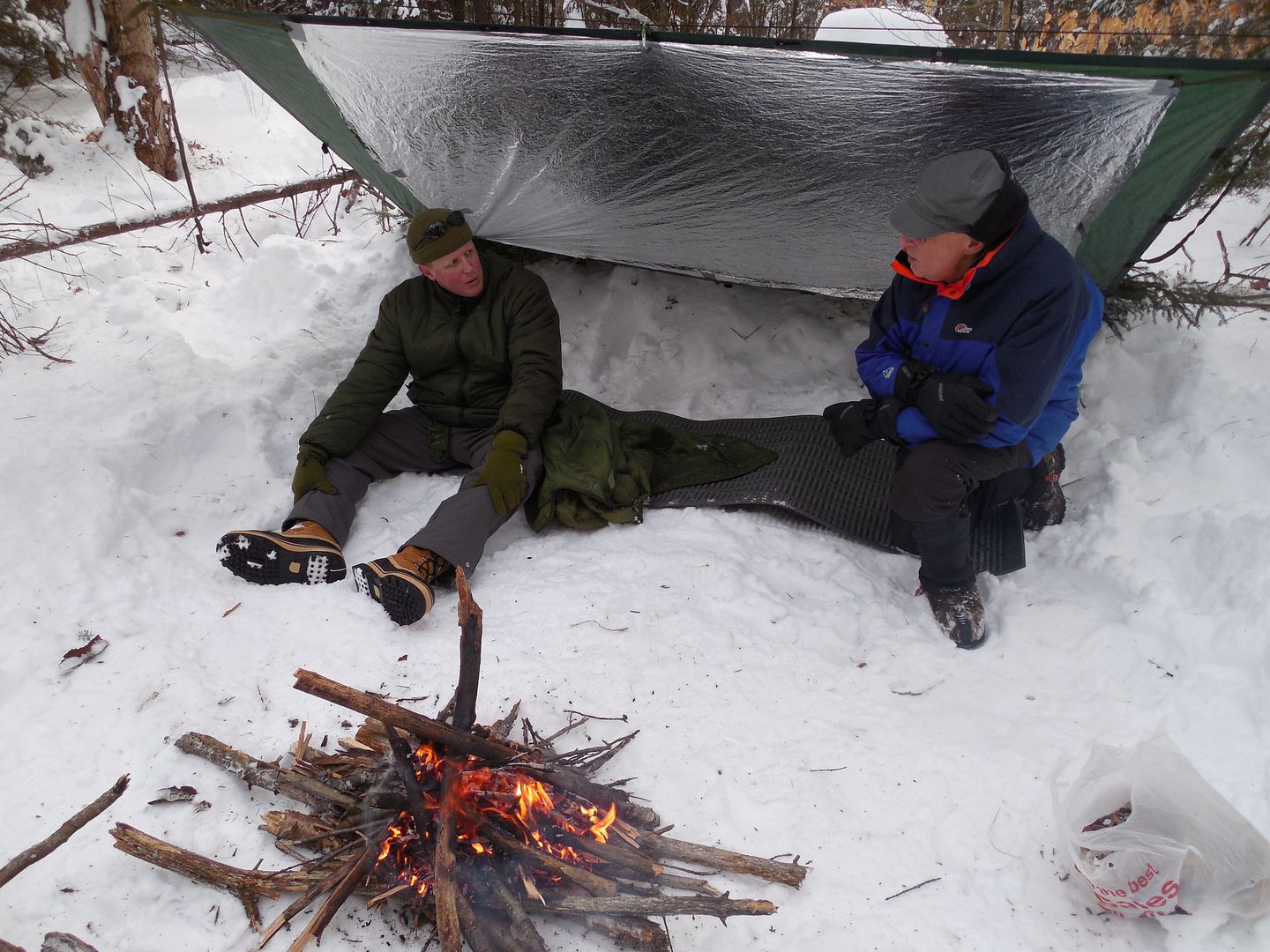

The items from the minimalist kit could be used in combination with your packed poncho to reflect some extra heat as we did here. This Mylar was part of my larger PSK but the Golite poncho part of my daykit. Chocolate and peanut butter mixed rather well.
