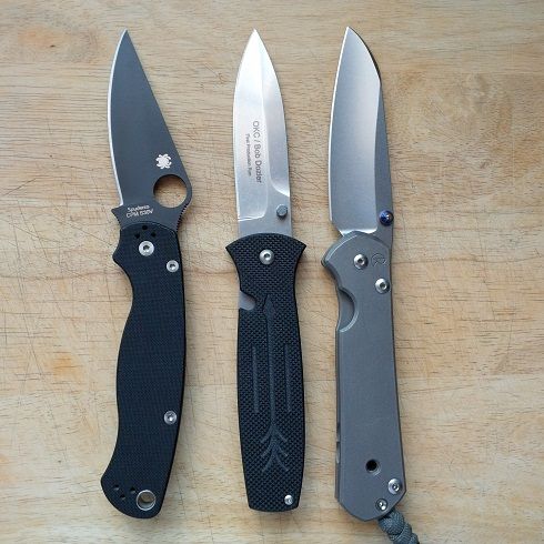

The OKC Dozier Arrow: I dig it... :thumbup:
3.6" stonewashed hollow ground D2 blade, solid lock-up with zero play, good fit & finish, smooth action with an excellent detent, super light weight at 2.8oz. There is a bit o' flex to the linerless G-10 scales, which is to be expected, but it has no impact on the nested liner lock bar where it meets the blade tang (ie. no lock slip.)
It's a nice compact and clean-lined package--kinda reminds me of an OTF auto. No blade spine protrudes from the handle when folded, just a hair of the lock tab shows, but for some reason Ontario chose to bevel the inner edge of the handle scales on this side. This leaves just enough room for the meat of your thumb tip to touch the spine. Perhaps this was done to discourage sharpening the swedge? I don't think that a double-edge on a light duty folder like the Arrow is a good idea anyway, but that's just my opinion.
A few nit-picking niggles: the G-10 is the same pocket-shredding texture as may be found on a Cold Steel folder, I find the pocket clip is oversized (but still comfortable and functional--I like that they stonewashed it to match the blade,) and the arrow on the handle is a little cheesy. My particular specimen has a slight blem on the secondary bevel near the tang, but that's being super-picky.
Here's a pic for size comparison:
Spyderco Para-Military 2, OKC Dozier Arrow, CRK Large Sebenza 21 Insingo
Overall, an excellent piece from Bob Dozier and the good folks at OKC! If you like dagger grind folders, this is a
fantastic buy. The Arrow is the knife I wanted my LionSteel Daghetta to be but wasn't (at twice the price.)
Anyway, hope this helps some who may be on the fence about picking one up...
-Brett
