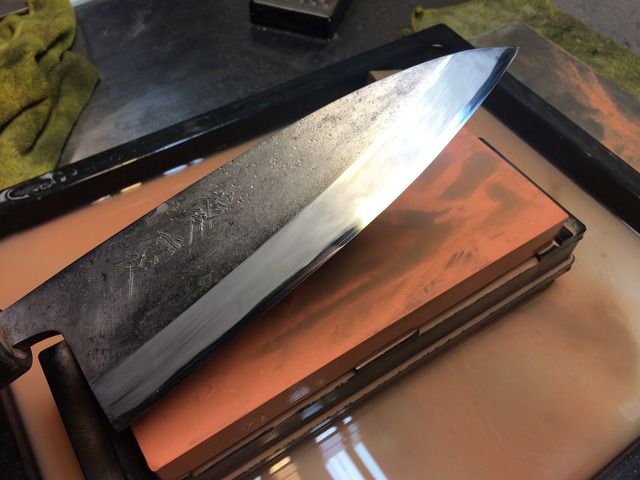

Mud on a stone is only useful for large bevel polishing, like this...

Higher grit Shaptons will mostly load with steel and with good carbon steel kitchen knives or chisels they will make black water and have minimal loading. If you want a muddy finishing stone the Cerax 6k like I have photoed above would be my rec.
Jason are u saying better steel will produce black water and shit steel will mostly load?
Doesn't look like Cerax 6k. My cerax 6k is a white stone.... Wrong pic maybe?
Other than that i agree. Really like the cerax stones. Nice creamy mud. Fun :)
Hmm thanks Jason. Didn't realize there was a new vs old. I guess I have old.
Are you familiar with both formulations? What's the difference?
I think you have the New, mine is the first gen Cerax. I don't know their differences.
