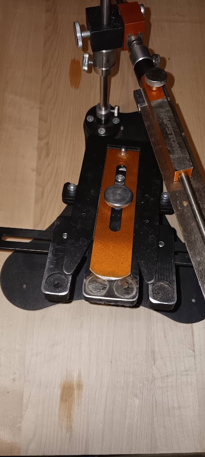

I was very fortunate to receive some guidance from a fellow member who had purchased several of the higher end systems. He recommended the KME sharpening system. After practicing on a few "trash knives", I finally got the hang of it! It seems to be more than good enough. Just be sure to get the pen blade jaws for traditionals. It's pretty easy to set the edge angle to your liking. You can always freehand it from there! Hope this helps. 👍🏻
Pen jaws for the smaller stuff:
