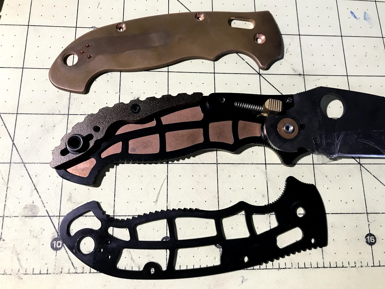

Realized that I didn't take any photos for the addition of the ceramic ball. I had a Manix XL I wanted to work on and do this mod to. So I took some photos. I will put them in the next post.
First of all, some back story. I love copper patina on knives but it adds a ton of weight. So for this Manix XL I decided to embrace the weight and make it as chunky as possible. The opposite of the Manix LW.
Added Copper scales, brass thumb stud, titanium hardware, titanium lanyard tube, titanium pocket clip and titanium backspacer.
Fresh out of the box weight.
ACtC-3fmnrvzMemdmz0T0z9jyNlQHVqUffkkLoje7jyZjzMjk_NvDCE6yoX9mQSInRsSwxNM-HAN0PZbdiPseJBzF_EWz2uaT6-TJOlCuB4UTBjjZkGj7a7ibkHWicAPVXa7CyC2BuJBgGNCv0QVvdSlD0Vkwg=w1251-h938-no
Post mod weight. Almost doubled the weight, reaching over half a pound.
ACtC-3fHy0-IleL1tlYI9yW8d-nkFlnuz-AlBSenhEgsDeoMWYm2pyIAYhKjp_HR7a4cQtkbp2qSCq2vTP1s0rIfO7dhpT5FayQl3QCnHHy3SjaVChZN0odRh9FY5VIbk1W0vlNW378KRu4tui1SdB_YLh8jpw=w1251-h938-no
I love this thing.
ACtC-3dVq9KbMidwg9gUqst9AqiGXn-oUVAVz5vCEP--hzSqLjNlnAcBi8TgR7xjjn2fXPeC9yR2jbbmF2-KpY_8UN9j6fKc52DEbazOGodxlha4mqponi26cQp9pYJMTgb80UEq4Imme-IhFX4ht74EFxo4HA=w704-h938-no
ACtC-3ck1dhx0bIWQ2MGwOdhP4E2e7zZR4aRt5_BjorJJWmR19CjP1ObA0DmKlpCQwa3PmdIGyN8EZbu7PGrpLLmdKDwgsBtEyc1hFMbWv49jIEHz7s0Bm_MaDlQEgO8XJIBVXyzqvjsNb9GoybGj0SuW0yb-w=w704-h938-no
ACtC-3cCQrU91rpcaljp3XrwnqnUKReJAyUpFe-uFZczFdtL557NkhDrBO3g3RPemti68lfGjoh0PKJXw31SfLPCRJN41w2ydGF_FaTtH0nr8NPAbfWSYnlkAEyxqlNDbl1WU0_Fj2SHjRey2AjsTjmDJ5oq5A=w704-h938-no
This thing is a guillotine. Drop shut like crazy.

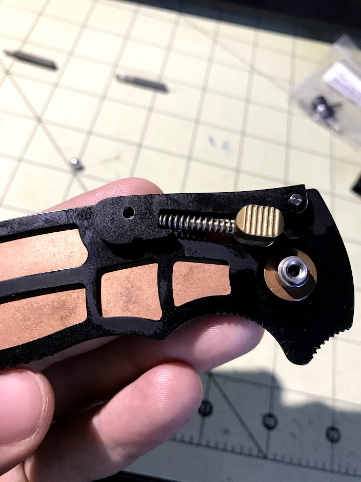

Step 3 - Prep 1/8" Dia. x 3/8" Long Barrel Pivots and Screws
The barrel pivots I received arrived like the one on the bottom. The screws were a bit long and wouldn't allow for a snug fit with the scales. I filed the screws down to make a tight fit with the existing washers. I made sure the screws had at least one diameter length of engaged threads to achieve maximum strength. The final product is seen on the top.
yUfcVM8cV8fSrUUQrahuyCik5k6nFeL5YGi3rPeaoFmgfHUt-cN1URPmRtcR-VcVYFr5UOssnG_21dIDmsXtf6pjrPVF4ibPQjjEJVOK4xwsGeyTBQmAwz6MaRF4BEZcXN6FQ0AFos6aoOl358OdlYRSoSDkgunnGBOmdIFCcAcwELvxdZ4PZH4kJFw7ymqLFCH3hNtm2htq_rNS0g4JOxFNULf6hb8tGAaCn81KiZcBfCWNlekgtq9JpY3jn6mx9s2cXhpSwvqDsAaReERidBtAZ2GWdOHgcWMdwCOq7CYIPh9LmJ2xgowvKXDbNmeN_jyw8NsQZ10cHr0DGz7nGjfOttF391ydFk1sHwvucKti6LvXpmac1-GLkFakaUTdx6H-dZz_1UU2wFNxnTuz6C0BRxlzwyrYx-qU4pQQSHkCgGZoKjJxYdOyBDhVRVJ0Jl58lxZI0EcbU0V9j4DSwlPUbZnDnPQx-jspACJc3bN9vpC3zSvhVzbl_a5lXO5h5jRtnSo6Ogaoh2HEkGEpIihLTaRPuhD74IpsAqGjdnvdiZN91XvpGVkS_-X9CJTYwgZVbfwjTdCgygV3c57jTQOXTSlFk9UmOQisUdBKhExaXPLMQDW7S6YYp48WzIa7vYqJw3whJX6qUq558NeHyqybbzZhXP8VInophw1efG7MJSO_7fL3xYWKntOXMg=w1251-h938-no
To keep the screws steady while filing I used a threaded screw thread checker. I threaded the screw into the 2-56 thread hole and filed to the desired height.
-PDr0OHlRJ3kNipAHKBbvTgbNai5kPexJVDVXkstu5_GEk5uXwax0tzBgTslKNnxia4ZQ8Z1vkDTSyWEWtgQsTIzA0lDlq6kRRxbTHV3mhLaTGsNUzNA8syi3GeFtCnQ16Z4hdFrV8HlsB8xMbgHOBnbaKV90NJPvwdxhn4RKYhK_V8ypRSHXXTqIrr0bR1QWIfk_puPk0N4PFHEAgwBUbUMogwN48SiHSuRuZpcIttFmmKCFLFOExYIIUm3IxGFrqYdmp2TqS0ShhmxIZjo8B8OAUMJke4auDMj1cRPkfgEizJz8zc2n-DG1I2zZGldA5z30dJyn1c6Eb-mVW7YKO5obZJOaT-z2TzEAm7nf2UZcfNtv2UyT4wT54dWygOuGhcgy005K6KjQOULcE9GHQCYP_TsuZVaOKQL5CWTkdVzqcr6cACjEUbHDXNtsbQ2ej8jtgGVKEuT0mBqpd4xuFk-8FjX3JF1HbIF7iqpQHQestB_vKLTZjQOWMppSQuCCARVIJrw7pTEyCOPsYjuhnsQwqwlTVGwhXnsUZ_Ngq5bDpi3iwCPwCfXodKBf0XVphwyANZAzmaEcjvRny6u3fjIvHpHN2lMpFYu479zWo7Ny0NnG_ohlsfO8AVZxXwWPSCE-tmVeZKWLPRYkFG5XJXrPf6WCeninz3agMtqwtiz-oQRc5JwHBUOk7U88Q=w704-h938-no
Looked like this. Used a magnet to catch the shavings and frequently checked the screw with the barrel to make sure I didn't take off too much.
XhlwCq6JhvvczUw6c3oJ7ndM6mSjz8x-7g9l6muJXTF7XOxH-o2JlAOt499X5A_zN1H8HfNx_Fr1__KvqQr09CFgc0tF7qNsK0BOyrRJ93xh3lpBKLoUVOoUW0wE6zOhsvhcoQN1w0mT7okH0Cbi9vLXARgtVhdMm_gMxBPM45HkpuoKOAzfmNT269TwMCXqLD9Bb4k4m_qr4QSDT1aL3y3WfDCJG1eV25v9EuSD2jWKAGd_QmeGvVUkv2kzHtT1MpSOS0yX6J2TPF9YnDNDsyRo1VpuBY58ASPaDp4ibPWlKRn5l8E0zAqhzxXYvG3mRqfuAeJseExoR3_HEiVwsToa3IId7jo7vaIGrAd0_rohv8zEipArZf2Bokv29WLXuCsSEJyk5620fd8QvqXVHB0q-t5JL-HpgyVOacsrHJ8zpsC3hcn7TFI_qyCzzpNTbrjGUhSVhvkn2uWuuPbeYc7adYTbugxr9RCm9XBXPTs7-9cX_wTj7ctvOKMHvczrB1B_KRG3Y2EphGF1kythrOtLim7kptfcbycCQLx_DsIsF1OiWtl1NyhNp3IgU6u_tFv8OgjStZBQF6PAzLLDauFjXVBY2FHw-uaN5HSsAzTGroKc5jM3Sn9YcM6V5bXKAwrZCc9dQLujFwkaE1QaAJPWP3ANQ3Lg5zSt9AlSJkOuWNIZxTiYwNNPuaLDeg=w704-h938-no
I also had to shave down the barrel a bit as well because 3/8" was a bit too long. Used the unthreaded #2 hole in the template to keep the barrel steady.
J9QYVpUxuOCBmRL-k1OmwoPz4uiZPz6y8dFzMe4qnSXaql23Ce010INLwWMqZ8GR4LQ5KARgHaw4IaHkmGKpKT9LEYDd0Wbqvpvl81jwd1HeVQXQ5PI2eqbnlDoajTvvWgoEMgDoEMhlSt59yY5NDasKLopM2g7LRGHHYBZLmA7EdRzpfC-IPSSNv-8jEK_TC8FVGRv4Xzawblhmxrac5vHs9_qe0lvcckLyysTLP0lDDhJsqTvyce89JcfXEsJTNtpQ2ezJOLmYrecmRhjSMlXTYlAM7JofZVEOcuvrcXt9CIuav1Ac7xQnrTTGvnN3hsAk6Cc1wmK3O5GjBq9M6X_1thekliPudbO0KugCNjgDH3igcnTESh_H_qu0TFjj8klIW_YlcfGe8BkDYuc6POMoITWogoW_WZdKv9SOB_51OYlwob7xqRwD6ooIwCJ-42RFKINcjdMD2vDU7te5zC09bXOkWJyOXp3zNIaCK9kx8hRgtf-jpjLuP7sXuzZY_Zu0gul5d2teIqPNAmHUFBMhS4MYjpjb-3UW4VGIRiOs31EYZo9uM7ZXRl2u2q1jpukkBebmzifylBfokCvaROevnTIPxJt91QZJ80lM1mElowM_Kl9qyvbK0SBkJGuGan4sjKENm0cHWMsIMdYT3IWxM3ePU29Wk2hn_Zb_RrvTk4vG1F1XLLQGgTApCQ=w704-h938-no
Test fit the barrel to make sure it was flush on both ends.
PlKdKj2oEOyzNb0iwmh7GYTsARYBDYrz2n0GgP4fDWpye4QASLcTXbDnfpxg6PLQJnIo63FooHrr8N0SpSKxik4ia4PA39I9bx5Ia2FCvhKpNg69i-__vgoItaZUacIdDigmQpc4BCc33zuGv0W7hXNL1ezqyH1Xnz6DyoL-vf88b1I0JuZH2n1oAohH360S5qe83AHftz6HqRB5pkrS3Q8VsnkgIamjd_Ld3Su9Mf7cAVmNtjBm-PxNJKrvzXqF8-CsUdv5NDL44vvgy6JF695Sab-Mc49gf4PJ6i6taGZo-GIXsBQZF8AUdtc5TZ7qadogZqjFdm7rsFvaIOT-Omadh1med6252368roM3TQLWkfVDj3-akWyRZNw8puqC6dh6C8ikk-JKgqNBWebs4sdsddtG5qKcKCNFuU0Sv85HEH71ACMs3Gkk4_zi_wQPHnkH_RQbOg2w5g_Uz3cip4nJmzDnda19xBj_cFPWfAKtlusD8V35q2WdEqWiIADJRhhRHGn0ZHcfnWv9p5AYbbK2odbNrTg0HLBPbXum3FX2NO3q6Hcz6drQ_2sUiLShmZzXL47do387r-P4diy8v45PaT0pX-G2WtVUEGQlfgSR2COwD2wRSYY7_drcHd_meesyhAWt3CHfYBPui46tFA_7tf3Y562UutyUD4jalVVp-zwxepQ82Pp6lUMwHg=w704-h938-no
Lastly test the fit with the salvaged washers, screw and barrel. Make sure the screw is applying pressure to the washer and keeping the scales tight. Also be sure to de-bur all your screws and barrels before finishing.
KuPKqYRKRmiAne7jz0lOf1dreAHZVLVisCj7dTl0Nu7inUpI6zxPFiWwYKk0pwiNZjQSCJLKLo4d5Twyey77qkl0q5OPSjR6ggWhKZ8rARaUk-dBHG8c6Dcsq1hJMrFHv0BN6nBlXBoBlu82nAz_Paobkm8AbZUPe1roJB2ZBrLvs5Fvg9EPLJiSQyJ2K_kLY-n3Nfo0Io8eDcy0gHZxm_bN6z0kimiO1_O6RsXMVXneLV3psdcgs42-02w6oLpPxNB6fKX8UoCkL50DLYJ9rgcj7PTnuhlWPw4HwgFHX7pqvQPdLsTD9ZY5x-Ck4IWgtqoDfieiWTBYlGYx-OTGVNad2d9lGJ7HzRTrpsMbMew1h9UFezICCKjl6SqenIHPLLR3LRNxJTchYVIhUljYtnxaTm8D-91QFY7bt65Es2g-pNejdMwRcJwJL7r_AVIMyCAbrPZMm_A1lF5TjgNCC3T_O7HnIfJl67yQFU7ouzsW7WFut7X_uF3jPI58ztJFN7LmuD0AIC82FXdd2qtvO7KFBvicTbWHzKpYts6u3amE3ZiuRU8ySVPeK0BAZBnnBJqH_3aYPt1ZZbdFjB0laJAJKdWPjGtfkIcJWC_1ZBblglO_5i2h_4JZy3zT78aeFtR3KEzC0sLyy35k3fIFq_cJ6OalVvaq7jP6A6k_Y89KJ7ejzvdpEvMHUTzddA=w704-h938-no
This procedure went way smoother than the drilling of the rivets. Took a couple hours of hand filing and test fitting but the end result was pretty clean IMO.

- generic M2.5 washers from BoltDepot.com. I hadn’t planned this ahead as I figured I’d play the washers part by ear. I have a bunch of Metric hardware that I’ve gotten over the years from BoltDepot and as it happens the M2.5 washers are a perfect fit. Nice and tight around the #2-56 screws
I ground the rivet heads down nice and slow without doing anything to secure them from spinning. Generally by the time the rivet would sling it could be knocked out easily with a punch (might have to remove some remaining metal with a pick).
Definitely best to cover the knife up while working on it, but careful when securing it. I smushed a bit of the FRN when I tightened the vice too much & didn’t notice this b/c of the tape covering it up.
For the difficult rivet - if you don’t have a grinder/don’t want to use this method a small file can be used as well. It wouldn’t take long - just remember that the back spacer thing & double-washer guys are set fairly tight on the rivet so don’t expect them to just slide off. Light taps with a punch will do the trick once enough of the rivet is removed.
Oh - and for the pivot screws: the way I secured them was by screwing one screw in (with a washer and tiny amount of Loctite) ~2.5 turns (I believe 5 turns would bottom the screw out), then inserted the barrel into the grip, and then added the other screw/washer combo.
Hope this is helpful to others - I’ve seen fairly recent stuff where people aren’t using the best type of hardware b/c they couldn’t find the right stuff & don’t be discouraged by the mod!

Here's a person using a dremmel on the rivet heads might be better than drilling as the plastic gets hot and rivets spin.
Combining both posts here and the Drexel idea ill be doing mine later this week when I have all parts here.
If you keep your original ball lock consider cutting or snipping off 1.5 coil to ease action. If you take off more you can stretch spring a bit to make up difference in length.
Happy moding
