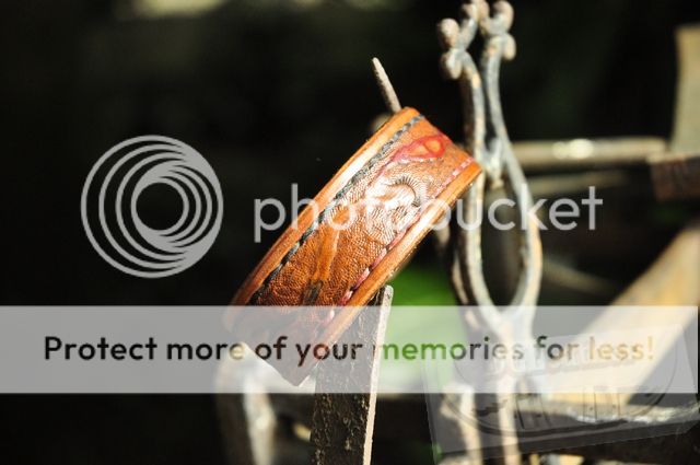

so, here's the new bracelet... just some minor changes to the previous one. this one fits for example.
also there is still a lot to learn... like the fact that the edges don't take the dye that well when you burnish them before using the dye.
I'm also not quite sure as to what to do with the stitches on the inside, though they are not uncomfortable.
I also didn't glue the top piece on evenly... but you can't tell from the pictures... :)
Possum, if you burnish with Saddle Soap the dye will penetrate it pretty well.
I'm not sure how you stitch, but it looks similar to mine. After taking some measurements I mark the stitch line on the inside, then groove the line in. I then space the holes with an overstitcher wheel, then punch the holes. Shark is soft enough I don't need to groove the top. With snake I groove the leather under the snakeskin (before cementing it down), which helps get the thread in a groove without having to groove the thin skin. If I was stitching two layers of leather I'd groove both sides, starting with the top.
Hope that makes sense.
thanks alot for all the input, and yes, it makes sense, the top was intentionally not grooved. but i will certainly have to groove the bottom in the future. otherwise our process is pretty similar. i'm currently lacking a decent marking tool (wife imposed budget constraints) so i am using an adjustable stitching groover (i am lacking enough practice to trace decently ;) ).
and about the saddle soap, i saw that tip in the pdf posted in the edge burnishing thread, already made it to my wishlist.

Next bracelet is done, edges took the burnishing well, however, due to the fact that I didn't preform the bracelet, there are stretch lines on the outer part. I think horsewright mentioned this in his belt thread.
I dig the color and the finish though. First bracelet with the whole deal, wax finish, coating etc.
