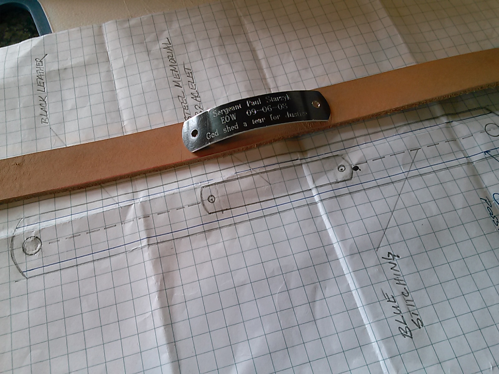

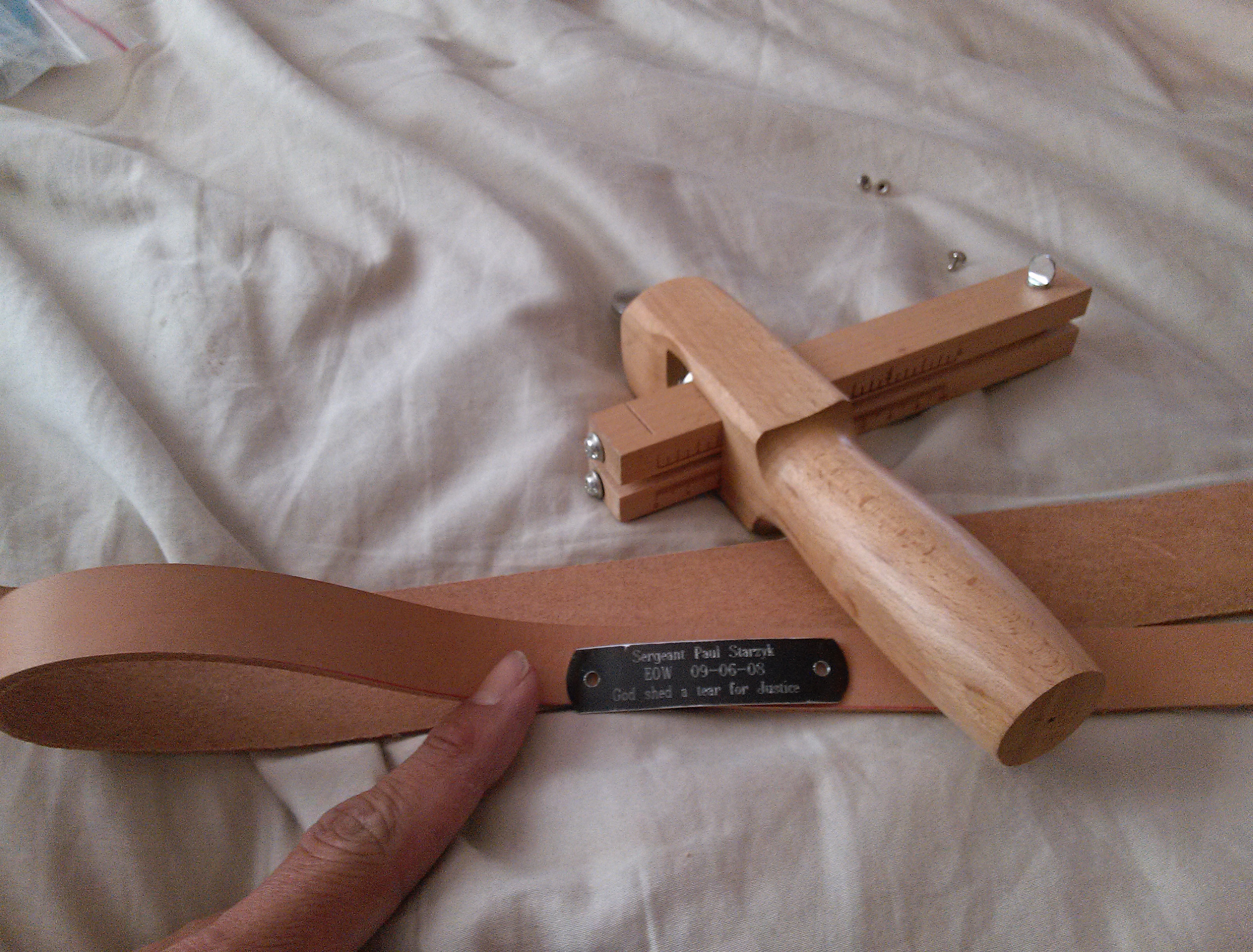

Jimmy, as is his custom, sent the bracelet along with a detailed drawing of what he envisioned for the final product. I love when customers give me some input on what they want, and Jimmy is always up for suggestions.
The idea is to rivet the plate to a 3/4"x7" strap. A Sam Browne stud will provide the closure. He wanted it black with a "thin blue line" stitched down the center. I asked to line it and we agreed that it would be nice. Originally I was going to go with pigskin, but I like the look of emu better.

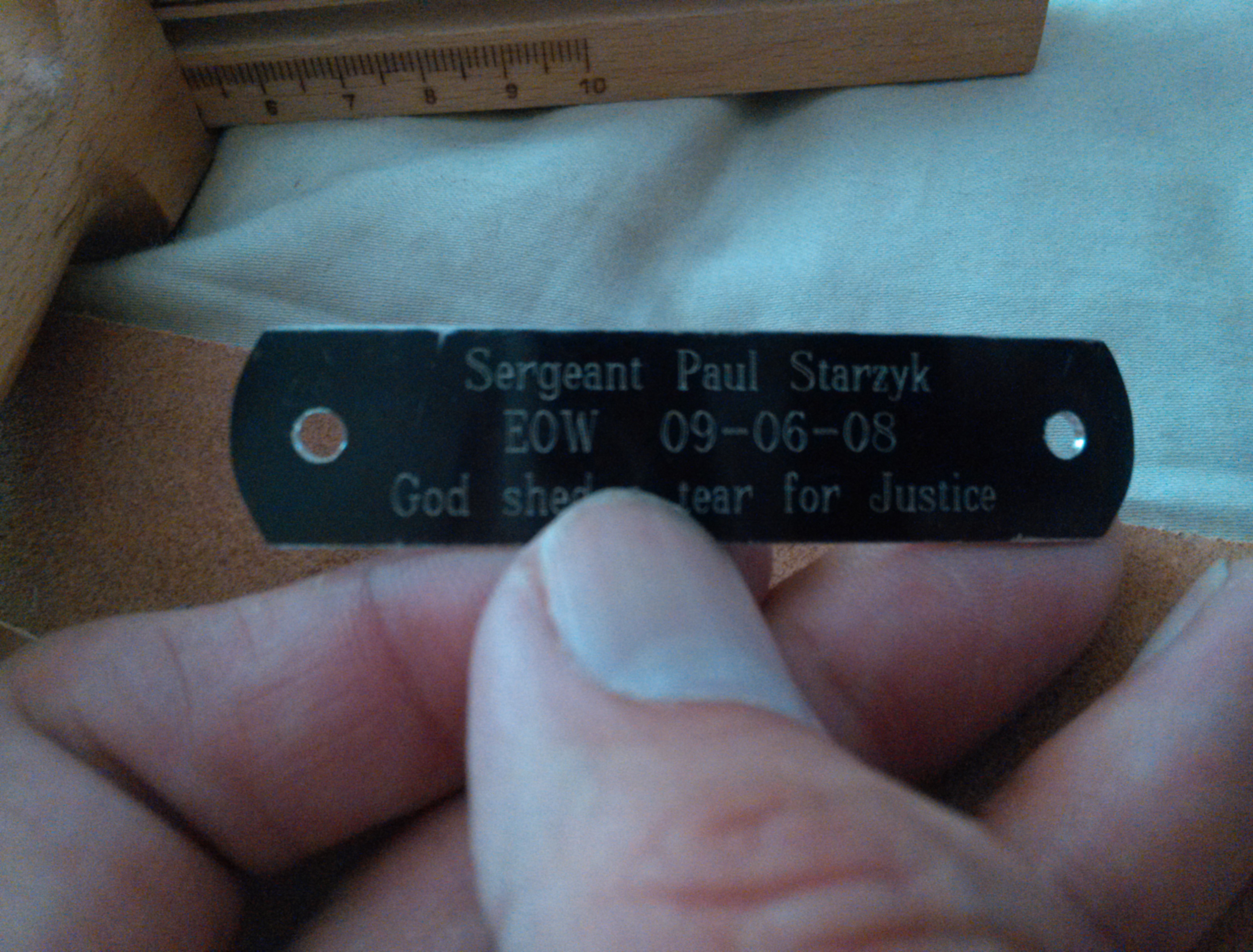

Design drawing and metal bracelet.

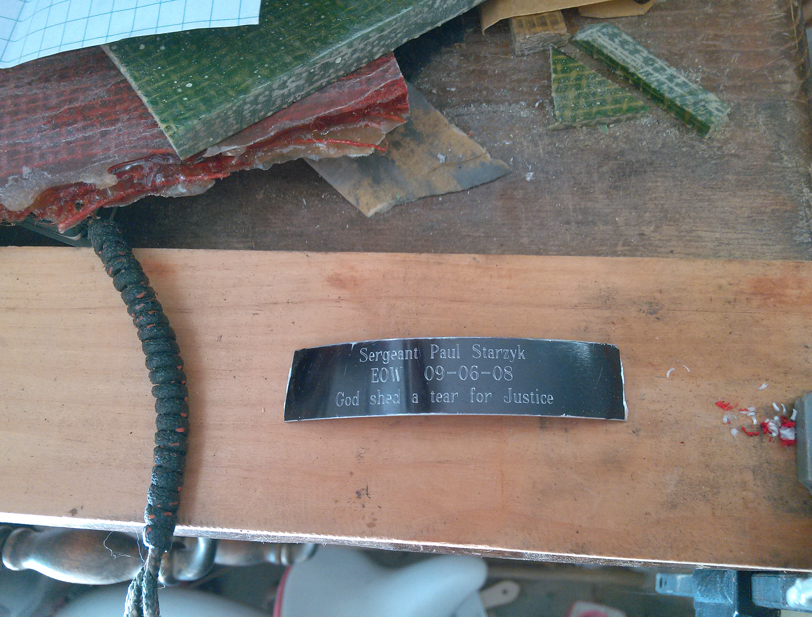

Cut, drilled and edge sanded.
3/4" strap cut and ready.

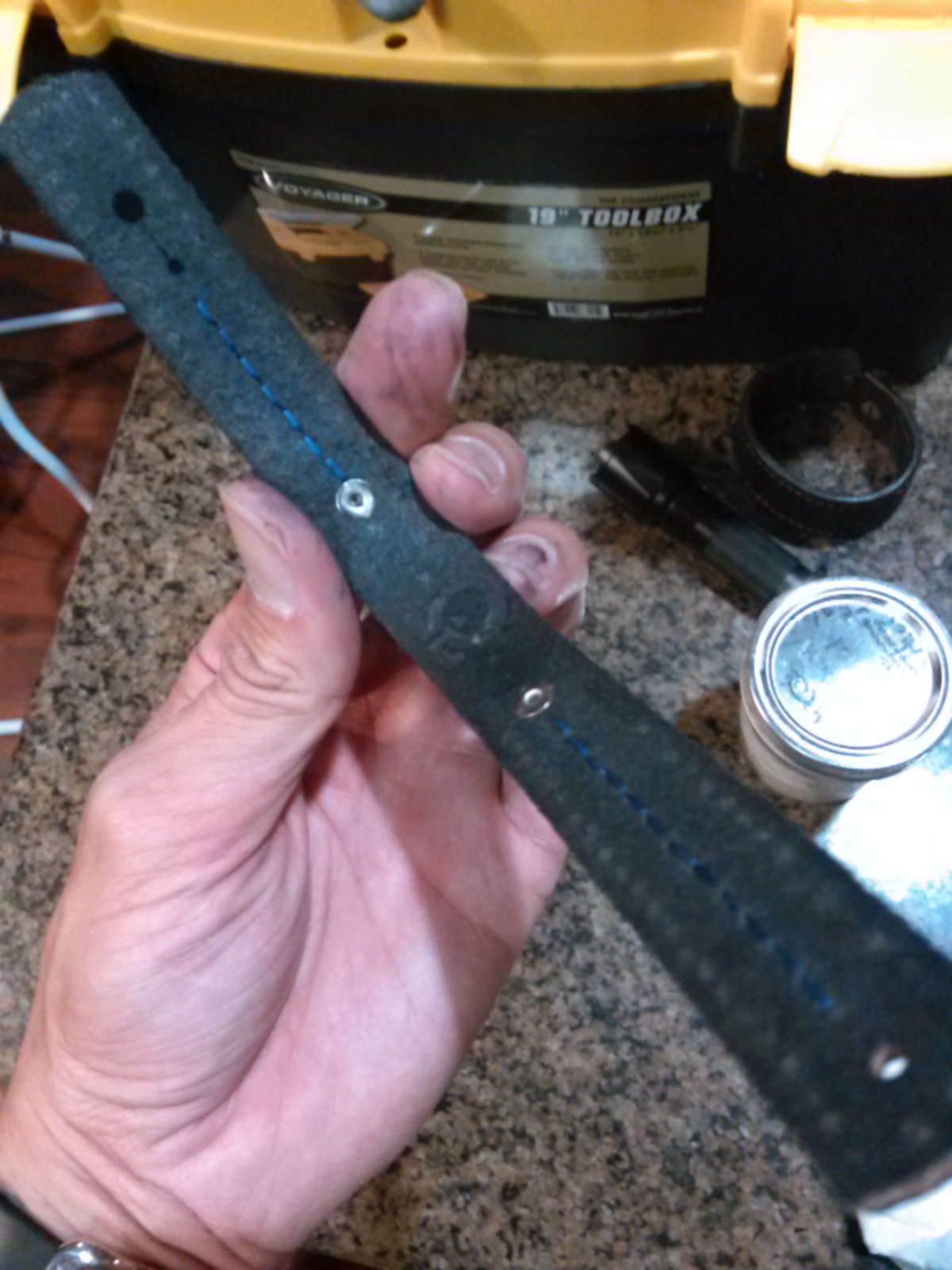

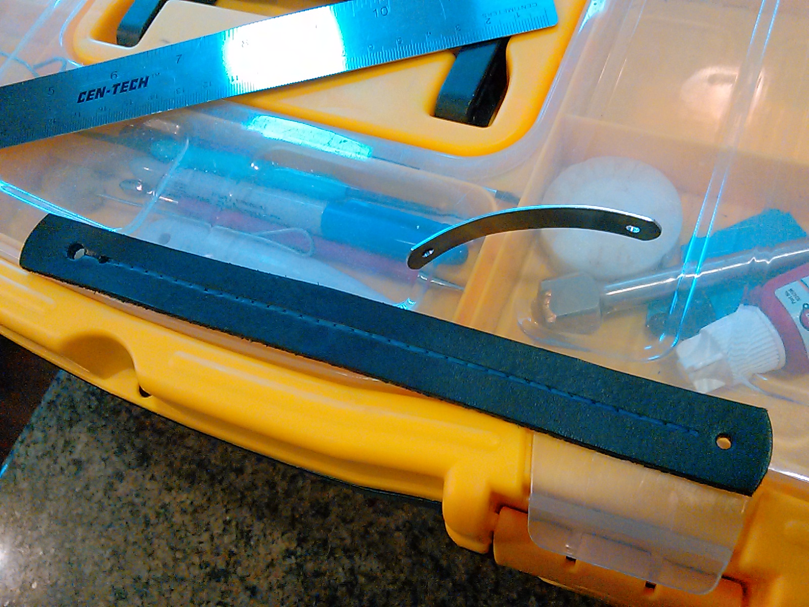

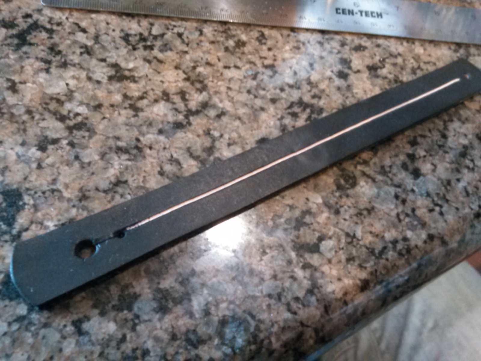

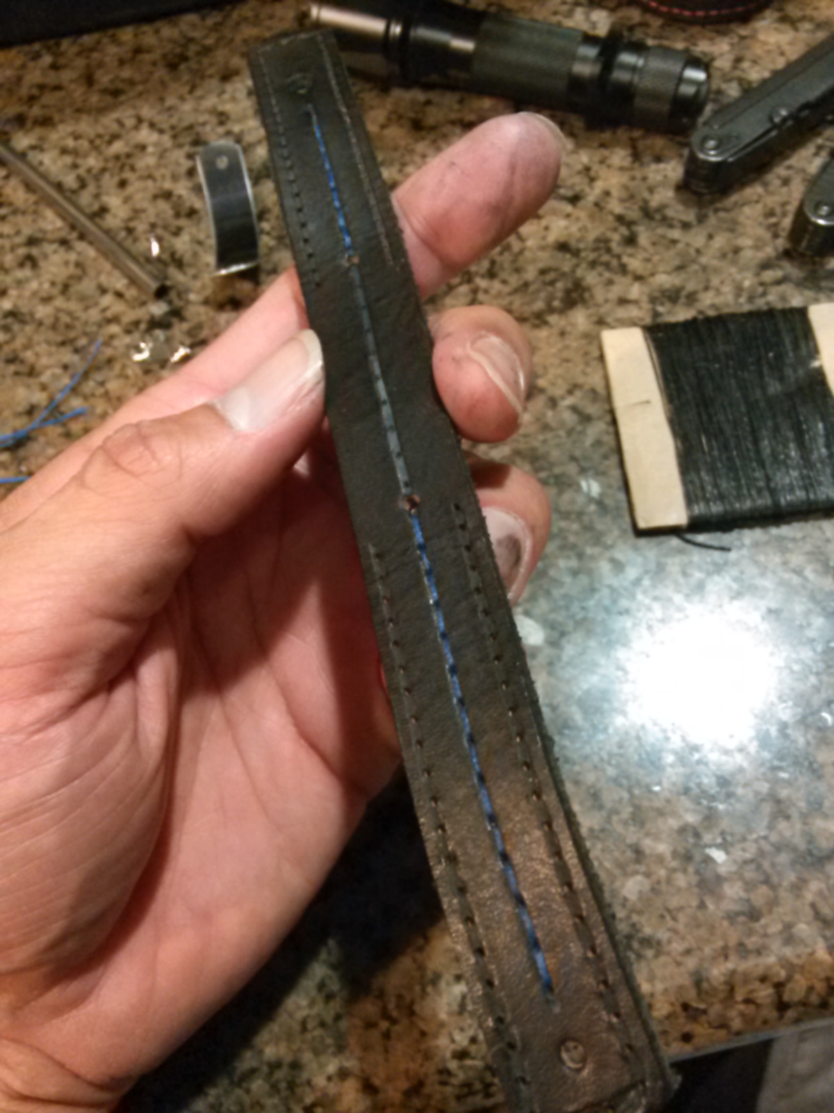

Dyed black. After dyeing I groove a center line and dye it blue.
Blue line and spaced for stitching.

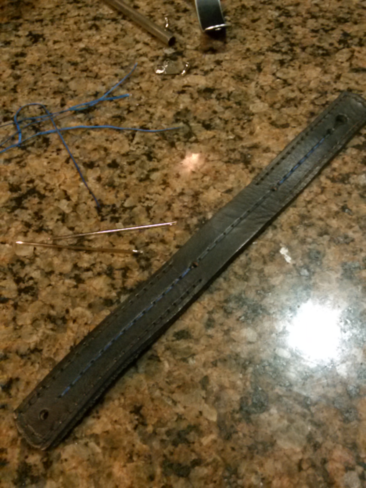

Grooved for lining. The stitching won't go under the plate as I don't really have room for it, but it will work nicely. The blue stitching won't go all the way across either since the rivet holes run right down the middle. It'll look like all of the stitching goes through though.

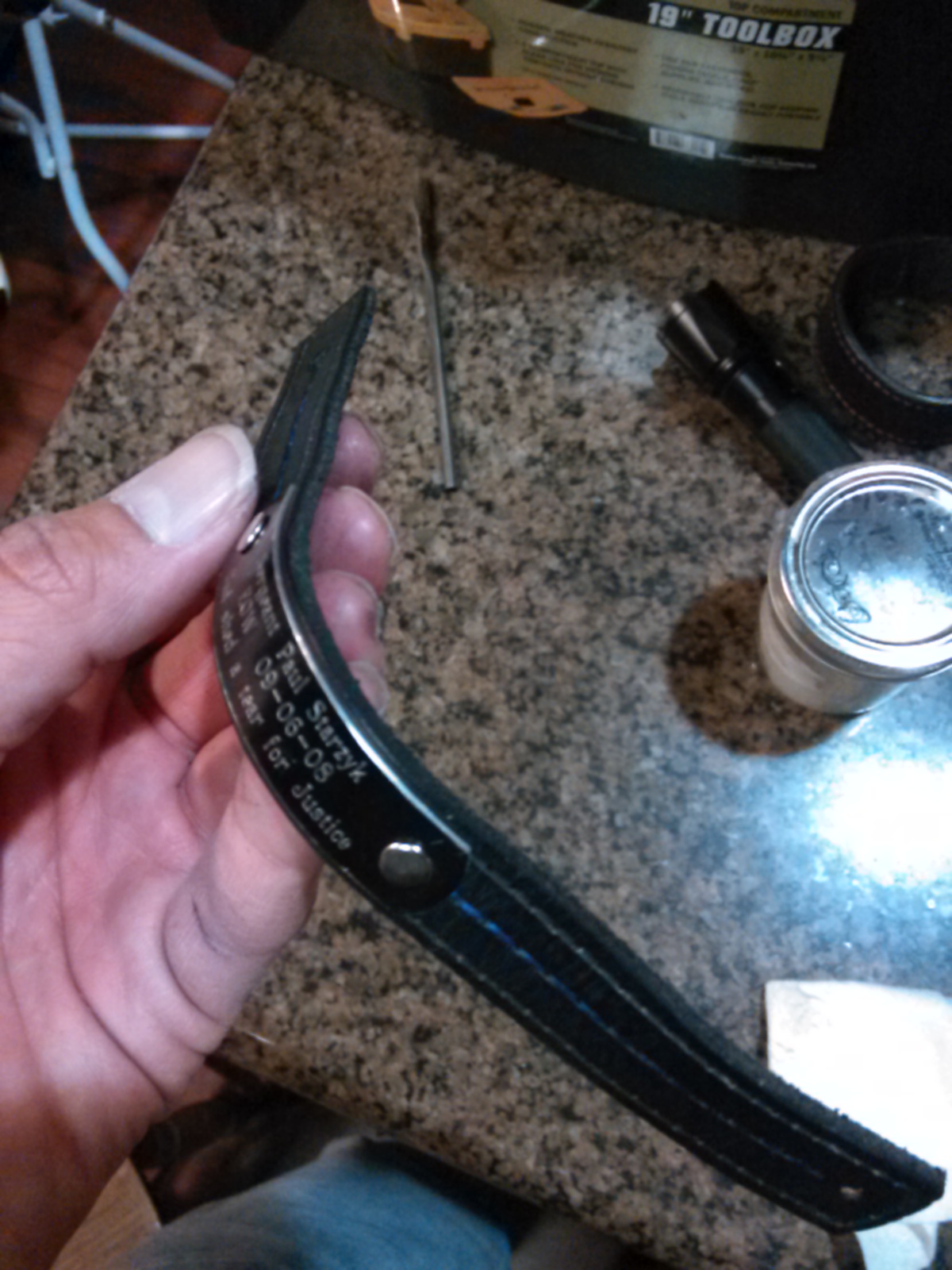

All holes drilled and blue line stitched.
Plate riveted.
At this point I need to install the stud, then cement the liner on. After that I'll redrill the liner holes and stitch down the emu. This way the center stitching and all hardware will be covered. Should be pretty comfortable.

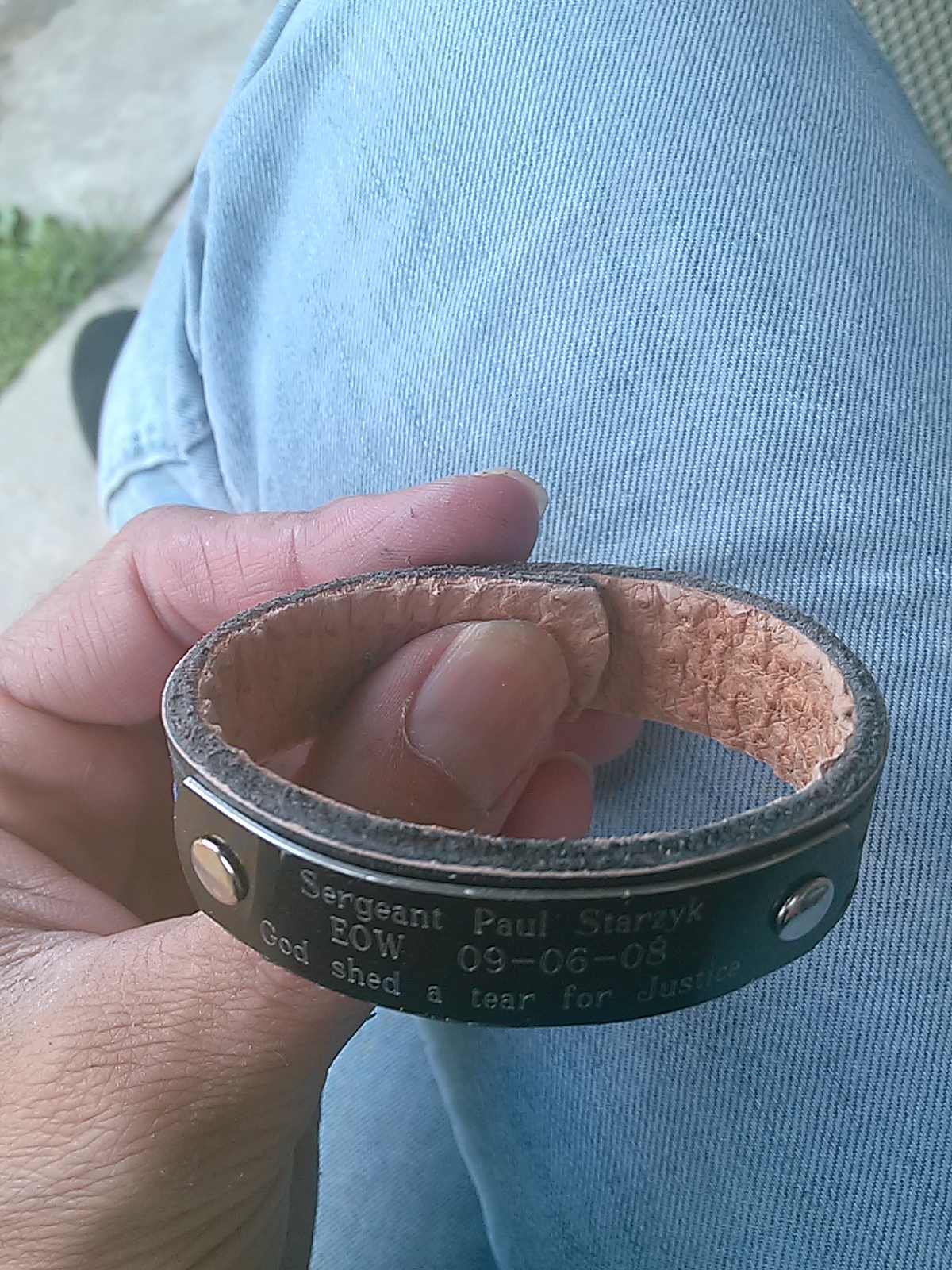

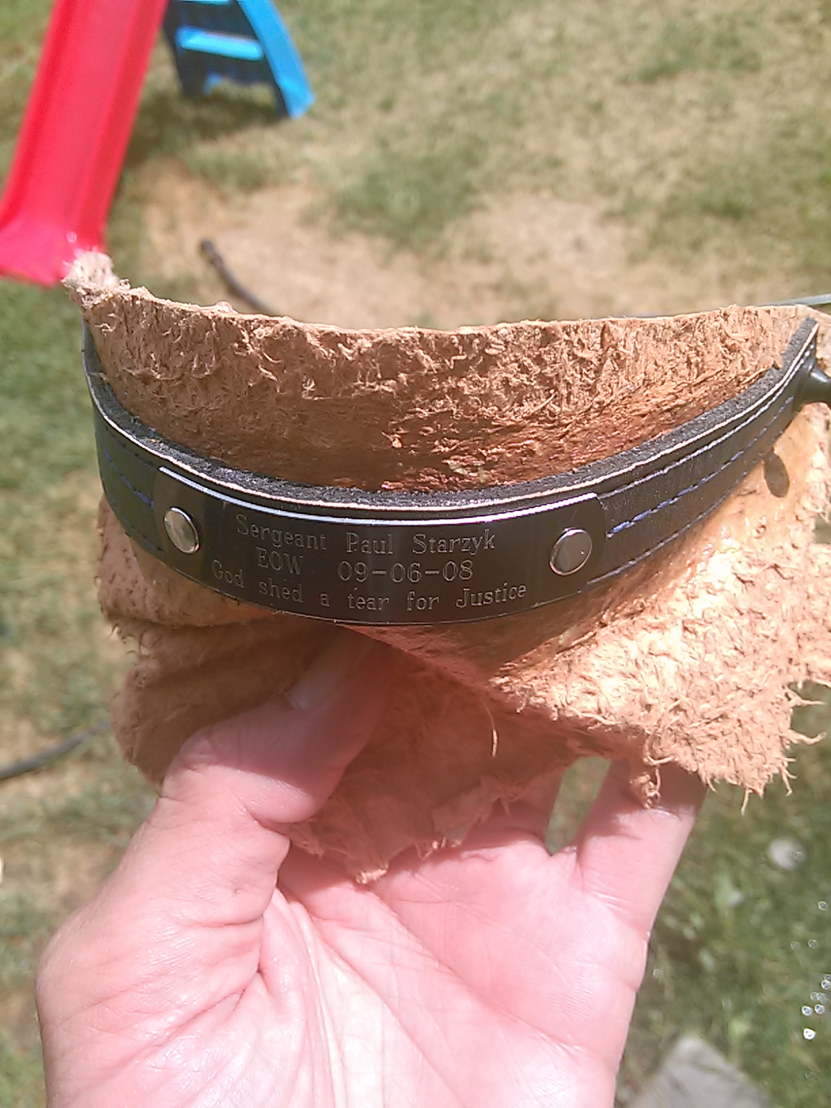

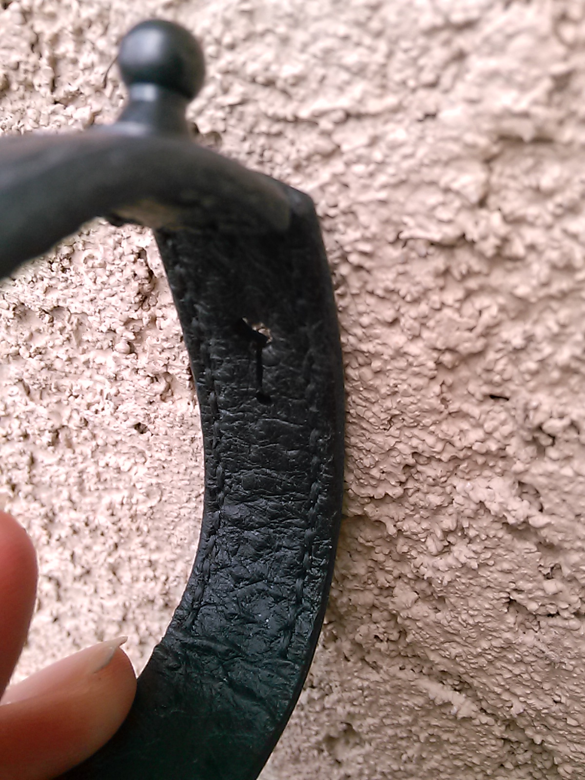

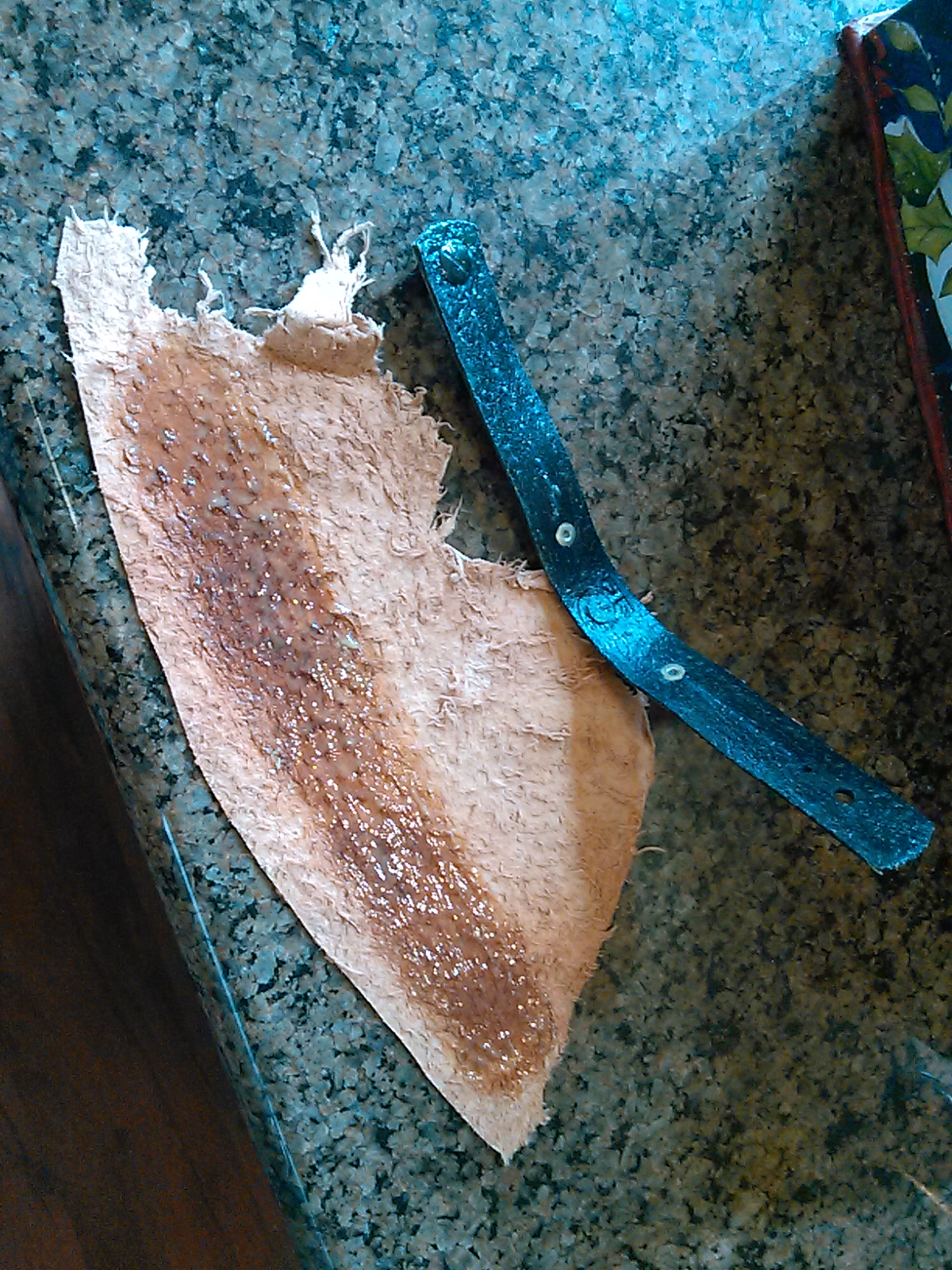

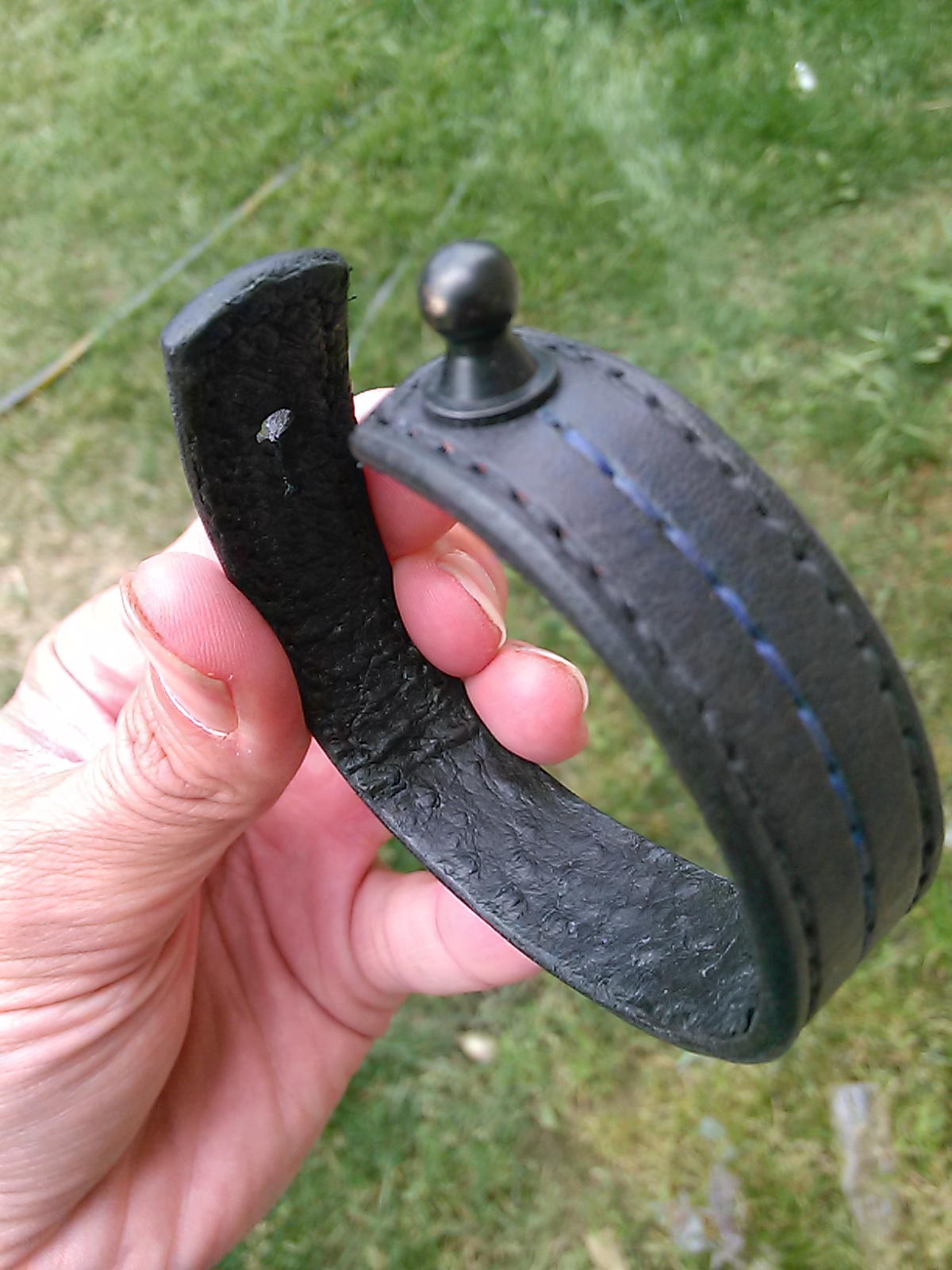

I'm really liking this emu hide. It's like ostrich, but better in this case as the quills are smaller and closer together.

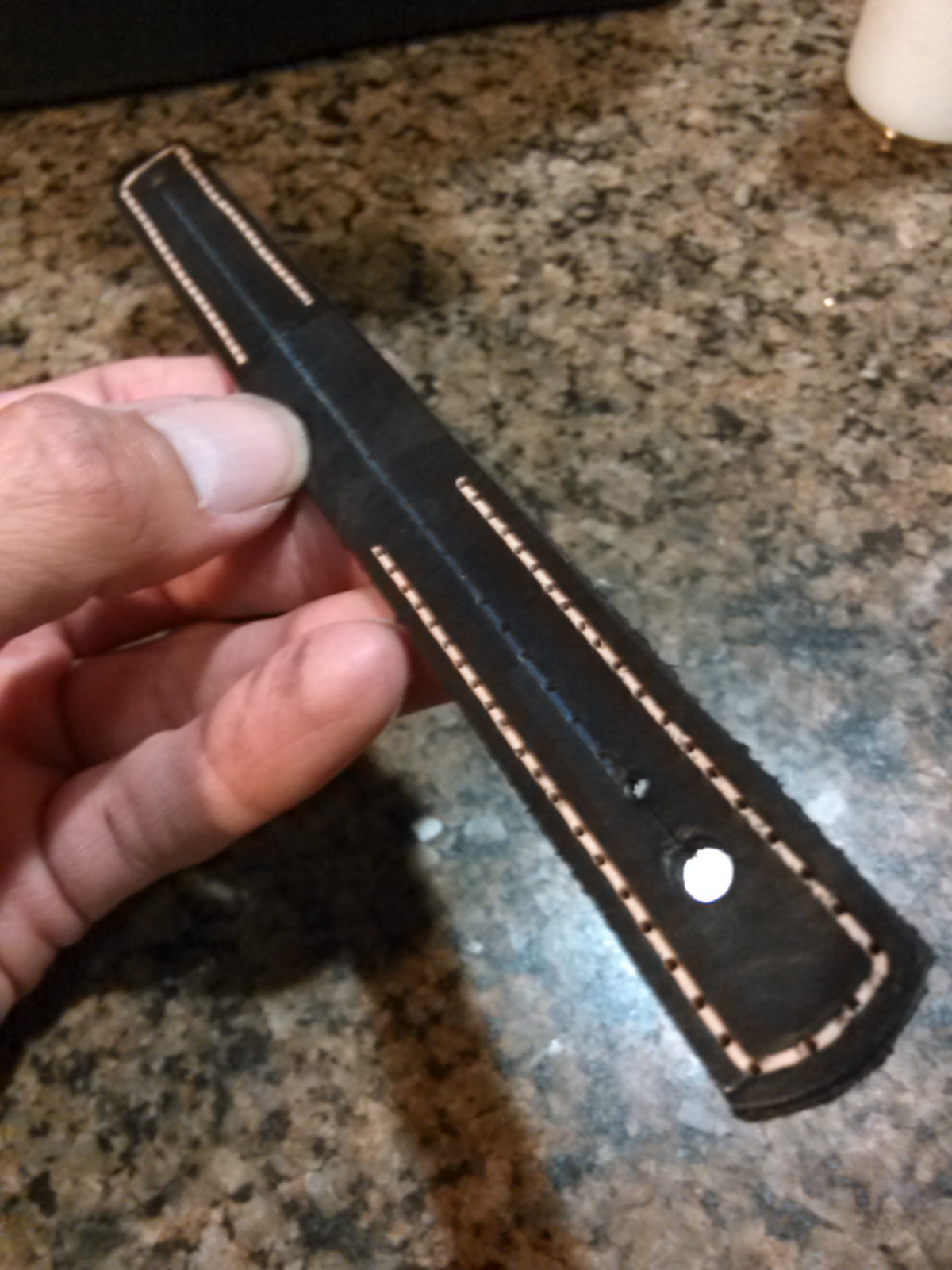

Glue up.
Trimmed. Also re-punched the holes for the stud.
Next is sanding, re-drilling the stitching holes, dyeing, stitching and finish work.

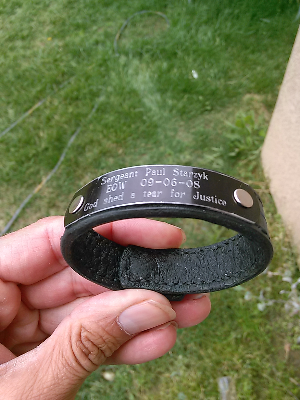

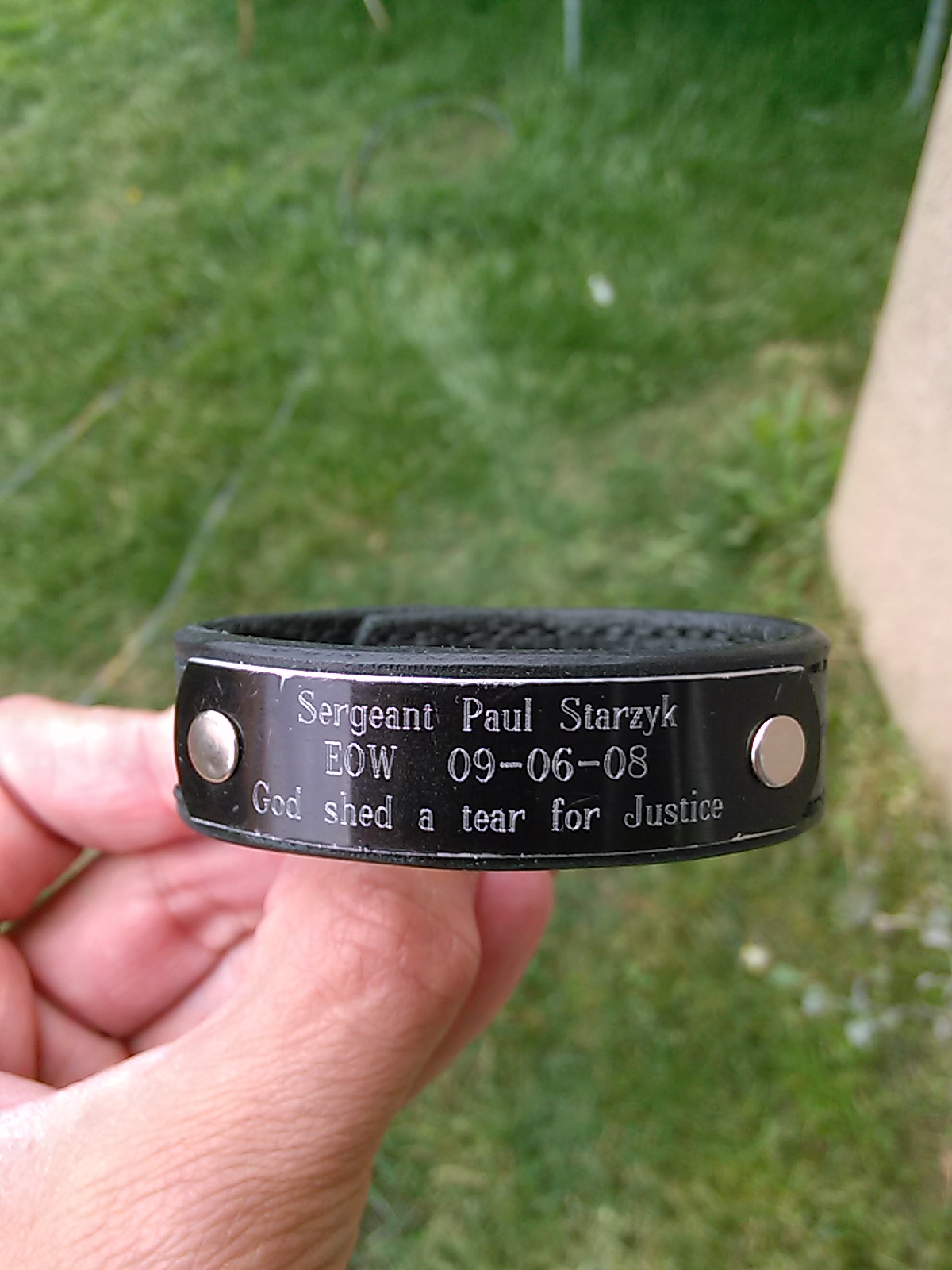

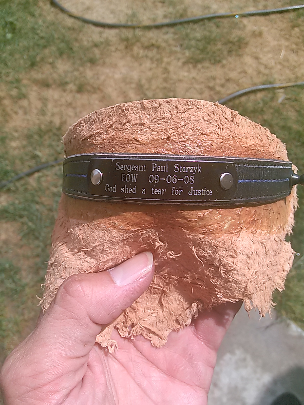

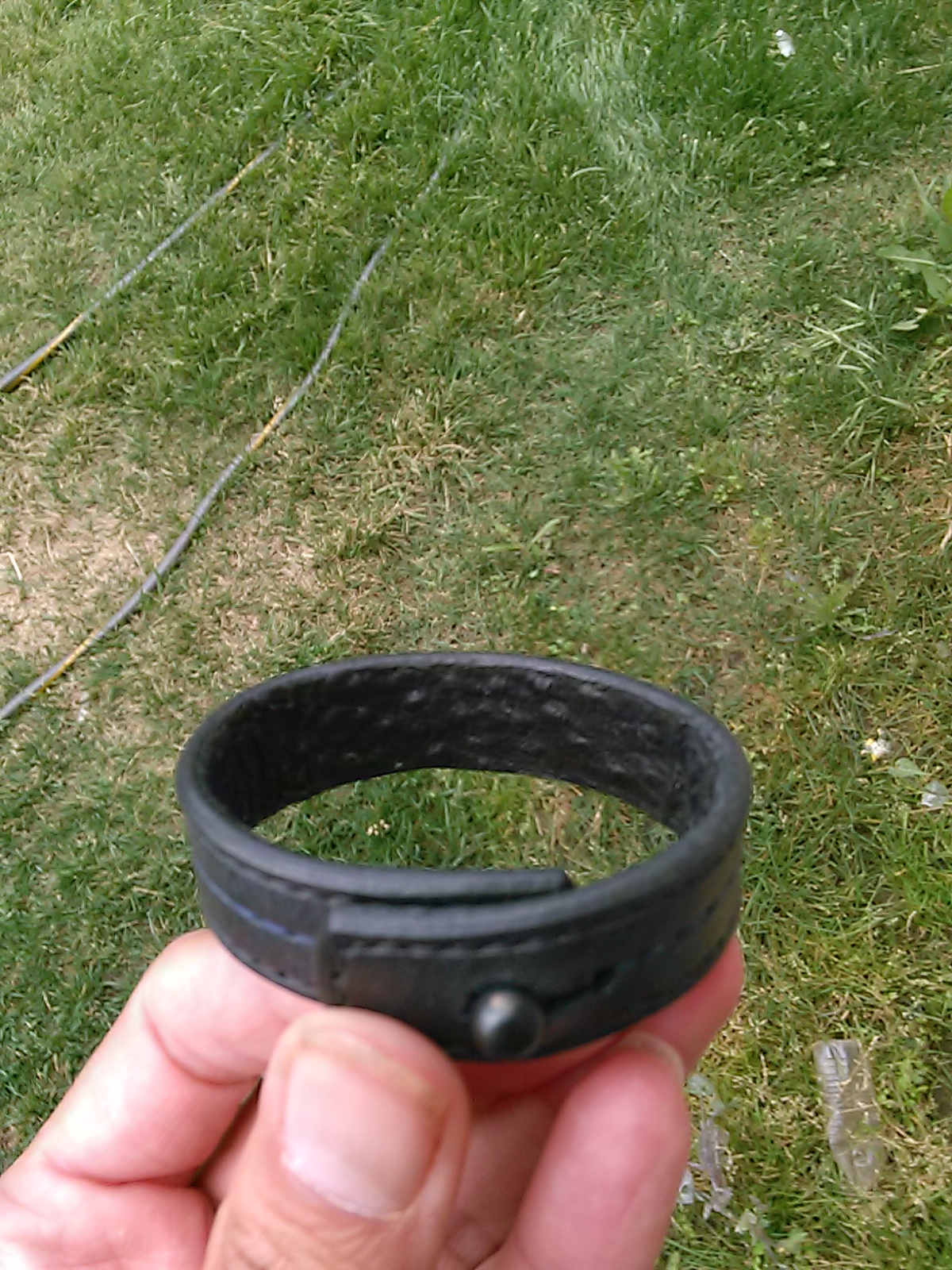

I finished this a few days ago, just been super busy. I really like how it came out, especially the emu lining. I think from now on all of my cuffs will be emu lined. It looks and feels awesome. Takes dye very nicely as well.
Anyone looking for a soft/thin veg tanned leather that will be exposed, I recommend trying a hide. It's really inexpensive for an exotic too. I'll probably buy a few more hides while they are available (SLC).

The emu is probably 2/3oz, and it is pliable. It would work about as well as pigskin for lining because it has a little give. Stretch is good. I'll use pigskin for lining unless you can see the emu hide. The feet are really reptilian, but they aren't flat.
I used Fiebings pro oil black.
The leather paint is by Angelus. I used a coat on the edge then decided to sand it a bit more. I finished it with dye.
Final finish is beeswax and oil.
Thread is-
Black- 0.8mm Tiger/Ritza 7 stitches per inch
Blue- 1mm Tiger/Ritza 5 stitches per inch
You can see that the stitch length on the blue line is much longer. Even though the blue line is dyed I wanted to make the stitches broken up as little as possible. Different colors of thread and stitch lengths are always welcome to me. I'm probably the only one to notice. :)
