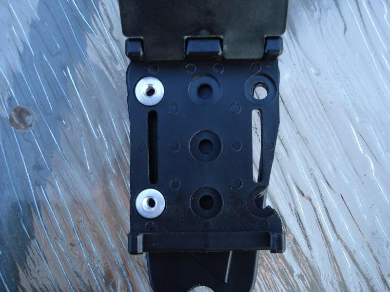

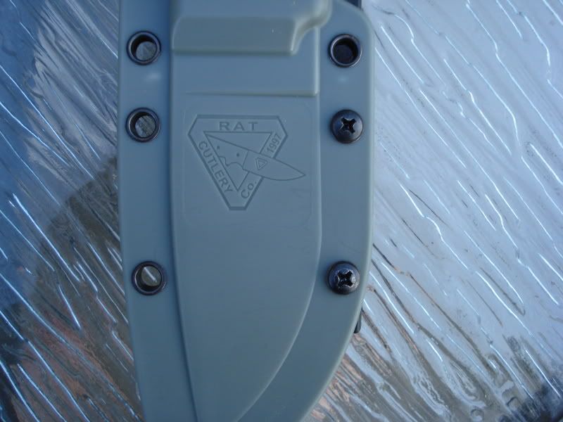

The hole pattern of the large Tek-Lok is pretty much the standard when it comes to kydex and injection molded sheaths.

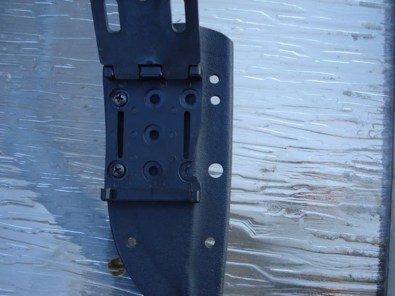

In most cases, your not going to be able to bolt the Tek-Lok to both sides of the sheath like you would think you would want to, due to the width of the sheath being larger than the Tek-Lok. I've been using these systems for years and have never had one fail nor break a sheath due to it being bolted to only one size of the sheath.
Note: this Tek-Lok was trimmed to fit another knife, just pretend that you don't notice.;)

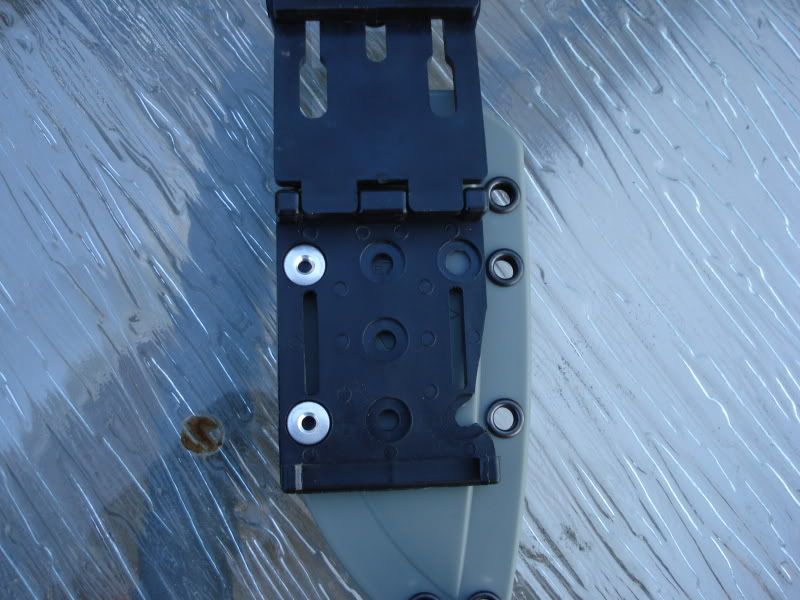

RC-3

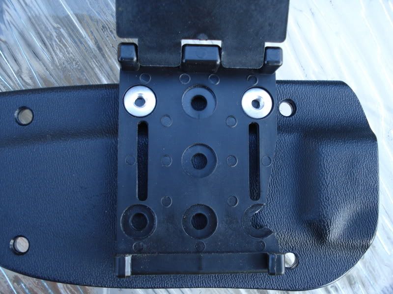

RC-4

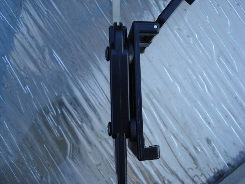

RC-6 (sorry, too lazy to remove my ghettoMolle setup)
It's not in the right spot, but you can see that the holes match up.

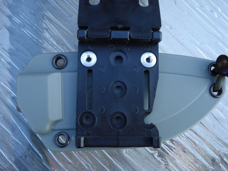

And then the horizontal solution
RC-4

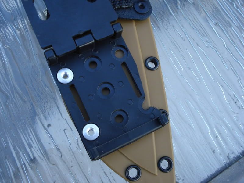

RC-3
Now the Izula can fit either way, the holes line up up and down and across, cool feature.

Gunner that was extreemly helpful. I'll be ordering one up from RAT directly. I'm still hesitant concerning the comments on the prior thread about the horizontal carry with an RC-4 that the postioning may cause a bit of handle droop. ie, not neutral balanced.. But I guess I'll find out.
Thanks for the awesome pictures. I found this thread out of a possible of 10 points usefulness: 11 POINTS SCORED. :thumbup:
Glad to help. Even if you don't like the way the RC-4 rides with the Tek-Lok, you'll find a use for it. They're very versitile.
If you were to adjust the belt width adjuster to your belt properly, it would most likely reduce the handle droop problem a good bit.
I've got two on order from RAT. One for the 4, the other for the Izula thats coming. I'll try cranking it down good and tight see how that works. Will advise for information purposes. I'm just a horizontal carry kinda of guy, in the small of my back. I find it's 100% out of the way for whatever you're doing. Especially when riding a 4Wheeler. Of course, I'll have to figure out how to share that same postion with my 1911. Will take some thinking to figure out how to get both to occupy the same realestate.

The slider is indeed good for horizontal carry, and if you tighten it up on the belt, it shouldn't droop much (I wear thick tradesman style belts and it doesn't droop at all. On a dress belt or other thin belt it might still droop some.).
