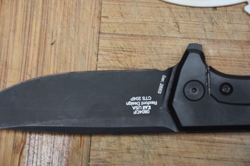

I put a sharpening choil on my ZT 0804CF with a Dremel (cone stone attachment). It took only a minute, and it makes sharpening cleaner and easier.
