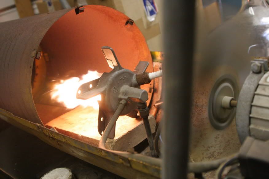

I use an oil forge and love it. There are a boatload of different burners, but most seem limited in adjustment and perhaps more suited to foundry applications. I can't offer any advice on those as I've never had opportunity to use any of them. Mine runs on a siphon nozzle type setup. You can buy the nozzle and adapter for around $50, find a torpedo heater that no longer works and get your parts from it or if you have a lathe you can make your own easy enough.

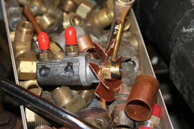

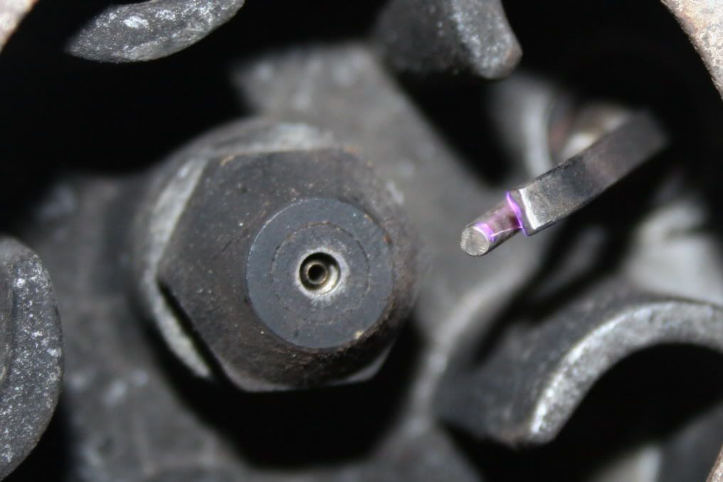

If you go with the torpedo heater like I did you'll find something like this inside. I've removed the combustion chamber in this pic so I could see how everything worked.
I played around with keeping the igniter for a while, but found it's completely unnecessary and made the burner much larger than it needed to be. After removing all the unnecessary bits you'll be left with this, which is about what you will get for your $50 if you order your parts.

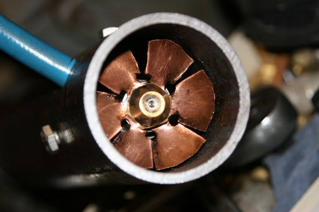

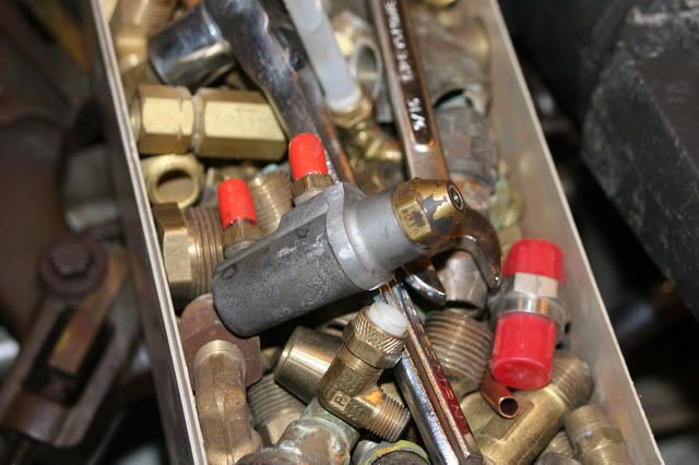

I added a copper turbolator to give the incoming air some swirl and aid in combustion. The original housing for the torpedo had one built into the housing.
Here's the business end after putting it in a piece of 2" black pipe. I drilled and tapped 3 holes 120 degrees apart to help center the nozzle in the burner tube.

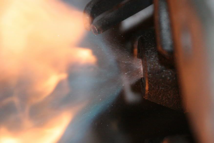

I haven't read of any other burner as adjustable as a siphon nozzle. from my understanding, pressure nozzles like the ones in home heating units are somewhat adjustable. however they rely on pressure for atomization so you can only turn them down so far, and that requires tools to do the adjustment. On top of that they clog very easily and require the oil to be filtered.
The siphon works on air pressure for atomization. With a turn of the regulator I can turn mine down so it's barely running or I can shoot 3' flames out both ends. For general forging I have the regulator set around 5 psi or lower, welding 10 or 15psi. I also use a valve to adjust fuel flow.
another thing to be aware of if you decide to order your nozzle is that they are rated for a certain gallon per hour. this is usually at 5 psi. It's nice to know but not that important for our use. for example, my nozzles are rated or 1.75 gph at 5 psi. if I turn the psi up or place the tank above the forge I use more fuel. I would never have to in my forge, but I could get it to burn 4 or 5 gallons an hour if I wanted. Which means the same burner would run a fairly large foundry or a much larger forge if I needed it to. I've never taken an exact measurement, but I guestimate I use .75 gph for general forging.

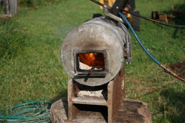

James, at the moment it's in a horizontal forge. It pretty much looks like every other forge.

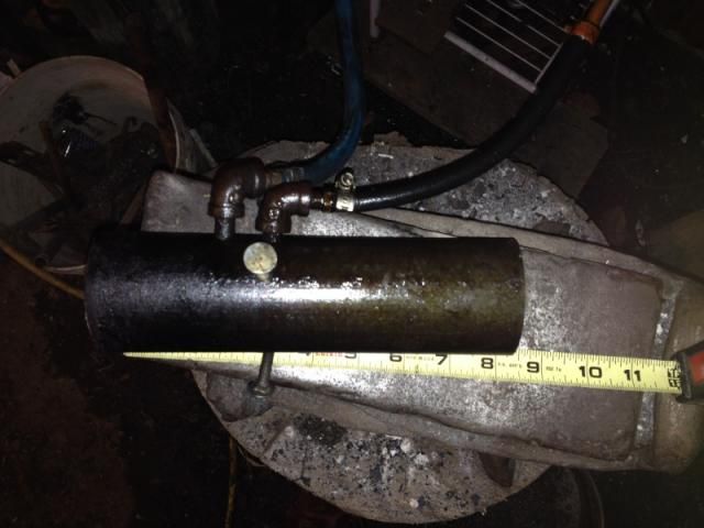

This is a pic of it shortly after i built it. It's out in the yard, now it's mounted to the building
It's "about" the same size as a 20 pound propane tank, maybe a little smaller in diameter.

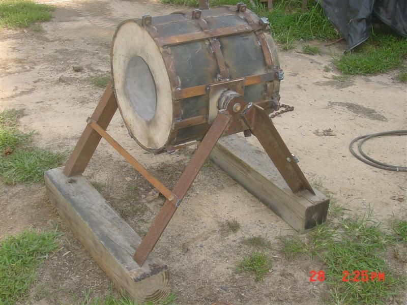

Mark I like it. What I use for my salt pot furnace is the typical gravity fed in stream of air from small blower. It works vertical. The one pictured is going to get your modification if that is ok . I'll call it my oof forge. Its pretty big but I wanted to be able to shut it down and close it off for annealing . I built the door, it has an opening about the size of yours. Its a heavy door. I used clevises for the hinges. Its a heat sink too.:) I don't have a pic of it mounted . I will take some when I get her running with your setup.I made the lining out of crushed firebrick and fire clay, Little furnace the same. OH how does the ceramic insulation hold up to oil droplet ?

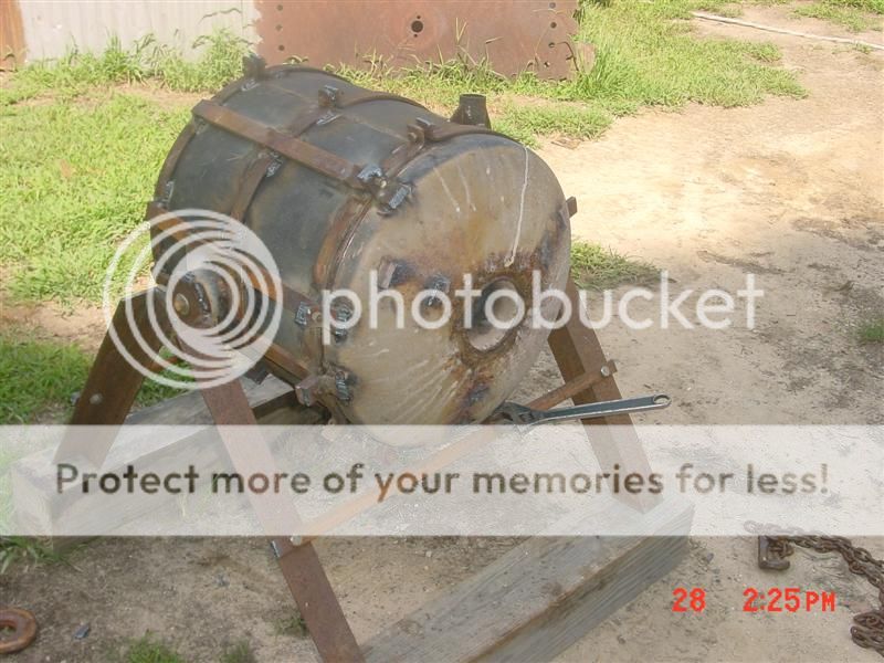

this is just a vertical furnace its runs of oil . I do preheat with wood or propane til I can switch over to oil. I've sinced wrapped the gravity feed line around the furnace so it preheats the oil.
Burning oil is ideal for me cause I don't drive a vehicle. I have had a propane forklift before and now its converted to gasoline. It was always hard to get the tanks filled. The large dealer didn't always feel like the weather was suitable for being outside or just nobody was capable of filling it. To much of a chore. twenty lb bottles I can deal with . exchangeable. But expensive for something that should cost only as much as regular gas.So I was told. So preheating with it is fine. Running like I just don't care , impossible. I would have to make some modifications for coal and then find it easily or its unreliable. Well oil is reliable for me. People have brought it to me for a few years now. I have a little stash.
Salem, I'm glad you found the information useful. I can't take any credit for the idea, I merely looked at what others were doing and copied it.
James, that thing looks like a beast. My only concern is the size of your tuyere. The burner needs to be in a pipe large enough that you can still get combustion air through it. Unless you plan on providing all the combustion air with the compressor.
In the first pic of the burner the fuel/air hoses attached directly to barbed fittings coming out of the adapter. While the burner doesn't get that hot, after a short period of time the hoses deformed and would pop off. I removed the barbed fittings and replaced them with iron nipples to get the supply lines just a little farther from the heat. I drilled holes through the side of the pipe to allow the lines to attach there. Some have the lines going all the way out the back of the pipe. this would need a pipe that much larger to allow for everything to fit. The line on the right is fuel and the left is air for atomization. I use a separate blower to provide combustion air, and that comes in the back of the pipe via an old vacuum cleaner hose. a movable cover over the blower intake will also allow for finer control of your forge atmosphere
The inner layer of my lining is a hodge podge of crushed soft brick along with some insulating refractory that the binder had gone bad, mixed with a little bentonite to hold it together. This is covered with a layer of noxram. I assume you are asking about ceramic wool? I don't think it would hurt it directly, but wool becomes fragile after firing and should be covered with a rigidizer. I don't think it will hurt what you have there at all, as long as it can handle the heat.
The one thing I will warn about is that where the oil droplets impinge on the lining it will tend to coke up there. I have a metal hook that I occasionally have to reach in with and clear the tuyere. Most of it will come out this way, but there's always a little that stays and is hard as a rock. after a while I have to take a chisel to the opening to clear it back out.
These nozzles can be had with different spray patterns. The ones I have are cone shaped.
