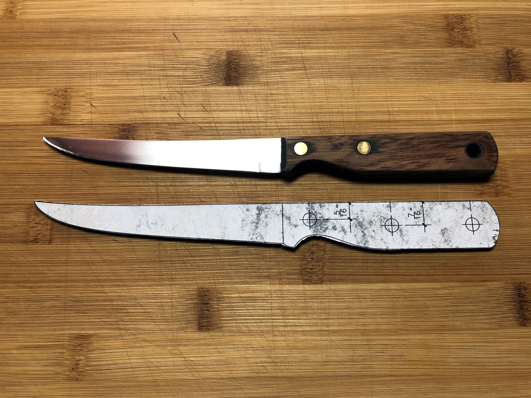

As mentioned previously in this thread, I have a few pieces of 1095 that I plan to practice on, to see if I can even come close to being able to grind. Having the water jet cut blank will act as a template for the 1095 versions that I will have to saw and grind out.
If I do not feel comfortable grinding after 4 junked blades, I guess i will have to start looking for someone that might be able to grind the M4 for me. I have no intention of wrecking the M4.
Thanks again for the design help - I think it looks great!
You mean like this?It sounds like you have your mind made up, but what I would do if I were you is get enough steel (cheap, whatever steel) and do enough profiles for maybe 3 blades.
Use those "dummy blanks" to practice ALL steps of your process. It Will help you.
-If you wont/cant do profiles, bevels aren't going to be any easier.......
I'm actually planning on grabbing a piece to help me do a hollow grind, with a new wheel I got. Just to get a feel how thin I can go, and what that looks like
We are here to help, and Cheer you on..... Go grind your outlines.just do a little at a time.
I cover my steel with marking compound, like Dykem or Wolf and scribe, let it dry..... then grind to line slowly..... Outside radius are easier than inside.
For inside radius, track your belt OFF your platen by about 1/2" Use that to soften your INSIDE radius. It's actually pretty easy and works great.
It looks fine....You mean like this?
I did this on a 1x42 Kalamazoo - it is my 1/8" thick mild steel template for a few blades that I want to make. It is not perfect or finished in this photo, but it is finished in real life, and looks good to me. I will get a better photo of it soon. I am retired so I am working on my own schedule and it can take me a while to get to things![]()
I think I edited the post while you replied?It looks fine....
What I often do is smooth the profile out with a hand file.
be careful not to bend it. I usually do it Hard, with a cheap Am*zon diamond file clamped upright in a vise.
*In the future, I like to drill holes First.
It's easier to hold securely in a vise when the sides are parallel
I have a milling machine I intend use to drill the holes. I moonlighted for years in a machine shop (because I always wanted to be a machinist!It looks fine....
It's easier to hold securely in a vise when the sides are parallel, but you should still be able to, just take it easy
