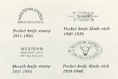

Does anyone have a list or chart of the various tang stamps/years that were used for Western States Cutlery and Western Cutlery? Especially interested in Western Boulder stamped folding knives. Not actually Camillus, but thought this would be the best place to post the request. Thanks

Here is an updated version from OPGCK XV
Since everyone else is posting charts from books ;)
I'm 99.99% sure it falls under the "for criticism" clause in The Fair Use Act
for purposes such as criticism, comment, news reporting, teaching (including multiple copies for classroom use), scholarship, or research,

Read the third paragraph from the page showing stamps from my earlier post, and it pretty much sums up stamping.
"All goods had to be stamped, but exactly which stamp was used was not considered important." :p

In the book, as shown on the first graphic in an earlier post in this thread, Platts states:
"During the 1960's, tang stamps on both sheath knives and pocket knives were gradually changed to "Western USA" - except for the number 381, which was marked Western, Boulder, Colorado, Made in USA well into the 1970's."
I would imagine your 62 falls into that category of "gradually changed in the 1960's". Platts further states on that page, "this information about tang stamps and blade etches should be taken as a general rule". This is about as close as I could come. Hopefully a Western collector with more knowledge may be able to provide more infomation.

XBXB - Actually, I think your knife is a typical knife from the 50's. My few Boulders are all stamped just like that.
Harvey Platts, decendant of the company founder, did us all a great service by writing the book when he did. However, like all important reference books, it does contain errors and omissions. Just one example is the date of the introduction of the trademarked name Westcut. Go to the USPTO website and look it up. The tangstamping reference is quite incomplete as well. But... it does reflect the information to the best of the author's knowledge at the time it was written.
