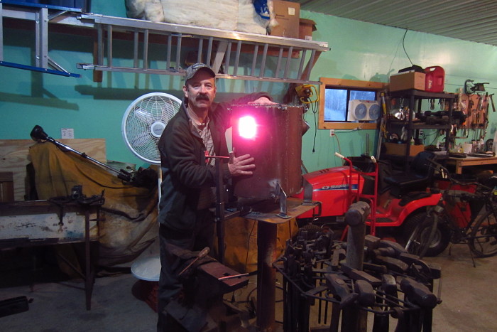

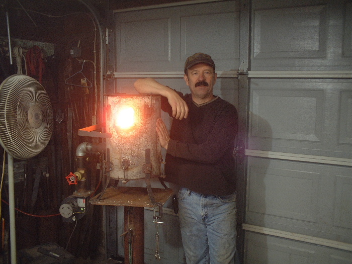

I've always been a fan of properly insulated vertical forges.
I saw on another thread about a flux conversation where guys were complaining about how flux is a problem eating their forges and causing all sort of problems.
With a vertical forge - those problems disappear.
(These pictures are over five years old, but you get the idea)
