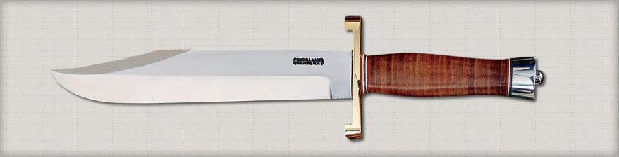

Can't go wrong with a Randall Sportsman Model 12-9" with #14 grind and stag handle.
