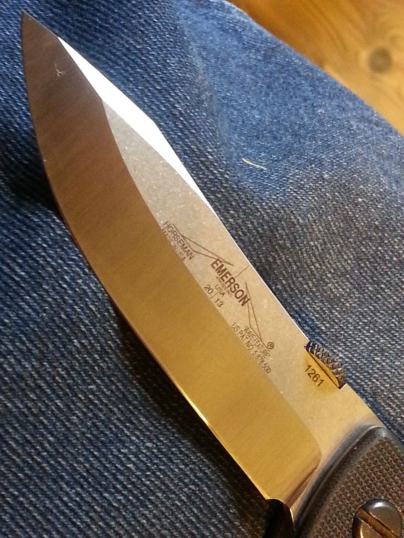

I have been offering regrinds for a few months now. I offer flat belt finished regrinds on most any knife you want altered. I have done custom work on both production and custom knives. I always forget to take pictures of the finished knife, but here are 2 knives I did this past weekend.

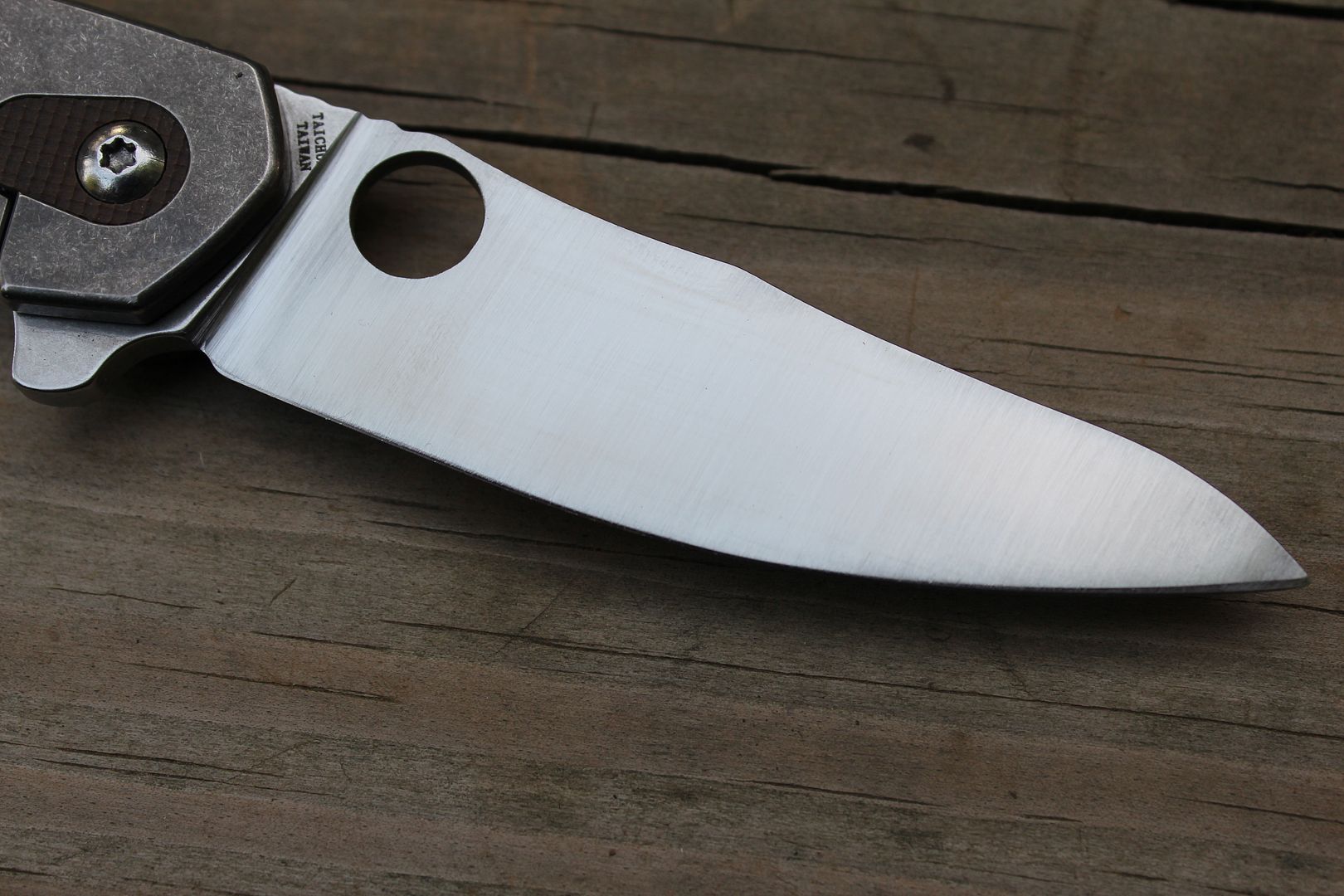

An Emerson Horseman that I thinned the edge, brought the shoulders up higher and removed the thumb ramp and Wave.

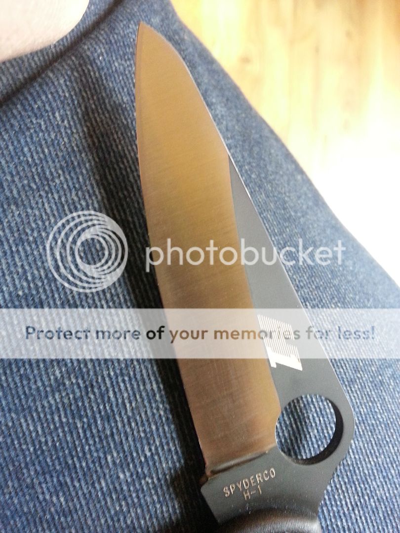

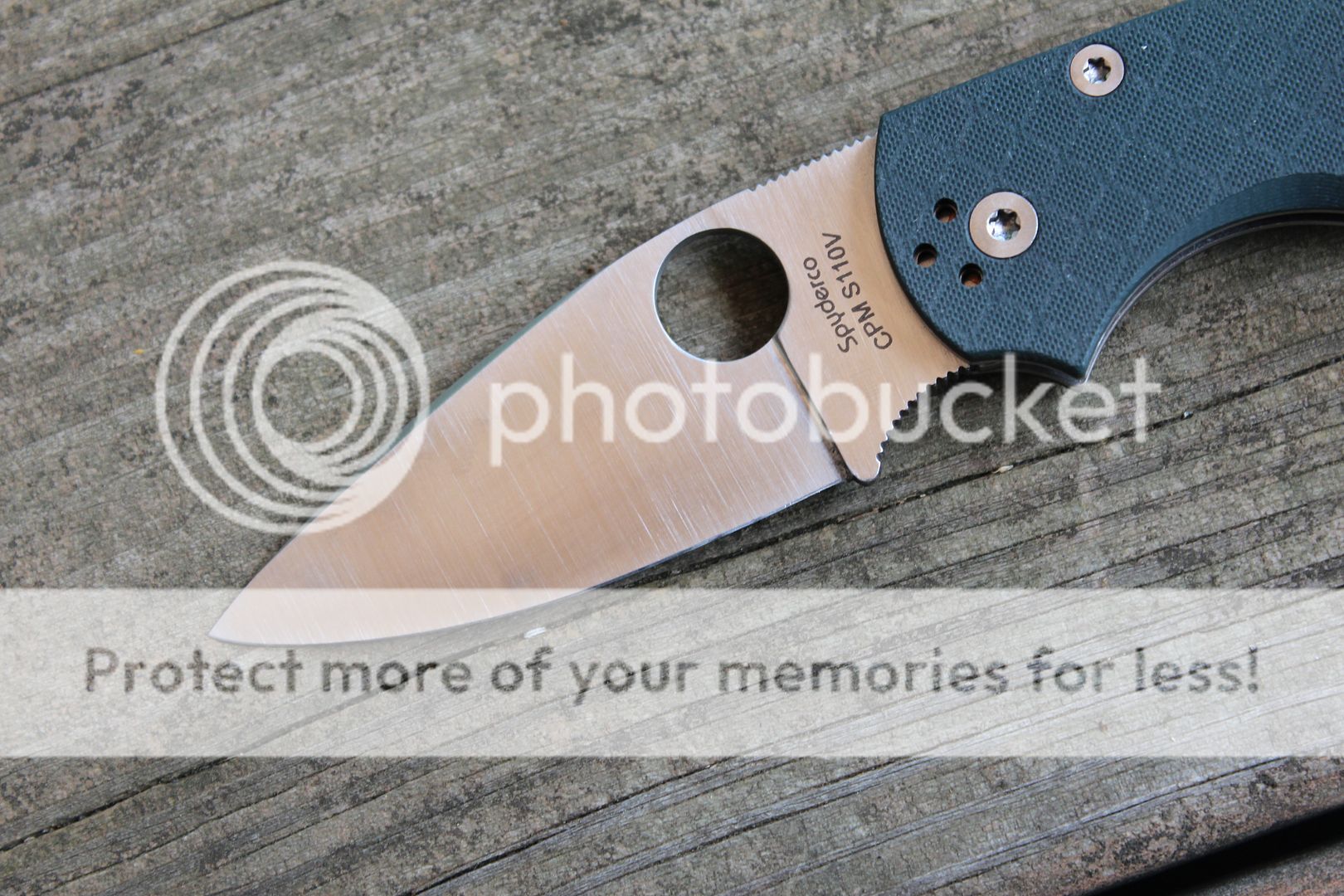

This Spyderco H1 was brought to a zero edge and then the final bevel was applied. This knife edge is at .006" at the shoulder behind the edge.

Hey Chris, I picked up the Emerson this past weekend and love it. This is now by far one of the sharpest knives I own. Thank you.
Big Chris puts some of the sharpest edges I have seen on knives. don't hesitate to get with him for this service.

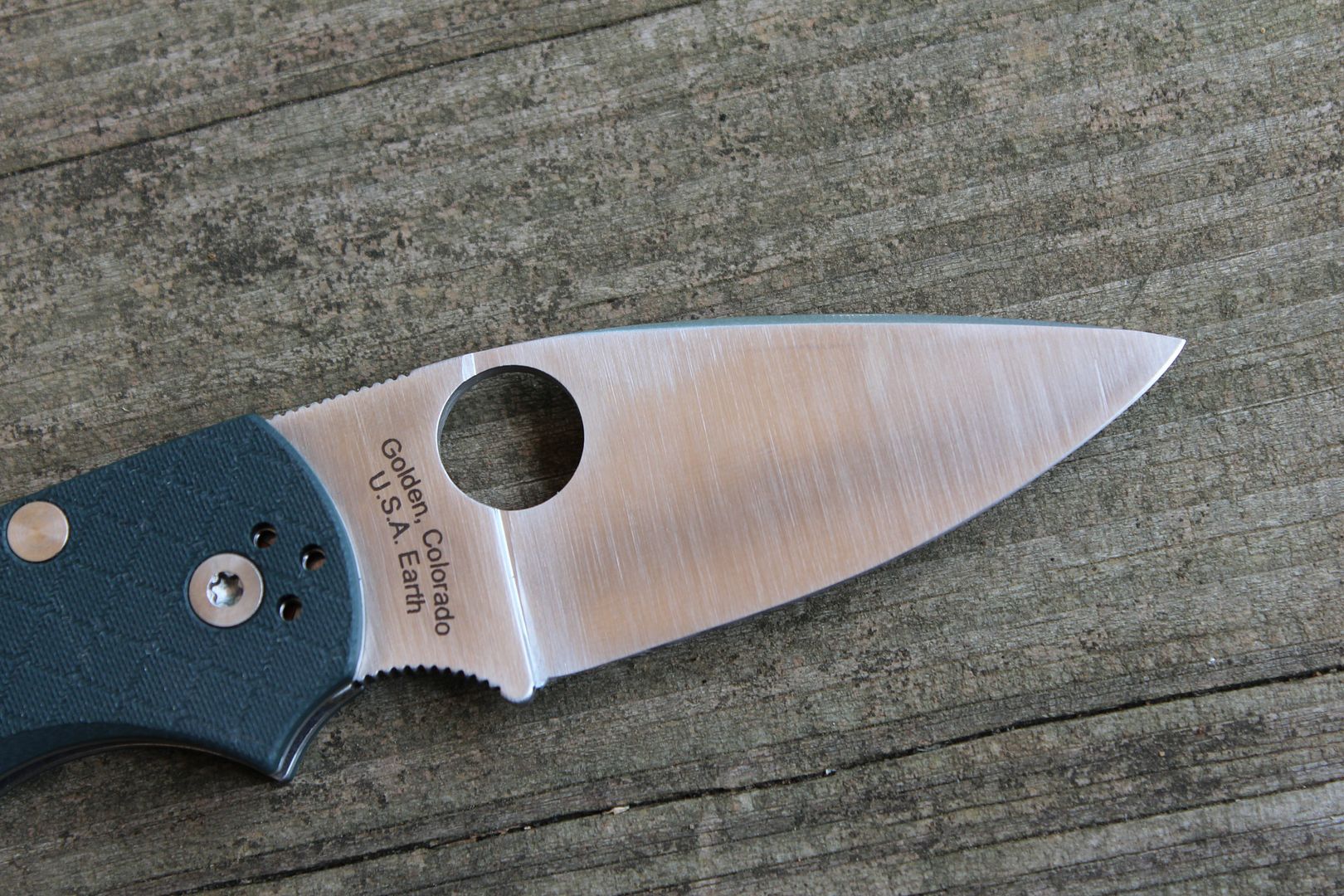

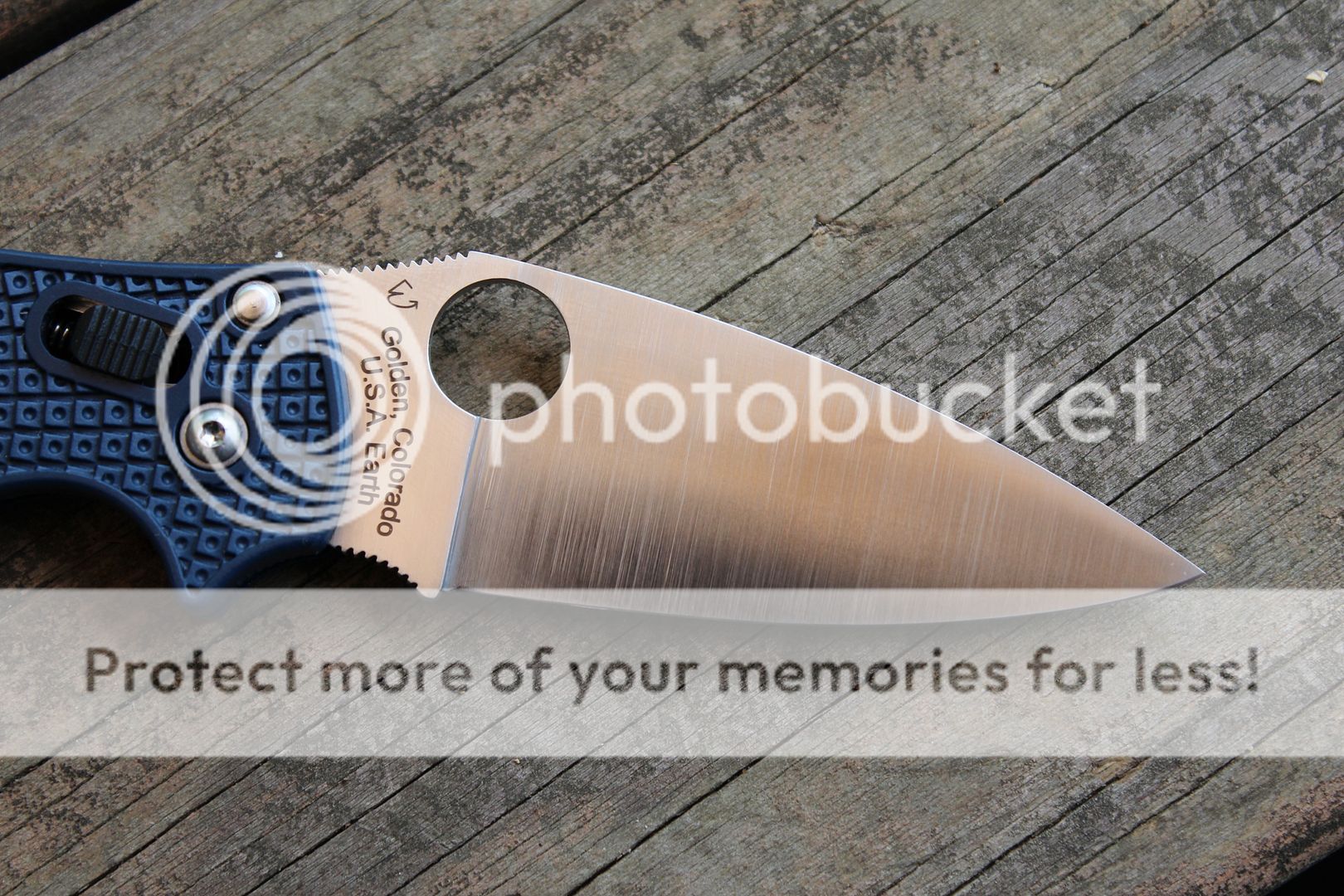

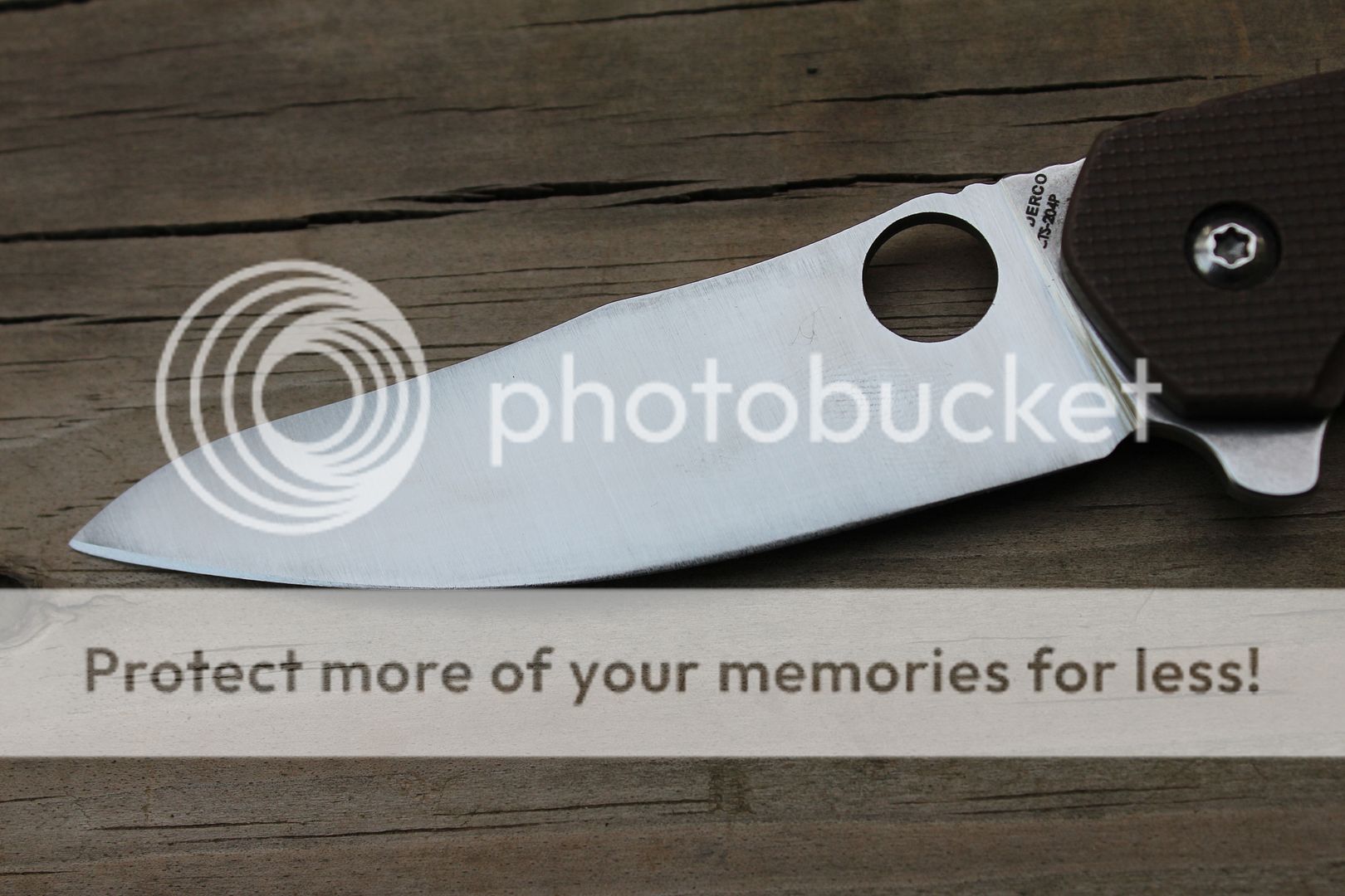

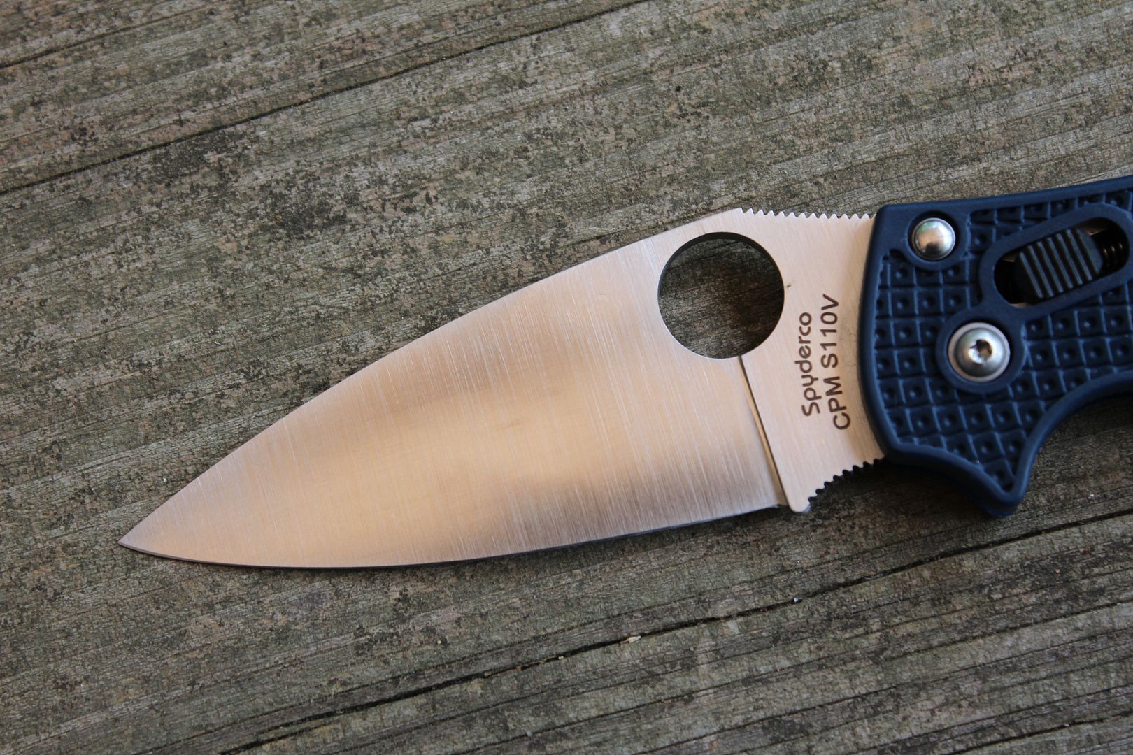

Here are 2 S110V Spydercos I reground to around .006" behind the edge.
Forum Native
Manix2
These pictures are after the edge was sharpened to 30 degrees inclusive.

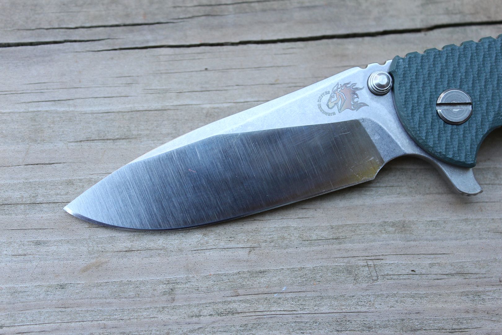

Here are some pics of a Spyderco Southard I just finished.
Reground to just under .010" behind the edge and thinned the spine from .155" to .115" while maintaining the distal taper.
Thanks Chris! Got the knife last night, and it is in my pocket right now. Very nice work, I haven't used it yet but am very happy with how it turned out. I don't know if you noticed, but it is lighter feeling to me. You removed a lot of steel and it should be a big improvement.

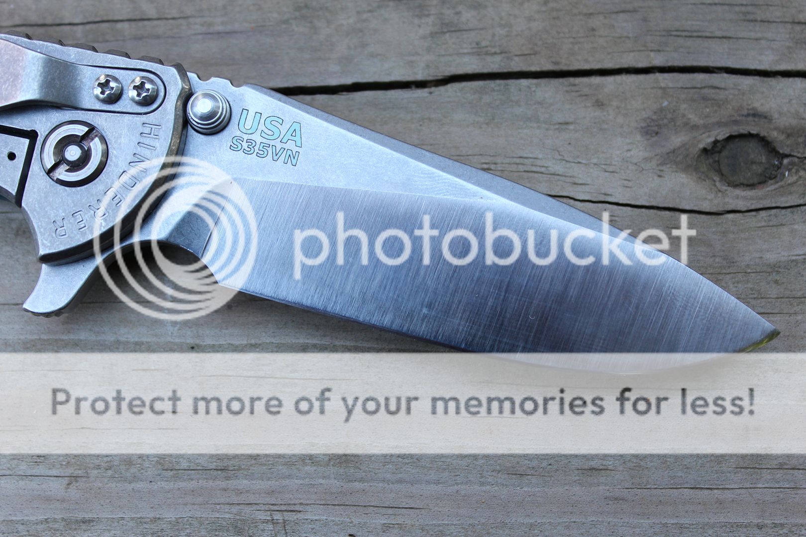

Did a Variable Geometry Regrind on a Hinderer this morning.
It turned out pretty good, but it is a real pain to execute.
I will now start to offer this on any knife that is not a full flat grind.
This Hinderer started out as a Spanto Grind and was turned into this:
This type of grind will be a $20 up-charge from the standard regrind fee.
