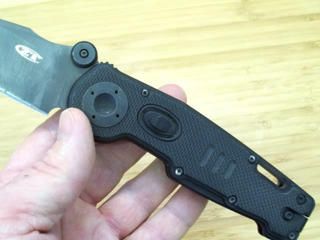

What I did was take a couple of hex wrenches, allen keys, or whatever you prefer to call them, that would fit in the holes on the pivot. The whole disc on the side is the pivot and will turn. You could actually use any type of metal rod that will fit those holes. Then placed a small screwdriver between them and hed the keys while turning it and presto, took the pivot right off. It would probably be easier to tighten the backside pivot, opposite side of the lock button as I think the front side is already tightened down completely. I did use a tiny drop of blue loctite, the medium break type, to secure the pivot and so far so good. Has been this way for two weeks now.

The 0500 is a big folder. It has a 4" blade and a 5" handle, nine inches OAL. The scales are made of carbon fiber, and the pivot pin is enclosed in rubber washers to prevent sand and water, etc., from entering the joint. The thumb stud is large and ridged. It forms part of the thumbrest when the blade is open. The stud is ambidextrous.

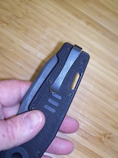

The pocket clip is pretty small, and the knife is set up for tip-up carry. It can be carried left and or right. The clip allows the knife to ride very low in the pocket.

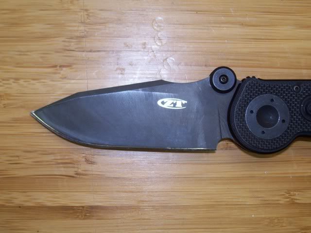

The blade steel is 154CM; the blade is a sort of spear point, with swedges on the spine. I convexed the edge somewhat on my belt grinder. I don't care for the "tactical black" finish, but for a work knife it doesn't bother me.
The pivot action is smooth and the lock is like a bank vault. I've been deploying the blade with some authority pretty often per day, it has no play whatsoever.
The scales were very sharp on the edges. I took a foam sanding block to them and rounded them off some. The handle, though large, is very comfortable now that I defanged it, and it is easy to use with gloves on. The thumb stud is large, and easy to find.

One thing I would (and may still) change about the shape of the blade is the sharpening notch. I find that when making deep cuts through some materials, that notch tends to catch the material and tear, rather than allowing a smooth cut. I sometimes have to pull the blade out a bit before cutting to prevent this.
