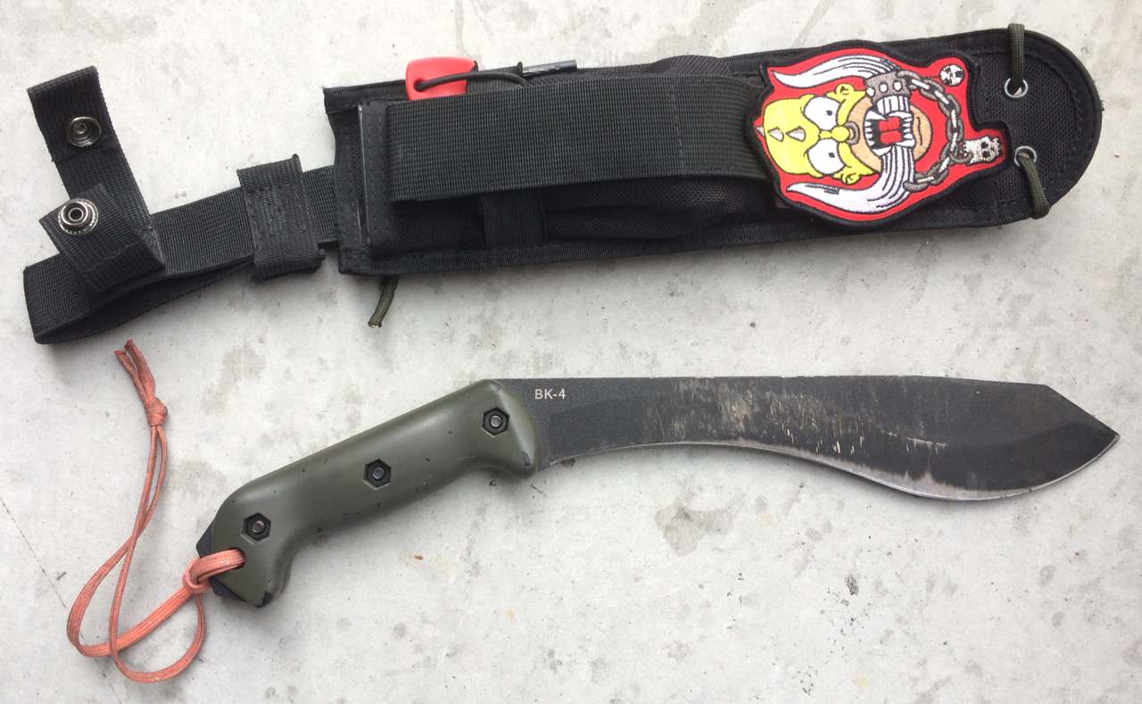

I wanted to know if anyone one knew of a way to either paint or coat the 14's zytel handles. I plan on ordering a set but don't really have any plans on using the Orange set, but would hate to just put them in a drawer. Sorry if this has been asked before.

I've heard of people using kyrlon and baking it on but might affect the scales. I was thinking of trying a real good sanding job, then using a heavy duty primer and then trying some krylon. Guess I wont know til I try, just figured all you savy beckerheads would have some methods off hand.
RIT works on a lot of plastics. I don't want to dye my orange ones, but if someone has a spare set, I'd buy them and give it a shot / do a tutorial on it. I've used RIT on a lot of plastics for R/C vehicles and it works well.
RIT dye for sure works on things that aren't fabrics. I know some guys that use it to make custom colored keyboards of all things. The secret is to get the dye warm, but not quite enough to melt or disfigure/distort the plastic that you're working with. Also, repeated soakings work much better for most plastics.

DuraCoat. If it's durable enough for a Glock, then it would work fine on a plastic knife handle.
Expensive start-up (it's a two-part epoxy coating -- needs to be mixed and airbrushed within a few hours -- not available in a spray can).
Krylon Fusion is the cheaper, if less durable, alternative.
The best way to paint "plastic" is to use a mechinal abrasion then to prime it with a clear plastic primer for bumpers. You will have to use some kind of spray gun to properly apply the product. You can find this info at a repatuble body supply store.

I painted a set of scales white with the Krylon for plastic. It looked great. I let them cure for a couple of weeks and tried to scratch the paint with my fingernail, and it did chip off. So much for that experiment. I figure if I can do that with a fingernail, it won't stand up to hard use.

wipe the plastic down with acetone and the paint will stick better.
lightly sanding it with 120, 150, or 220 grit paper helps, too -- because it makes scratches for the paint to stick to.
I painted mine with Krylon Fusion camo olive some time ago, it came out well at first but ended up chipping easily. I do like the worn look, though.
