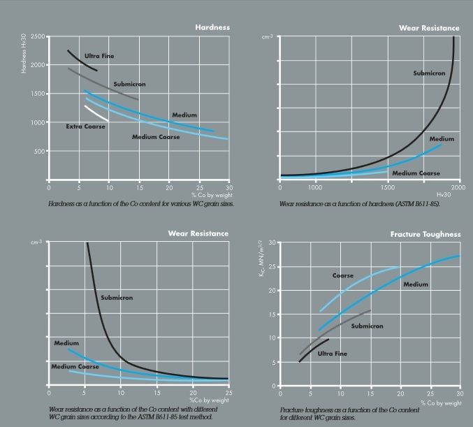

One thing i would put to you is that the crack initiation can start at a very small inclusion and what it needs to propagate is grain-boundaries (weak joints) to follow. In those images, CPM154 has larger carbides with grain-boundaries around each one - a less-linear path for a crack to follow; and there is much greater distance between carbides making it much harder for a crack to jump across (actually proceed through) the tougher tempered-martensite/austenite to the next weak-joint around the next carbide. For the AEB-L, the path from carbide to carbide may be more linear with less matrix between. Using these slightly larger carbides in the midst of larger distances between may actually give the slightly higher-carbide volume CPM steel slightly greater fracture toughness than the lower carbide AEB-L though the difference might not be noticeable in actual use where threshold stresses are likely to be unreached or exceeded for both. But for ingot high-carbide steel, the larger carbide aggregates provide a path yet more linear with less matrix between than the lower-carbide AEB-L (or 420HC) hence the increased toughness over steels like 154CM and 440C. Using PM you get very high-carbide (high-wear) steels with toughness levels comparable to low-carbide (low-wear) ingot.
Here is a chart relating to fracture toughness in cemented carbide (<30% matrix WC-Co) that helps illustrate fracture toughness with regard to matrix volume and carbide size, specifically looking at the differences in toughness at 85% carbide between "submicron" vs "medium" and "coarse" carbide material. There are some excellent papers on the toughness of cemented carbide detailing how fracture-toughness relates to the ease with which a crack can follow a path through the material.
Again, Crucible suggests in its data sheets that the difference in longitudinal impact toughness between 440C (22J @58Rc) and S35VN (38J @58Rc?) may not be all that noticeable (or the values have a large range of deviation) so they push transverse impact toughness instead, and Sandvik won't even release notched impact toughness values for what they peddle. Based on the data from cemented carbides, I am suspicious that fracture-toughness values would be even closer, i.e. harder to differentiate steels that are between 4% and 24% carbide rather than only 4% to 24% matrix as is the case for cemented carbide - there is just so much more matrix in knife steel to absorb fracture energy, it is likely not a very good way differentiate between them for this purpose. *shrug*
Using cemented carbide as a form of showing fracture toughness with regard to matrix volume and carbide size is a double barrel IMO as cemented carbide is a completely different thing to compare to the steels we are using.
Yes the coarser carbide shows greater fracture toughness than the sub-micron, but the rest of the article shows that sub-micron cemented carbide has higher hardness and greater resistance to wear.
Reference:
http://www2.sandvik.com/sandvik/0130/HI/SE03411.nsf/7a5364adb7735b05412568c70034ea1b/651f6e334db04c46c125707600562c88/$FILE/Cemented+Carbide.pdf
By that standards we would want less carbides in our steels because it would give us greater hardness, resistance to compression and greater wear resistance.
This is opposite to what has been marketed in our cutlery steel and what we know with regards to abrasive wear resistance in our knife steels based on research done by Verhoeven and Totten etc. IMO to bring in cemented carbide really muddies the water far more than we need to. Totten states that one should not compare steels that fall in different categories such as HSS to HSLA etc as there are too many variables.
With regards to the linear path etc and the matrix I have not read anything to really contradict "Crack growth is governed mainly by the content, size and distribution of the primary carbides and the mechanical properties of the matrix. The content of primary carbides is determined by the amount of carbon and carbide forming elements like chromium, molybdenum, vanadium, tungsten and niobium. These elements improve wear resistance and hardness of the material but impair toughness,because of their strong tendency to segregate during solidification." (J. Blaha, C. Krempaszky, E.A. Werner and W. Liebfahrt (2006). CARBIDE DISTRIBUTION EFFECTS IN COLD WORK TOOL STEELS. 6TH INTERNATIONAL TOOLING CONFERENCE. Page 290)
Though PM process does improve the distribution etc of carbide and the matrix compared to ingot versions, IMO, the carbide content and larger size of the carbides will still more likely cause fracture growth in CPM-154 to occur than AEB-L based on the articles and books that I have read.
We are not even yet discussing grain size and matrix relation.
You apparently misread those charts, we want MORE carbides of smaller size to increase hardness and wear - hardness and wear increase as carbides get finer and more prevalent (highest at 95% submicron carbides), it decreases as %Co the non-carbide matrix increases (lowest at 75% carbide, 25% matrix on those charts). Decreasing carbide size while maintaining the same carbide content improves wear-resistance, as does increasing carbide content.
I agree, it muddies the waters, but it helps clarify how CPM-154 can be as tough or tougher than AEB-L while also being more wear-resistant, and it is specifically NOT the "opposite" of what is being marketed in regard to cutlery steel.
I was recently introduced to stress corrosion cracking (SCC) and corrosion fatigue on a project that I am working on and how carbides etc affect that. Really interesting but doubt knives will ever be exposed to those conditions.
The bolded part is absolutely fundamental to the principle. Again, crack propagation follows the path of least resistance usually at the grain-boundaries where carbides aggregate. The boundary around a carbides is especially weak, the path through the matrix grain-boundaries is much tougher, and toughest is the path through a carbide (i.e. cracking it apart). Crack initiation can begin at an inclusion of ANY size be it the boundary of a 2um carbide or a 10um carbide, but propagation of the crack requires a path to follow that is as close to linear as possible for dispersing the energy/stress inducing said crack. Thus propagating cracks around large carbides is more difficult than around small carbides which have have a greater surface area-to-volume ratio. What gives AEB-L an advantage over higher carbide ingot steels is that those small carbides are dispersed with a greater amount of matrix between carbides whereas steels like 154CM and 440C may have large carbide-aggregates with their associated weak boundaries spanning great distances through the steel so there is less need for the crack to proceed through tougher matrix to achieve the same amount of damage = lower fracture toughness. But when those aggregates are broken up to eliminate those clear paths and put more matrix between, the fracture toughness of the material increases (as shown by the PM marketing/publications including the CPM-3V patent and also by the work on cemented carbide previously illustrated in the marketing chart). The effect is SO great that a steel like CPM-3V can achieve even impact toughness some 50% higher than a tough ingot-steel like A2 with the same carbide load. HOW the carbides are distributed is essential to fracture-toughness behavior based on how that behavior (crack propagation) actually occurs, i.e. following paths of least resistance.

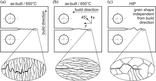

Do you have any references where they discuss this path that is followed in Autenitic or Martensitic steel? Specifically related to small vs large carbide? Or is this based on cemented carbide? Would love to read it as most of the references I find is related to Silicone/Silicone Carbide and Stress Corrosion Cracking.
There are many publications concerning crack propagation in structural steels, but most deal with the steel matrix itself as that makes up the majority (80-99%) of the material, and the effect of carbides as inclusions for crack-nucleation is much smaller than for ceramics.
With regard to cracks following the most linear path and fracture toughness being increased with "deflections" aorund that linear path, here is one illustrating the point, though it may be a bit heavy (i.e. off-topic) for this thread: http://www.sciencedirect.com/science/article/pii/S0013794414000757
Grains here refer to the steel matrix which is more easily cleaved (ductile transgranular cleavage) than carbides (generally fracturing via intergranular or boundary cleavage around the carbide).
...Similar effects of grain size on fatigue crack growth were found ... where specimens with a crack parallel to elongated grains revealed a shorter fatigue life than specimens with the crack orientation perpendicular to the elongation direction...
After HIP processing the threshold values for both orientations, i.e. crack growth normal or parallel to building direction, are increased and almost equal. The microstructural reason for this enhancement and similarity is shown in Fig. 6c.... Fig. 6c depicts schematically coarse grains accompanied by small sections of elongated grains. The absence of a preferred grain orientation leads to similar thresholds... The increase in threshold values can be explained based on the elevated grain size. Here, the crack with its tip positioned in front of a large grain is oriented towards a large boundary which acts as a barrier. For passing through as well as for growing around the large grain increased effort is required.
