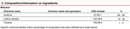

IIRC, brake cleaner is just Acetone with a splash of paint thinner in a spray can.
