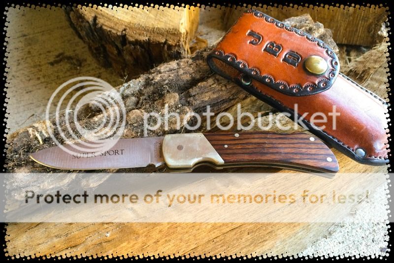

I've had this Valor Super Sport that is stamped 440 Stainless Japan for 30 years. Still takes a razor edge, and it's done everything from box opening to deer dressing.
