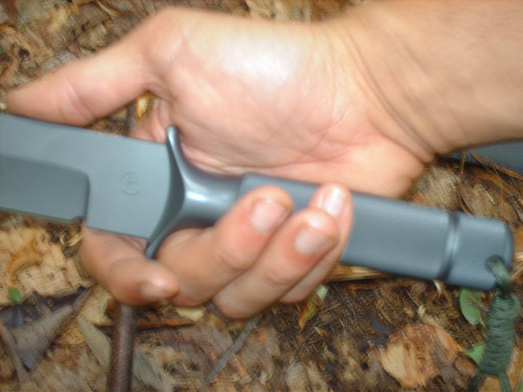

Choking up on the blade for fine work was made possible by a large unsharpened ricasso. The top guard I found to be an incumberance but not totally unbearable. I just loosened my grip a bit. On the other hand, a guardless spine would be nice!

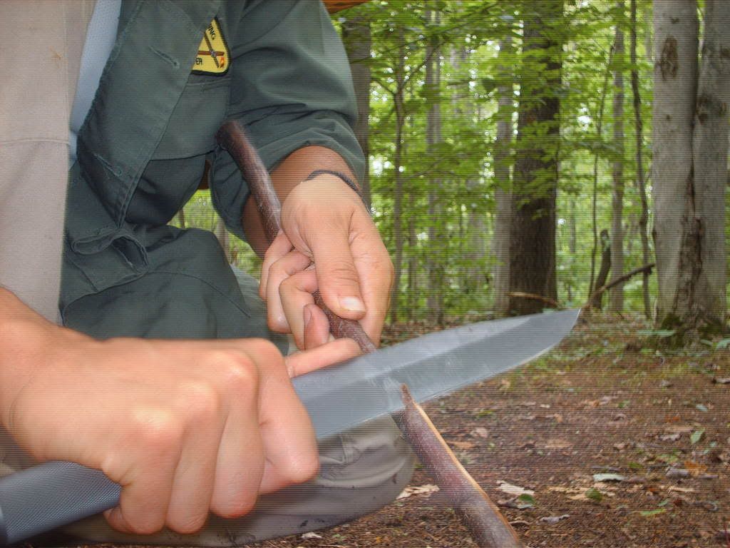

Fine work being done with the large blade. It sliced nicely and I found the long sharpened section took shavings off with one swoop.

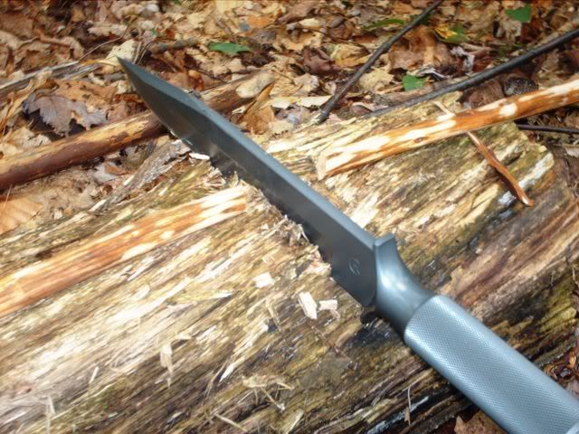

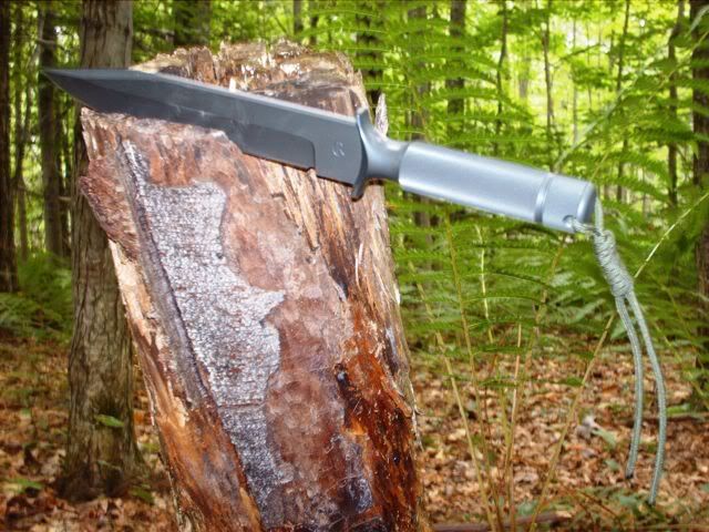

Chopping was a cinch with the heft of the blade. I cut numerous small saplings and then spent some time working on woods of various densities. From punky to hard beech, it cut well but not as well as some large blades I have owned with a full height bevel. Overall, not bad. The handle knurling provided a positive grip but it did create a couple blisters in the palm of my hand.

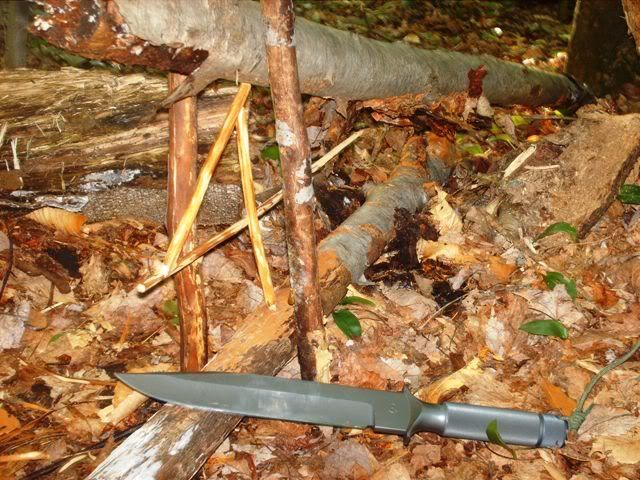

A figure 4 made with the Jereboam II.

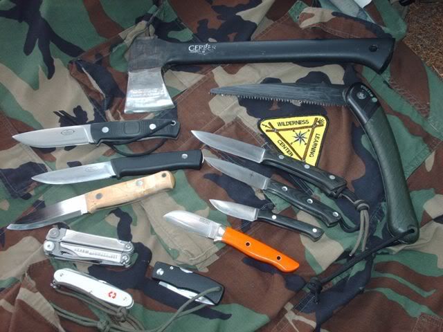

nice post. I'm toying with the idea of slimming my battery down to 2 blades, a 12 inch machete and a small fixed blade... I'm waiting for my mini canadian to arrive, when it comes I'll be testing this combo over the nexxt several weeks... K, I've been wanting to ask you what kind of knife is that necker I see you wearing from time to time?
The neck knife I carry is the Bark River Knife and Tool Lil' Creek. I'm anxiously awaiting a very slim 5/32" PSK from Scott Gossman that will most likely replace this one. I like the stoutness of the Lil' Creek. The sheath is made by Sharpshooter Sheath Systems and it has a BSA hotspark on it, and in the cut out, some circle hooks wrapped with 50# spiderwire. I put a small photon light on it and soon I'll put a compass to finish it off.
It is the third knife below the WLC logo in this picture. Above it are a Mini-Northstar and Fox River for size reference.
