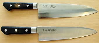

what's the thickness on those?
- Chris
i like the 2nd one and the 5th one from the left.
love the nakiri up top too.
=D
for hardness, I used the machine at the office. please explain thick/wide related to bladeA couple of recommendations:
1) your handles are fairly square. Rounding off the corners will make them much more comfortable and attractive.
2) Maybe it's just the photographs, but some of your handles look thicker than they are wide. I think you'll find that your knives are more comfortable and easier to use if it's the other way around. You can still have big handles, but they will work better if they are wider than they are thick.
3) If you bring your grinds up a ways, your knives will cut better.
It looks like you're off to a great start. You've got a lot of different shapes and that shows that you're thinking a lot about design. Keep it up and you'll do fine.
Also, how are you estimating hardness?
- Chris
