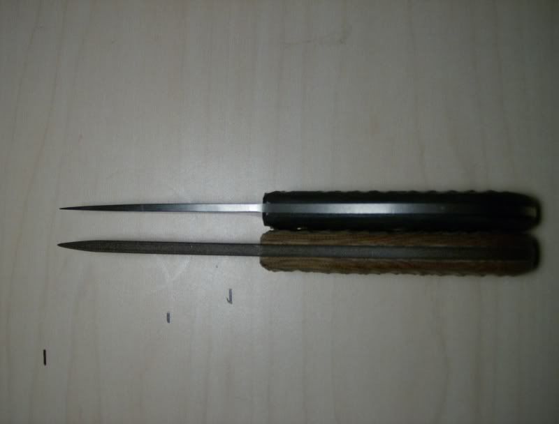

Okay, here you go:
The BAD is the only knife from Busse I've ever had any protective thoughts for - in terms of the tip. The MAD is just stupid stout. Look how far down the spine it stays full thickness.
So as an EDC knife, the BAD is one of the all-time greats. If you're looking for more of a sharpened EDC piton, the the MAD would be hard to beat.
The BAD is like a heavy-duty Dozier. The MAD is a pocket-sized destruction tool. They are nearly polar opposites.

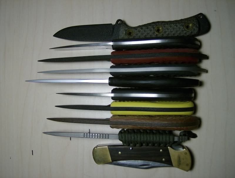

Here's one more spine reference shot, while I have the camera out:
110, Strider hollow SA, MAD, SAR Warden, BT Warden, MD Pack Rat, SE LMS, 0.20 MS, BAD, old-wave LMS.
